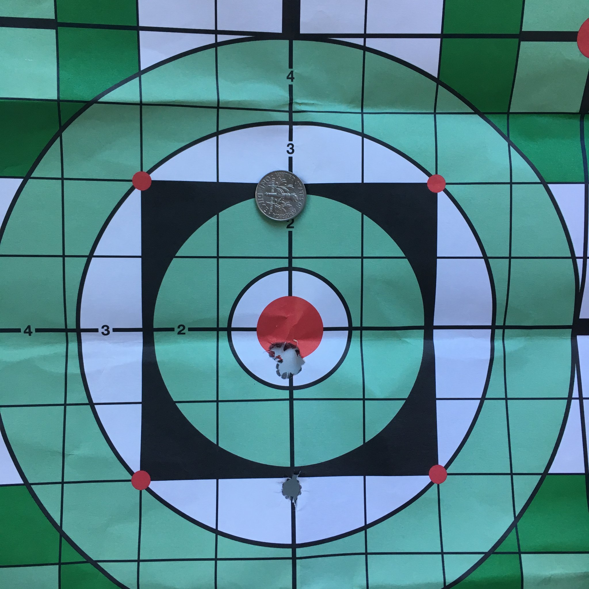

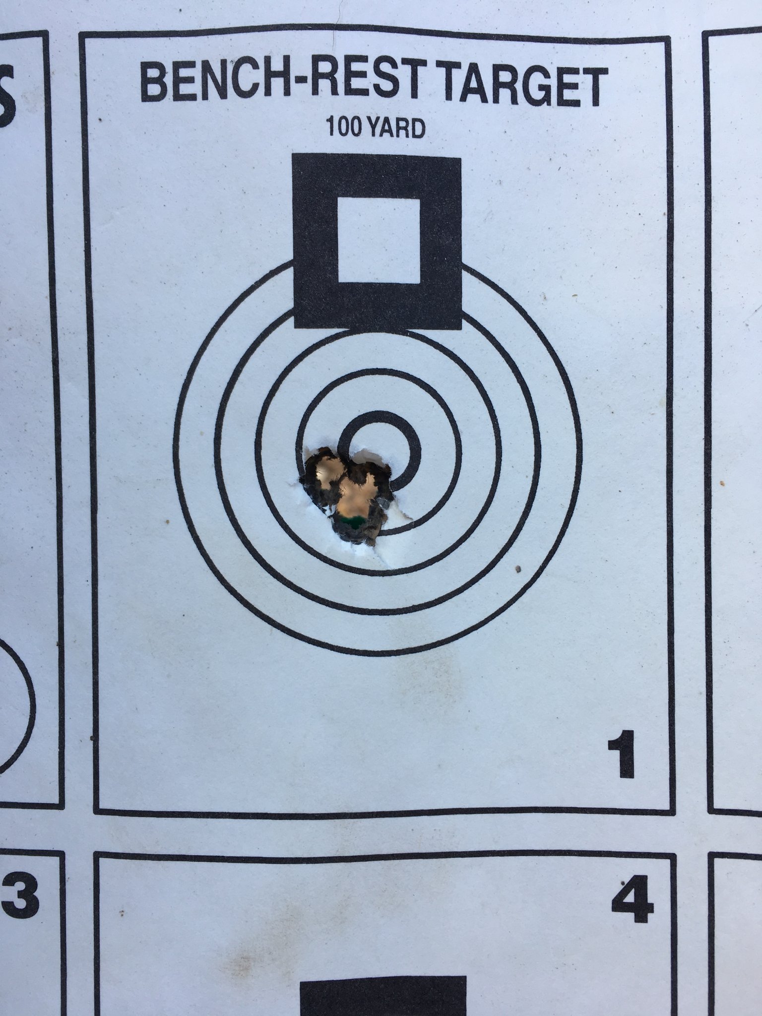

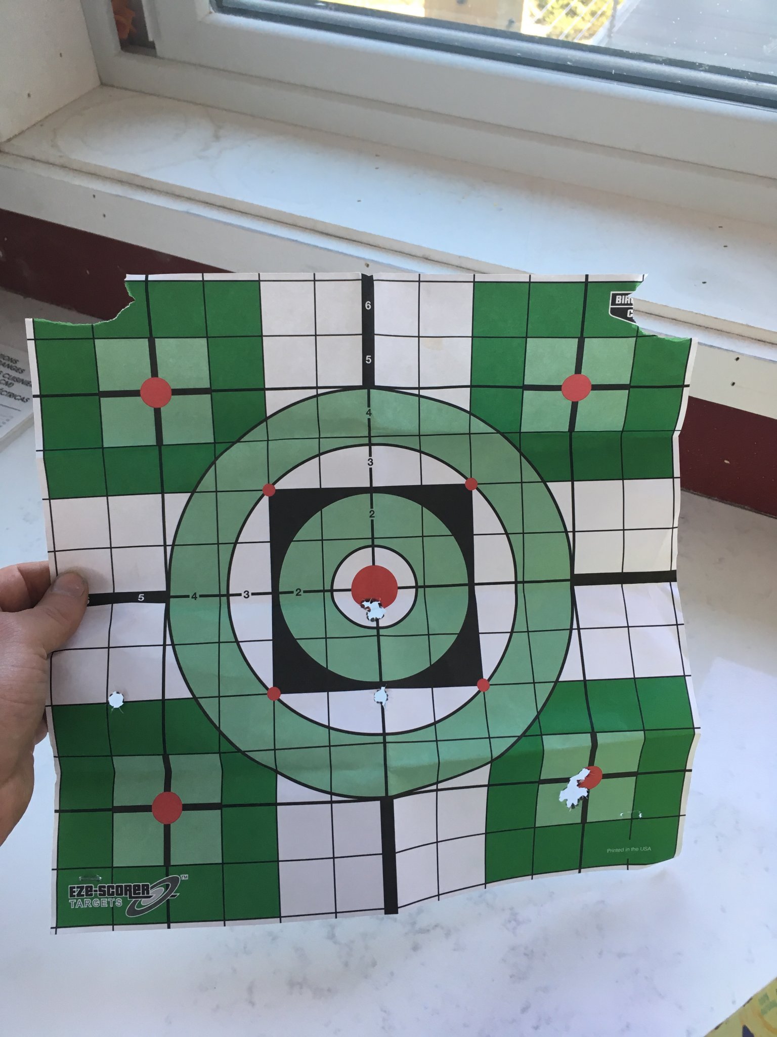

    So I zeroed my rifle at a 100 r700 .308 federal gm Berger 185gr. Thursday
    7040838
    7040839
    7040840
    To me that looks pretty good especially in regards to elevation.
    Well I fire a 100yard shot for zero at the match same at the match location and it was an inch high( approx the bottom side of the square in he pic) I happened to break the shot at the same time I got hit in the face with brake blast and figured screw it was great Thursday. This was a big mistake.

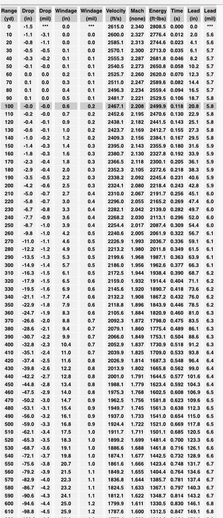

    Previously I have shot at 300 ,380, and 500 yards. I had my 300yard drop was 1.3-1.5 Mils
    And 500 was 3.2-3.5mils on different occasions.

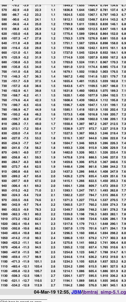

    So I based a jbm drop chart on that with a velocity of 2620.

    So I dial 1.4 for 300 and miss, several Wtf!
    0.4 high at 200 and 300
    0.6 mils high at 1000.
    Zeroed again at lunch and see oh my 100 yard zero is high. I wish I remembered exactly how to reset my zero stop(idiot),
    But I did remember how to use the zero offset in the calc. And what do you know everything from the first half of the day made sense. And I actually hit some targets.

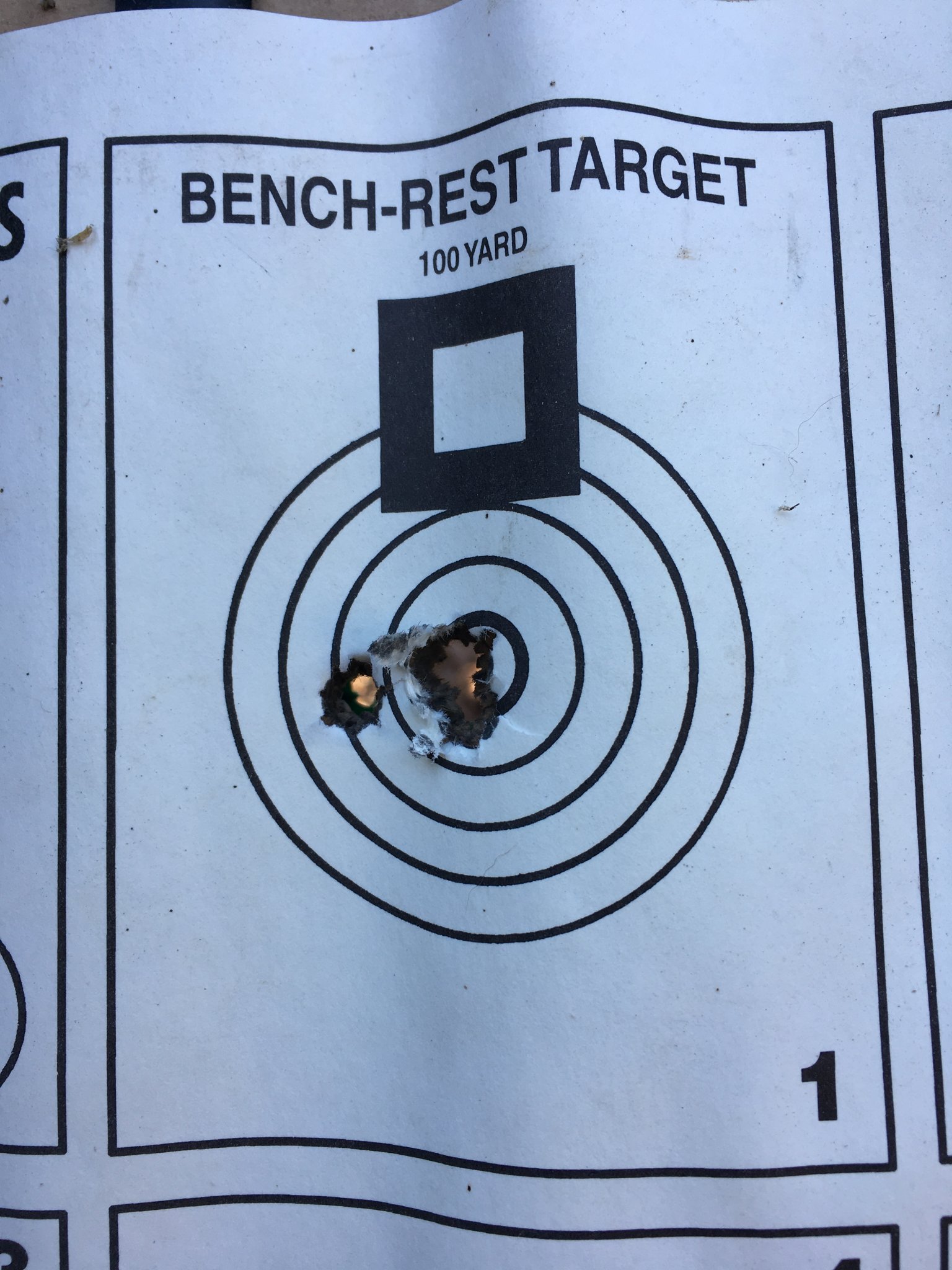

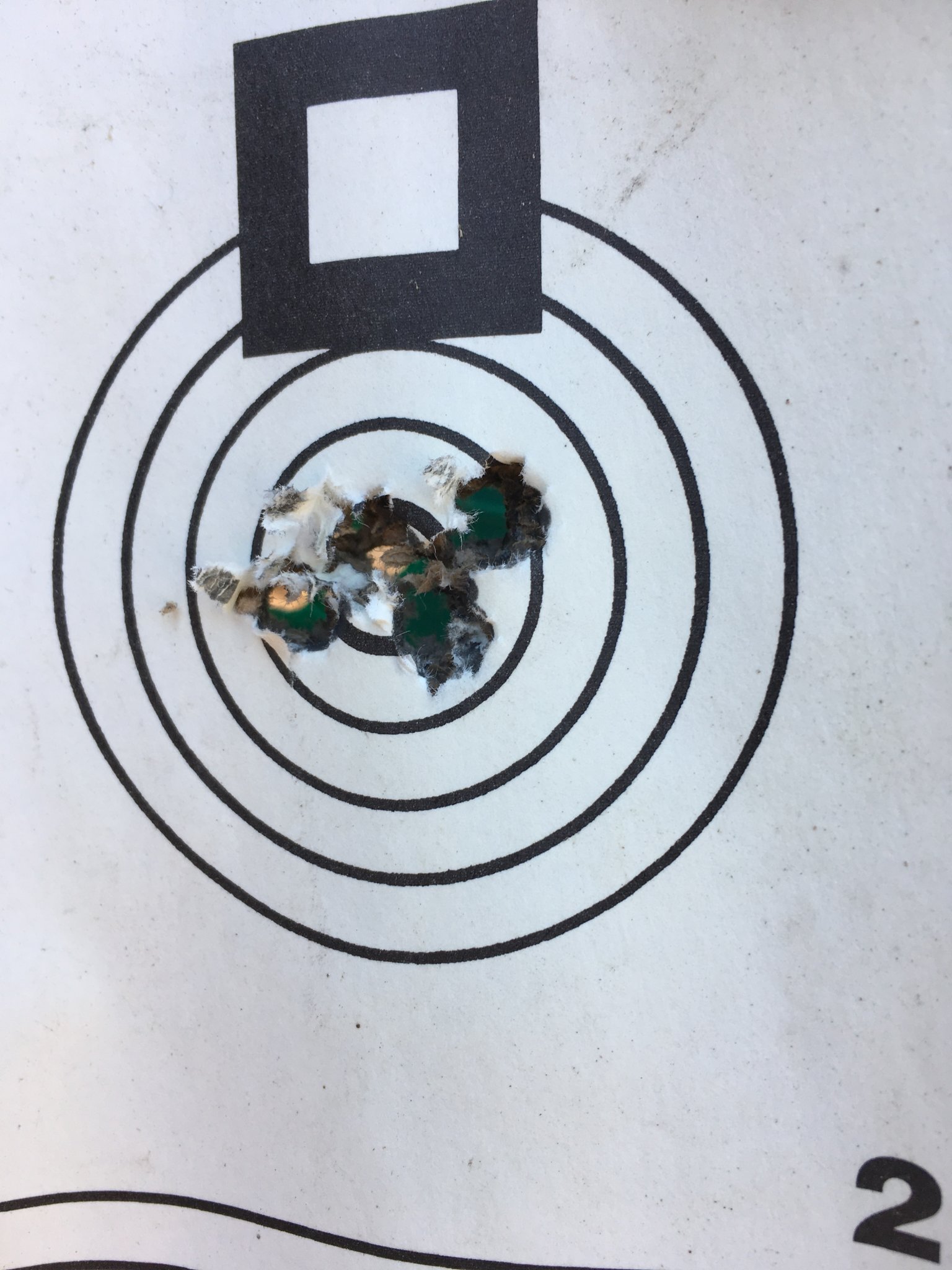

    Action screws were only finger tight. I cleaned them off with acetone, removed some bedding from the barrel channel for 4 bills of clearance, and reinstalled everything. Tightened screws finger tight, banged the butt on the ground several times and worked them up to 65in/lbs. And made sure the internal mag box wasn’t compressed (floorplate)
    Some pistol parts came in the mail so I’m going to wait till tomorrow for the range. Hopefully with a good groups and some pics.
    7043507
    12shots total. 2 groups with a correction and 2 shots fn with zero stop. Center group was last.
    7043510
