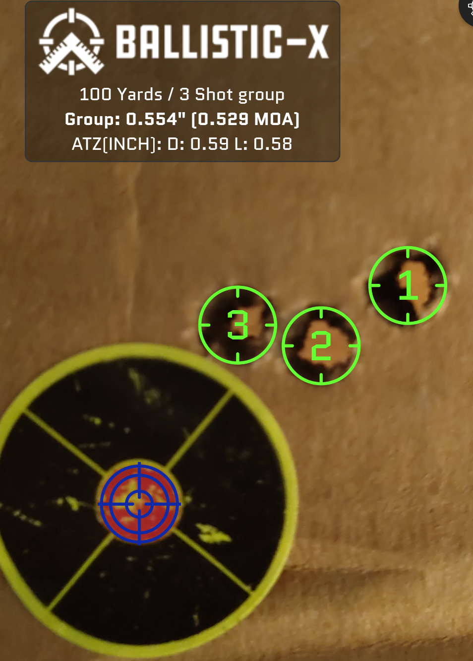

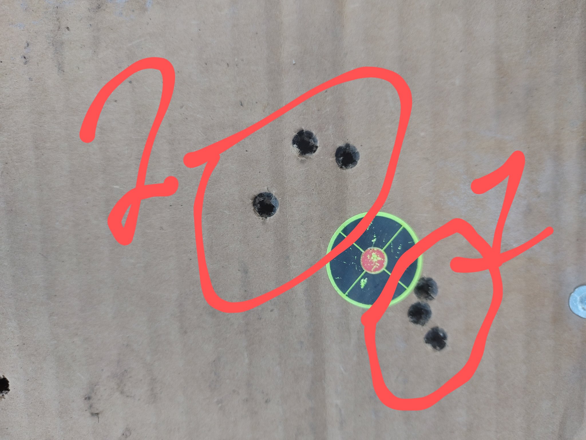

    Went out and shot today. Those rounds with that neck tension did alright. Only did 2 different charges. Used H335 at 27.0 and 27.2 grains. With 120 gr eldM. Either load will suffice for this coming week, until I get a mandrel for it.View attachment 7952808
