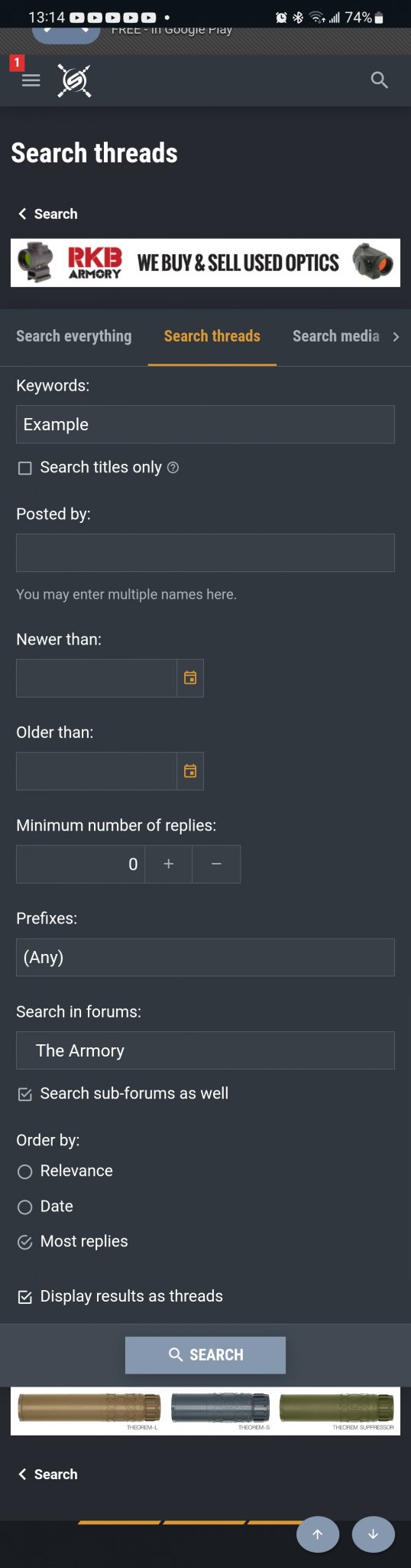

For phone searching try this setup.
Biggest issue is not un checking all forums under Search in Forums. Sorting by replies is sometimes useful but not always. Display as threads cuts out multiple posts from the same thread.
Reactions: Bobalos
