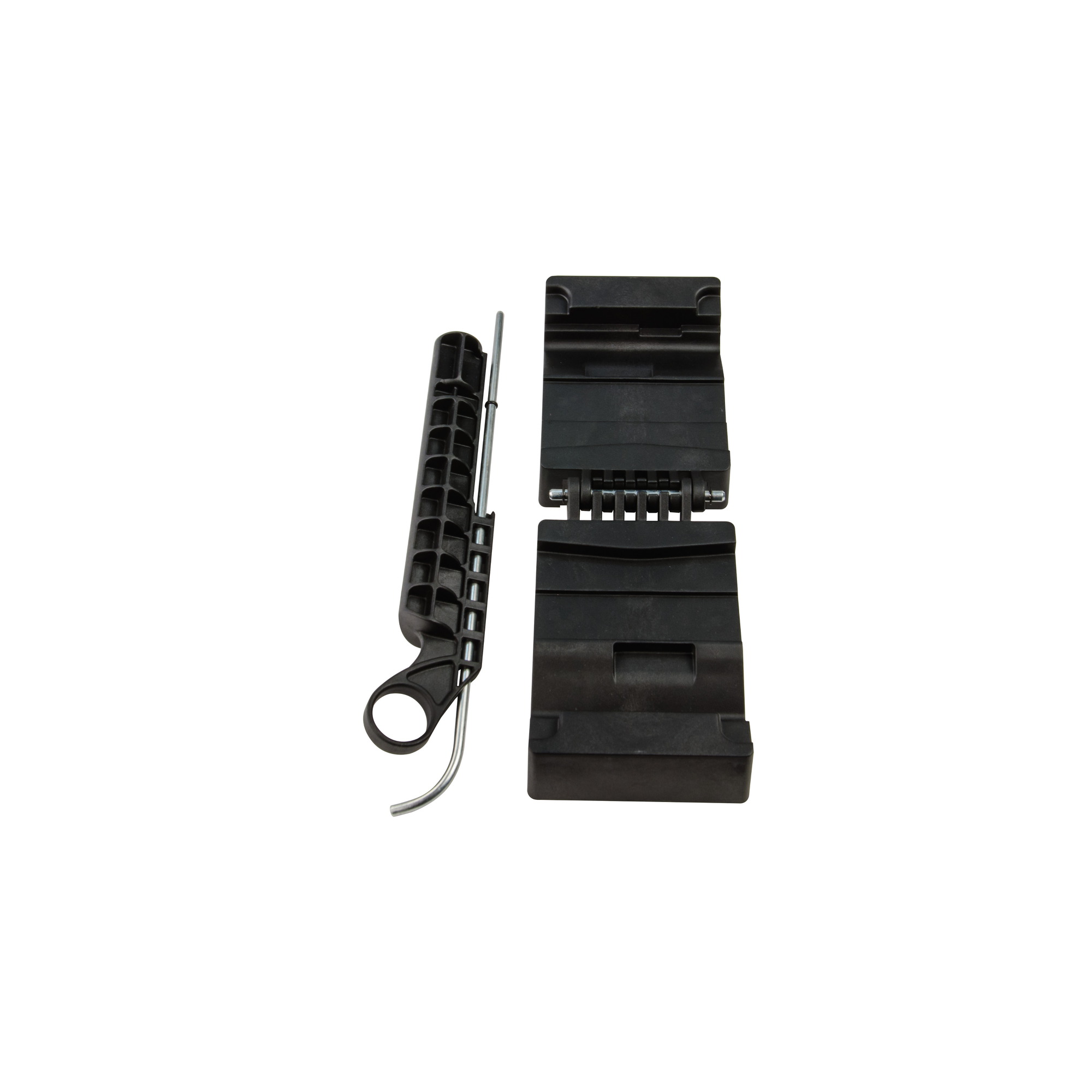

Thank you for the feedback. I did order the magpul armorers wrench. Can you use the reaction rods to install and uninstall muzzle devices? I see mixed feedback on this with some saying it is fine and others saying you need a barrel vise clamp. Which is correct as i don't want the potential for damage? I have leather soft jaw inserts for my vice could use as well I guess.
Is a geissele reaction block better than standard magwell vise blocks? I don't mind paying extra for the tool but I would prefer there be value for the price difference.

Reaction rods or similar are great for installing barrels as well as muzzle devices. An inch pound torque wrench is in valuable. A vise block to hold an upper is nice for cleaning as well as a bore guide. The real avid block is acceptable for removing the ejector as well as other pin installation like front sight and a couple other upper assembly tasks.
Several years ago I printed the Brownells M16 armorers kit inventory. I bought the specialty tools from Brownells and the rest are local. Anywhere from Craftsman to Harbor Freight, a lot I already had.
You stated you have punches but do you have roll pin punches? Regular punches will get it done but I have found that a good set of actual roll pin punches save a lot of time and cussing. Especially the starter punches. Also a magpul BEV block is nice to have for the vice as it can hold an upper or lower during assembly. Also the delrin/brass hammer is nice so you don’t ding up the finish on all of the shiny new parts. Really doesn’t take a lot of tools to build these things, my advice would be to build one and see what you think you need and what you really don’t.
