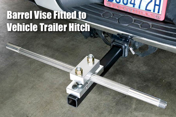

Why does everyone have the need to change barrels in 2.5 seconds? I always laugh at these threads where guys have to have it FAST! You go Ricky Bobby. Lol
And most all of the custom actions have shouldered prefit barrels that you just screw in and headspace is set already in the chambering. No need for go/no go gauges like if using a nut.
On the go!
