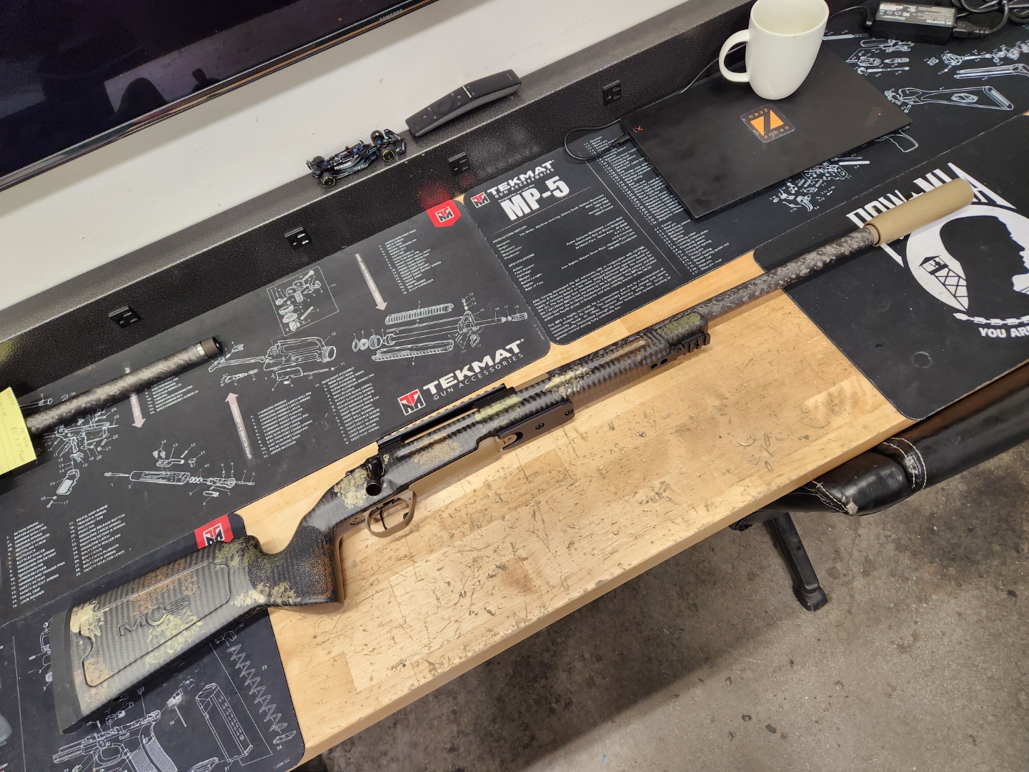

Can you post the build specs?
I’d do the zco 4-20. It’s what I’m planning to get for my 300 prc hunting rifle.
It’s a Defiance Anti action with a Proof sendero 20” barrel in a manners pro hunter stock. The suppressor is a TBAC Ultra 5. A TriggerTech trigger rounds it out. It should be sitting right around 9# all in ready to hunt.
Keep in mind the ZCO 4-20 still weighs 37 ounces and it is HUGE as a result of the 36mm tube. Based on my brief time handling the 5-27 they are amazing scopes though. I hate that it didn’t work for my application.
I just finished a similar rifle 22” proof carbon sendero. ARC mausingfield. Tt trigger. Manners LRH. Leupold Mk6 is currently on it. Ultra 7. 9.4 lbs on the bathroom scale.
Headed to shoot it right now I don’t think a little added weight would be a bad thing. I carried the same rifle hunting with a steel barrel at 14 lbs. mountains of az
