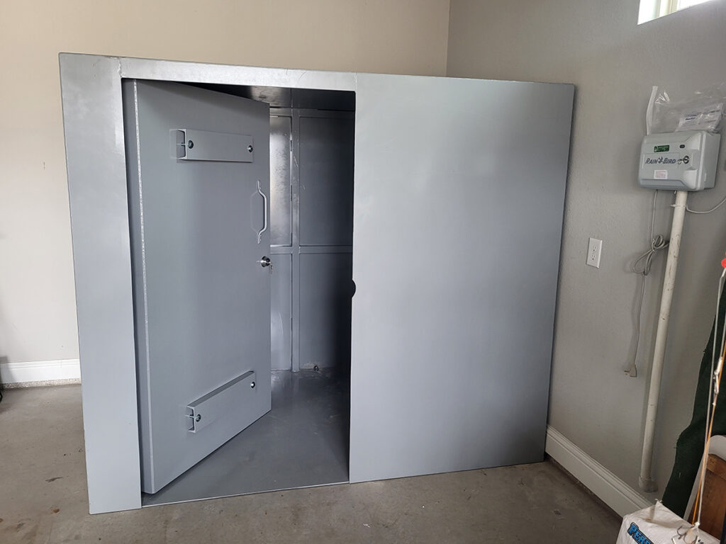

    This is the type of steel shelter that I seen in the DFW area.
    I wouldnt trust that.
