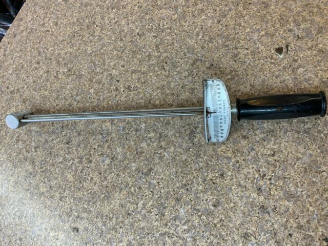

I use an old one from the 70s like this
But I also just dont use one more often than not now. Just make it good and tight until you go "ummph" and itll stay.
Edit: Ive found my grunt level like that is around 80 ft/lbs when using a foot long wrench/lever. With the half foot longer torque wrench its more like 100 when I grunt. So a good "ummph" will be fine in either case.

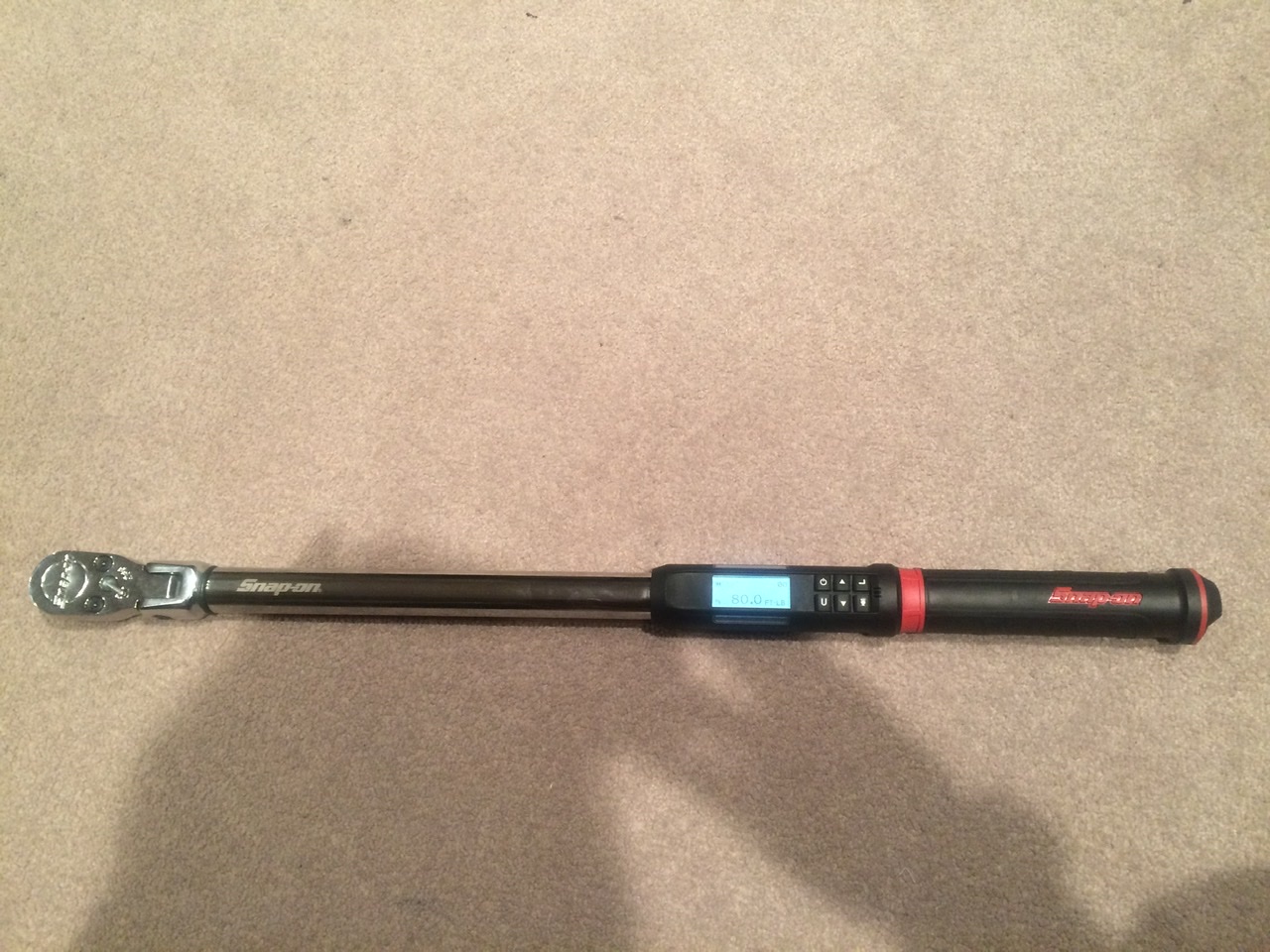

I use my Snap-on digital torque wrench and a SAC barrel vise, so I can test torque in 1ft/lb increments for best accuracy.

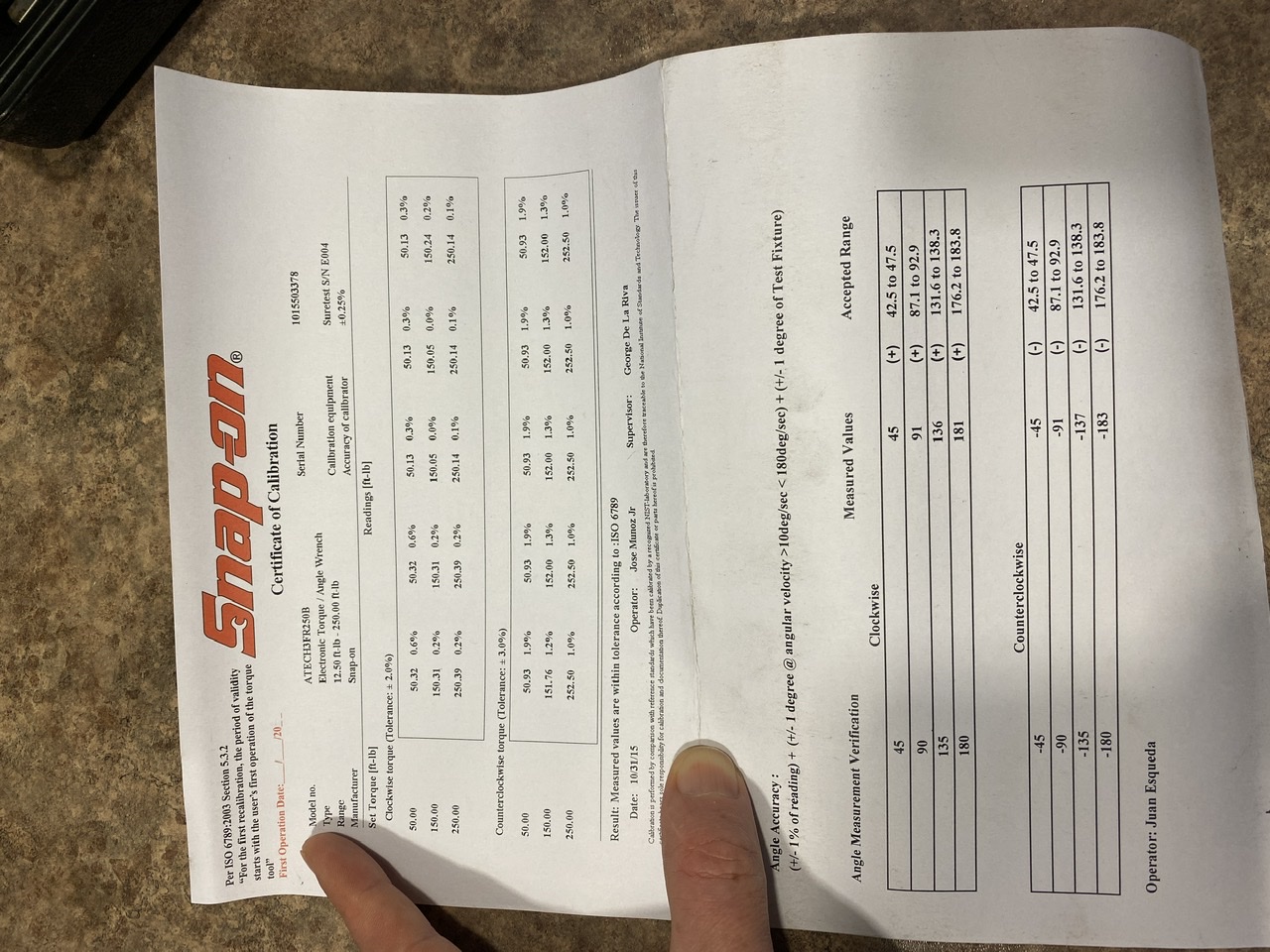

So it's initial calibration from snap on, its accurate to +/- 2%.
That's reasonable.
No initial use date, no recent calibration.
It hasn't been dropped or rough handled I assume.
At 50lbs ft, going in 1lb ft increments, you could actually be torquing the exact same amount going up 1lb at a time or you could be over by 1.2lbs ft.
I think if you want to make an experiment out of it, you'd be better served with 5-10lb ft increments.
