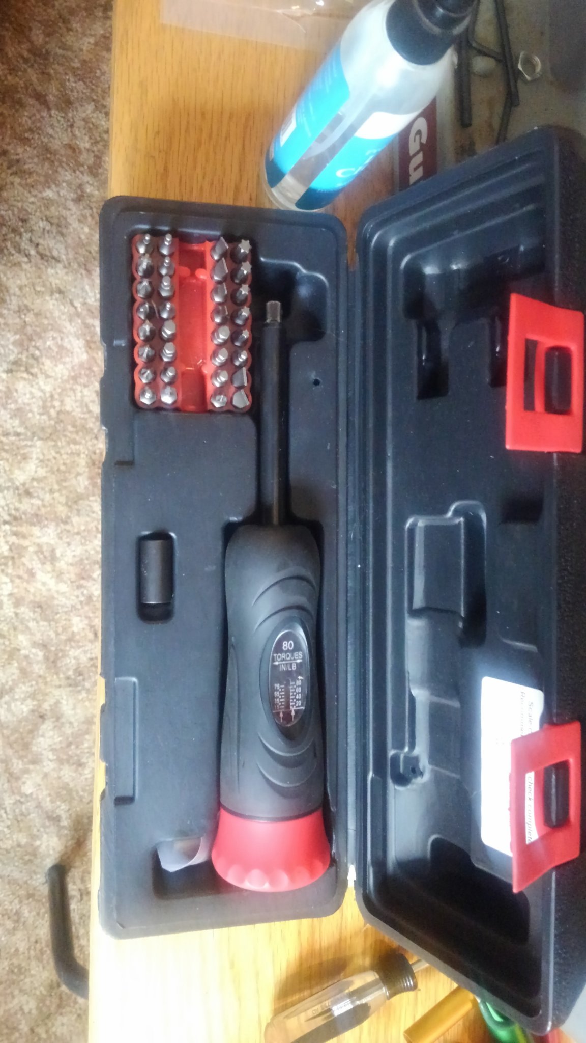

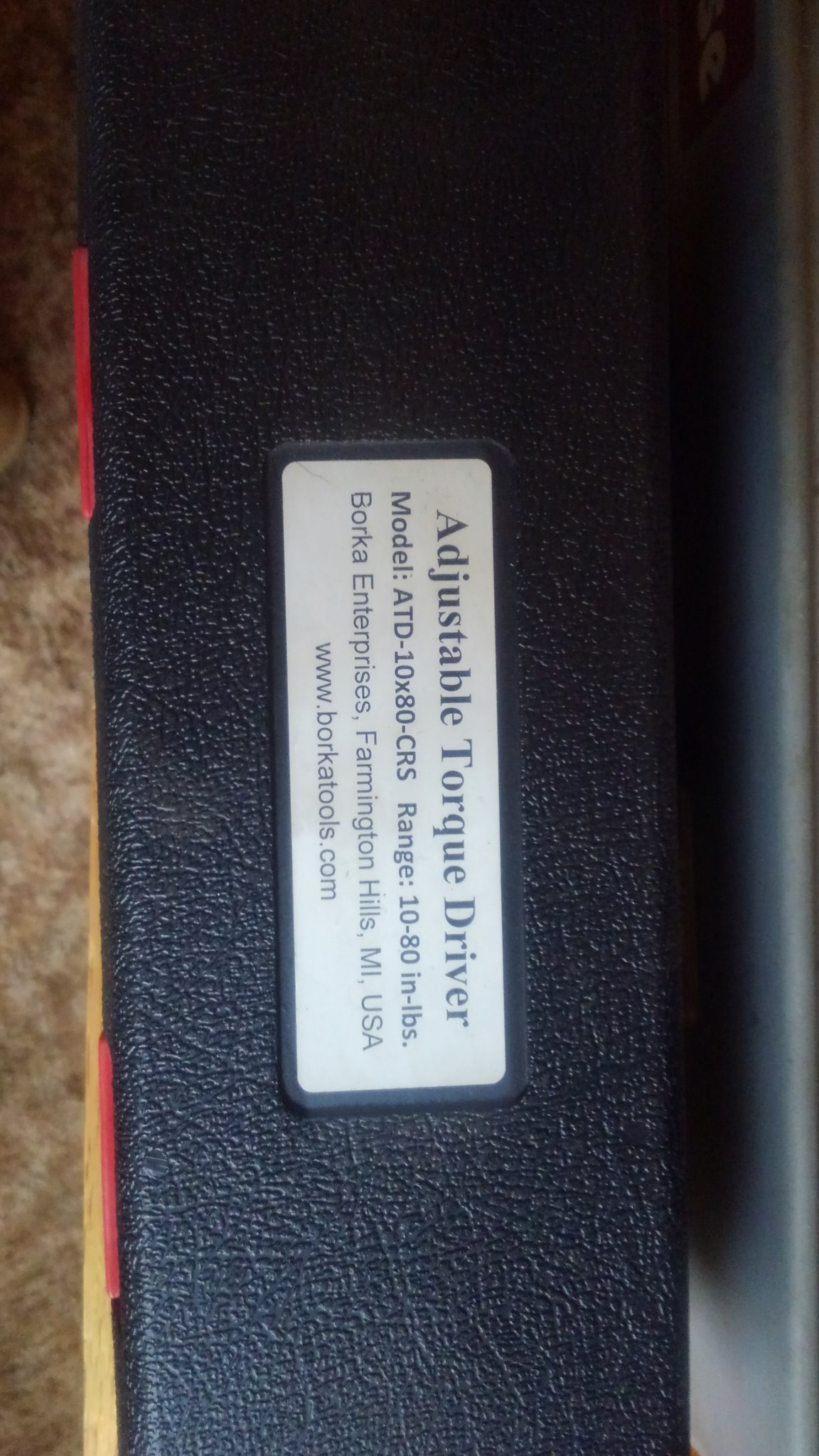

I used to use a wheeler, first the magnet holding the bit fell out then it felt like something internally galled.
I now keep the borka kit in my range bag. I’m definitely not as consistent with it as the dial or click type however when needed it does the job and is a great little compact package.
At home I use a proto dial 0-75in-lb and snap on click type 20-150in-lb for the small stuff.
For portability, as mentioned fix it sticks or the borka. Although the wheeler and most other options really are not that big.
If you search e bay you will find all kinds of options, even some that come with a certificate of calibration. It just depends what you are looking for
If you get bored, here are a ton of options
I like seekonk, I found a really good deal on a 65 in lb one on e bay also. Here are a ton of them, just need to sort through all the options.
I bought the same kit at Menards’s under the Mastercraft brand. I mean it’s identical. I have no complaints. One upgrade for any torque wrench is a dedicated set of bits for torquing only.
