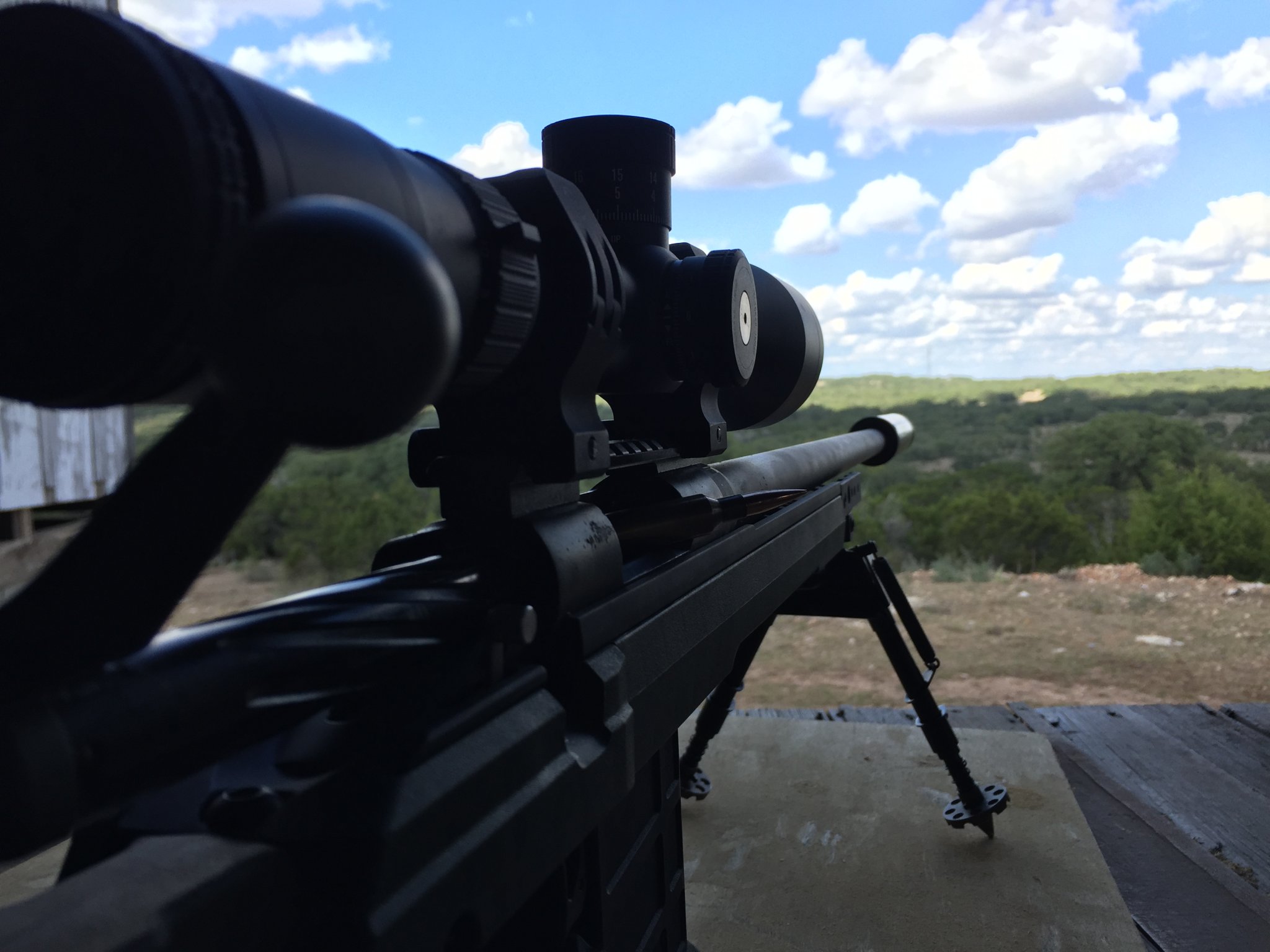

Here’s a pic of my rem700 Cronus btr in high m10s with a leupold 20moa base and a criterion varmint profile, gives me a height over bore of 2.16”
Plenty of space above the barrel but also keeps me above my can and my X-ray check piece with weibad pad is bottomed out. I wouldn’t go shorter than mediums but with the ctr stock drop they should be good.

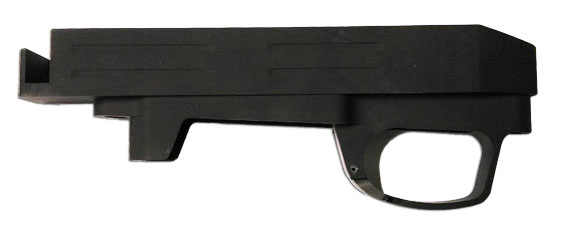

I bought this. Sooooooo now what I need to know is what is a good bottom metal that I can order for a rem 700 action that will fit a manners stock and AICS mags. Are they all kinda the same or are some better than others?
Btw... I am f***ing JACKED. Talk about a seriously BA gun... this thing is gonna look like pure sex in a manners...
Lots of options, manners can inlet the stock for whatever you choose so theres not really a "will fit a manners" issue. Now, if youre buying one thats already inletted thats a different story. Usually m5 pattern bottom metals are interchangeable.
Theres badger, surgeon, ptg, h&s, accuratemag and the list goes on and on. Mostly they are all badger m5 pattern though.
You could get a minichassis and skip picking a bottom metal all together.

I need to do more research, but I was under the assumption that a short action fit a short action chassis, long action fit a long action chassis, and a ... mini action fit a mini action chassis?
Disconnect in what I was referring to. Howa makes a mini action for example but thats not what the mini chassis is for.

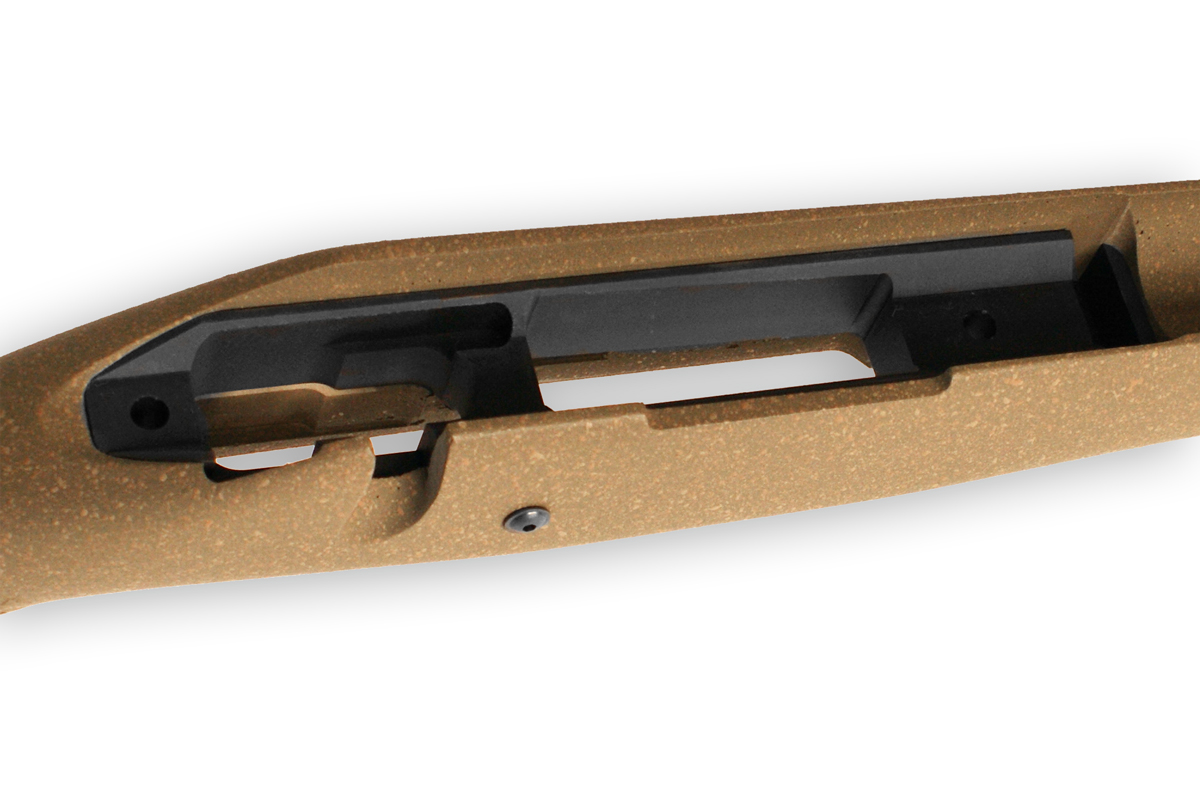

Manners makes a "mini chassis" in the it isnt an entire huge single chunk of metal the entire length of the rifle like the MPA or MDT or KRG etc. Manners has Badger make them a metal chassis that is basically only under the action and then they form their stock around it.
https://mannersstocks.com/mcs-bdl-dbm-mini-chassis/
This thing
Is embedded in this thing replacing the need for pillars, bedding in most cases and a separate bottom metal. Its all in one.
