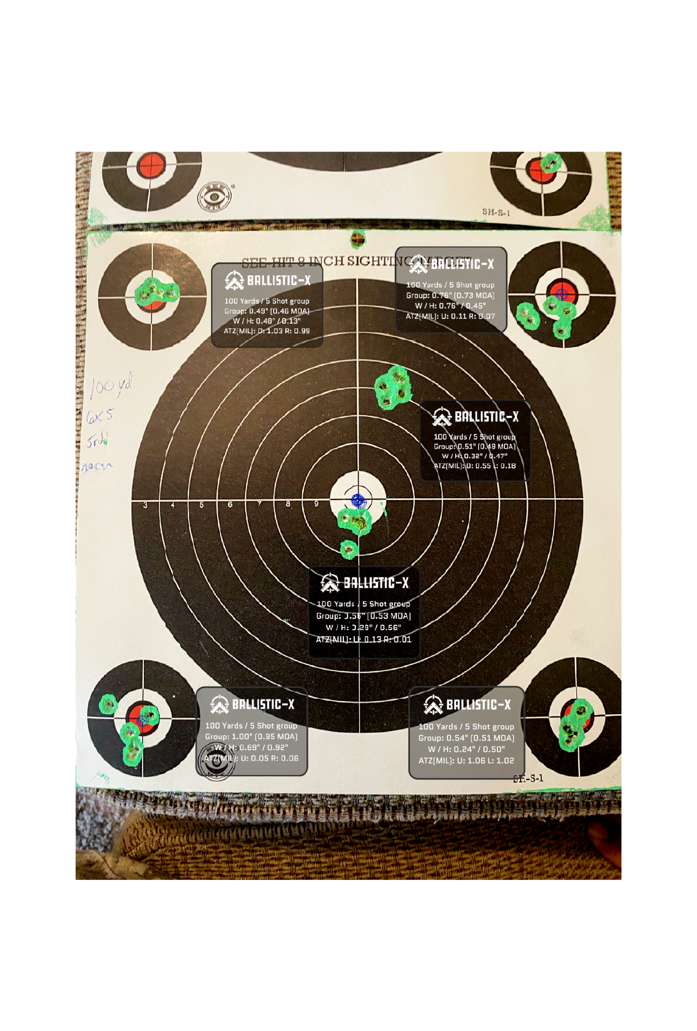

    Lapua center x in 22lr and get a vudoo v22 and be done. These are my tiny groups at 100yds with my vudoo and center x
