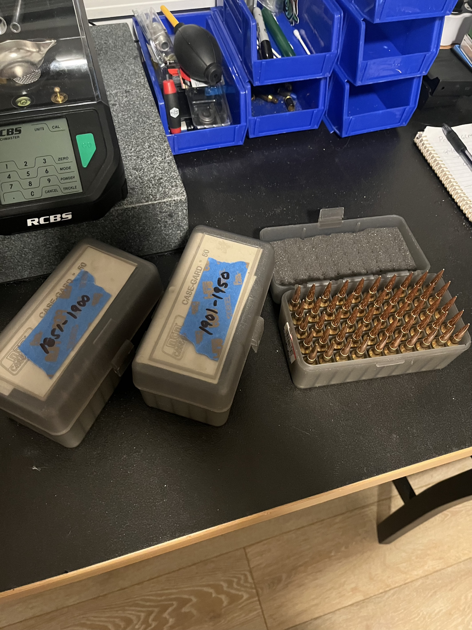

Everything is logged into a data book I keep for each rifle but for quick reference I use the labels that come with the plastic boxes and just mark through the number along the bottom.

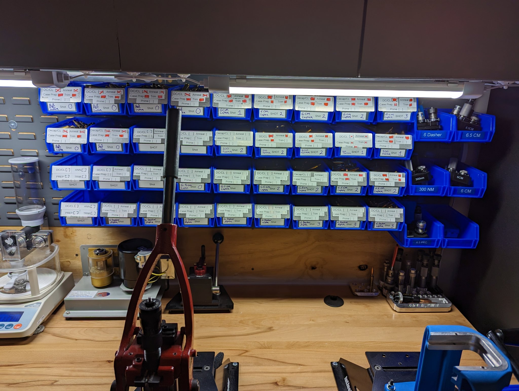

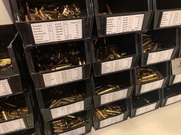

I made these tags for my Akro-bins and check off activities until the brass is ready to shoot. I usually have 2-to-3 generations of firings, and typically use the "least fired" brass for projects so that all my brass ages together and I'm never more than a firing or two out in front of my least-fired brass. It keeps me very organized.
View attachment 8068279 View attachment 8068281
I use a similar wet erase card. I don't have the times fired though. I like that and will incorporate that into my cards. Thanks!
