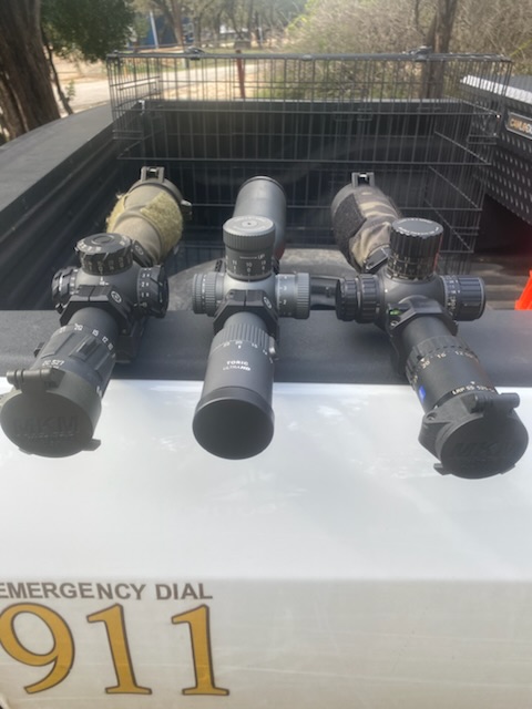

I’m currently running their spotter with the reticle. Good glass no complaints. I have the 25x on the way which I’ll be able to compare to a zeiss s5 and a zco. When I get it I’ll give u a good write up on it. Think at this point clarity between a 1500 scope and a 4000 scope is marginal. I’m more worried about field of view

After spending some time behind the tract I can honestly say I can’t see myself spending 4,000 on another scope. The Tract glass is phenomenal I honestly think it’s on par with my zeiss s5. The turrets are audible and I don’t have issues getting lost with the 10 mils a revolution. Zero stop is simple and works perfect. I like the reticle a lot, probably my favorite reticle so far. I will say the glass on the zco is better, but I think it’s marginal, I had to spend alot of time at 1000 trying to make that determination. The zco also does fill more solid, but that’s not saying the Tract isn’t. Excellent scope and for the price I don’t see a reason why I won’t buy another.
