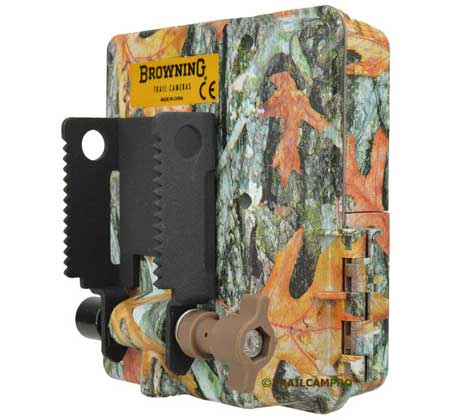

I bought two different Brownings this year and like them the best so far. I do have a couple gripes with each camera. I think one of the cameras is the Dark Ops Pro XD (https://www.trailcampro.com/collections/browning-trail-cameras/products/browning-dark-ops-pro-xd) mine does not have the mount shown in the photos. It takes great night pictures but does not trigger as frequently as any of my other cameras. The other is one of the Strike force models. It takes good night pictures and triggers more frequently than the other. My complaint about this one is with the mount that has a hinge and friction lock (shown below). the metal bracket sits flat against the tree and the camera hinges at the bottom to pivot down to get your angle. First I found to get the camera to stay tilted at your desired angle that you have to really crank down the thumbscrew. I moved this same camera to another tree later in the summer. A curious bear messed with the camera on the tree. With the thumbscrew cranked as tight as it would go all the pressure is down on the hinge. The plastic in the back of the camera broke out around the hinge. I have glued it back together and will just plan on using it like all other cameras where I'll use a stick to prop out the top of the camera to get my proper angle.
