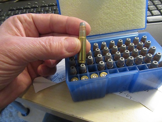

Another nice powder, and cheep bullet alternative to trigger time on 300BLK sawed-off x45 Case is just use ...
110 grain .30 Cal. Speer HP's ... over ( 4.4 grain ) Vitv N-320
'my favorite '.. I still have a few box's of HP's , but I don't know if Speer makes those carbine HP soft points anymore . But any of the 110 grn.bullets made for .30 cal. Carbine work great . I pretty sure Berry's and other's still make inexpensive .30 110's .
Great cheep trigger time. and if you .30 suppressed. the residual gas from powder burn is minute and sounds like your suppressed .22LR .
Speer still offers the round nose 110's but not the HP's which was what I was using. I'll be trying the N320 for sure. I gotta find an accurate load. My oldest grandson (10yrs) is hitting a 8 x 8 plate at 100yds with shitty inferred night scope. Another one joins the ranks.
