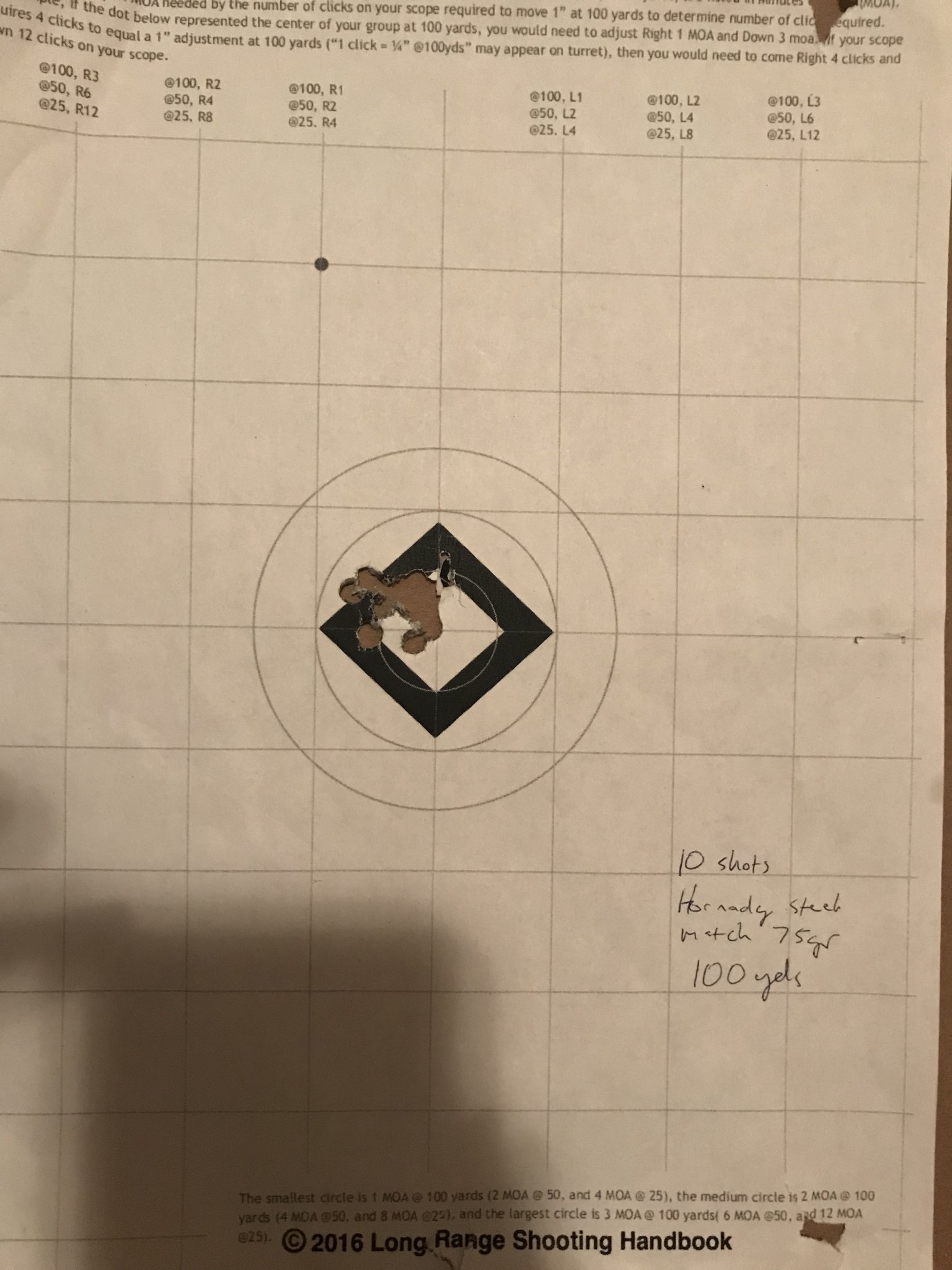

Love steel match. My new 223 Savage 12FV loves Hornady Steel Match 75gr BTHP. 10 shots, .75MOA.

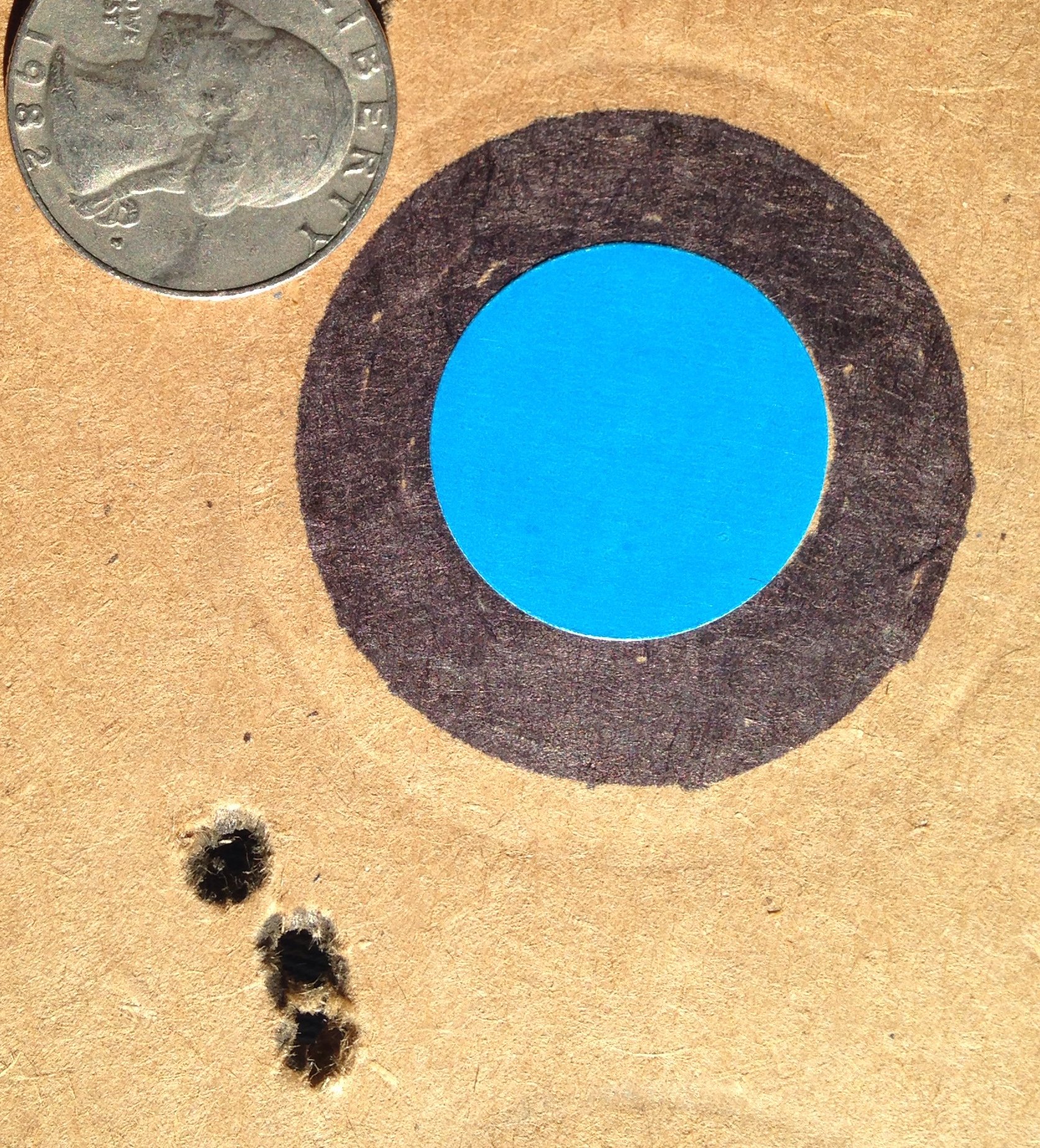

Finally got around to getting the 62 bthp load going. LC brass, Sellier & Bellot primer and a light load of BL-C (2). Throwing this powder is so much better than trickling Varget. Here's 5 @ 100. I'll post some 350 and 450 yard results later

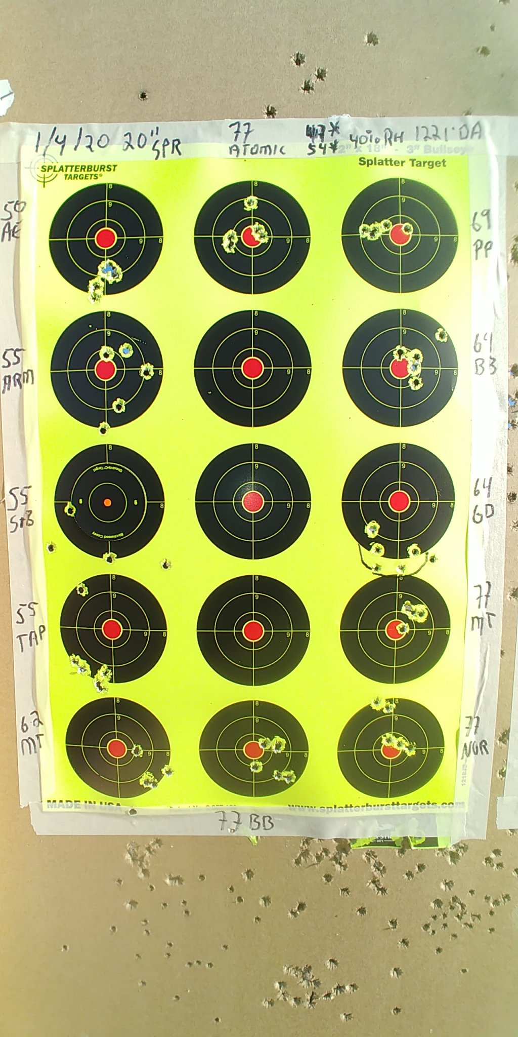

This is the results of my little test. AR15 20" Ballistic Advantage 1:7 barrel. 100 yards, 59*, 1221' DA. Off a concrete bench, little to no wind, bipod and rear bag.
As you can see, most of this ammo was .223 and shooting out of a 5.56 chamber so you can read into that as you wish. Anyway, I've had good luck with the Magtech 77g OTM in this and other rifles and it will continue to be my go-to for PRS style matches. The big surprises to me was that the S&B ammo did poorly compared to how it's shot from other guns, and that the cheap 69g Privi ammo shot almost the same as the 77g Magtech, AND that the little 50g grey tips shot well under MOA...so much for over spinning that bullet with a 1:7.
Clockwise from upper left;
American Eagle .223 50g grey tip Varmint
Atomic 77g .223 BTHP SMK
Privi Partizan 69g .223 BTHP "Match"
Buffalo Bore 69g .223 BTHP SMK
Speer 75g .223 Golddot (Wrong bullet weight written on target)
Magtech 77g 5.56 BTHP SMK
Norma 77g .223 SMK
Buffalo Bore 77g .223 BTHP SMK
Magtech 62g 5.56
Hornady 55g .223 TAP
Sellier & Bellot 55g 5.56
Armscor 55g 5.56
