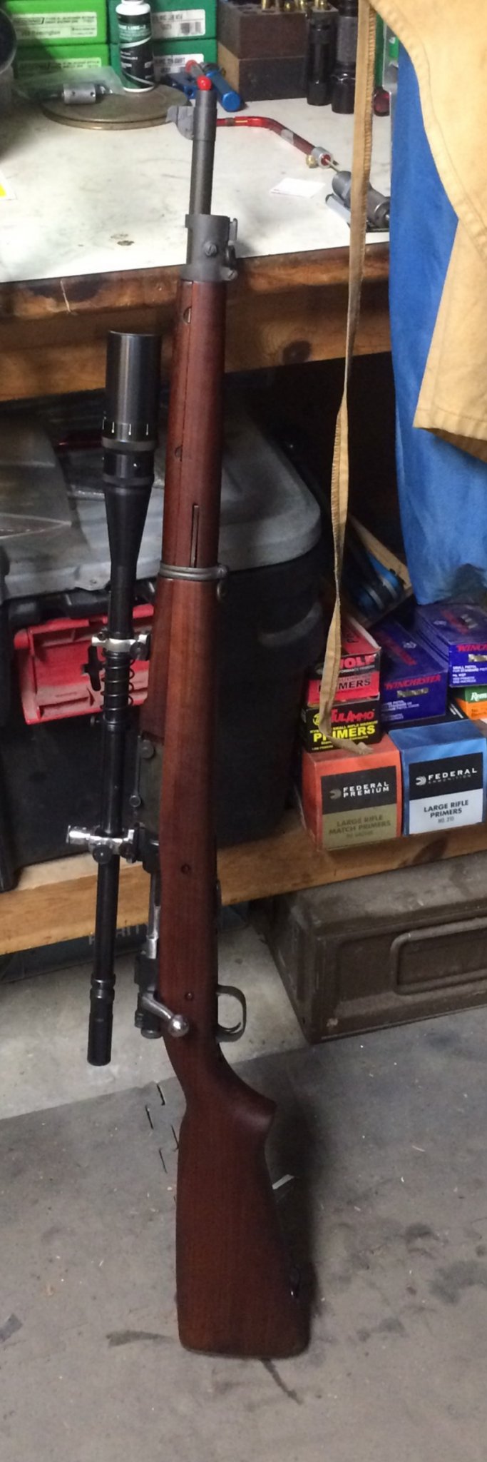

Here is what I plan on using :) Not sure what class this puts me in.
1903A1 Marine Sniper Repro in 22lr. That's a 20x Unertl 1.5" scope, and yes that's a spring.
Class was a joke, since this is 1 of 6 to be made. 100% custom fit with custom made parts to make it function with an M1922 magazine. They are bad ass little rifles. Not really good for NRL22 stuff, unless I has a custom reticle made for the drop and the 5rd mags with non-quick change would hurt.
