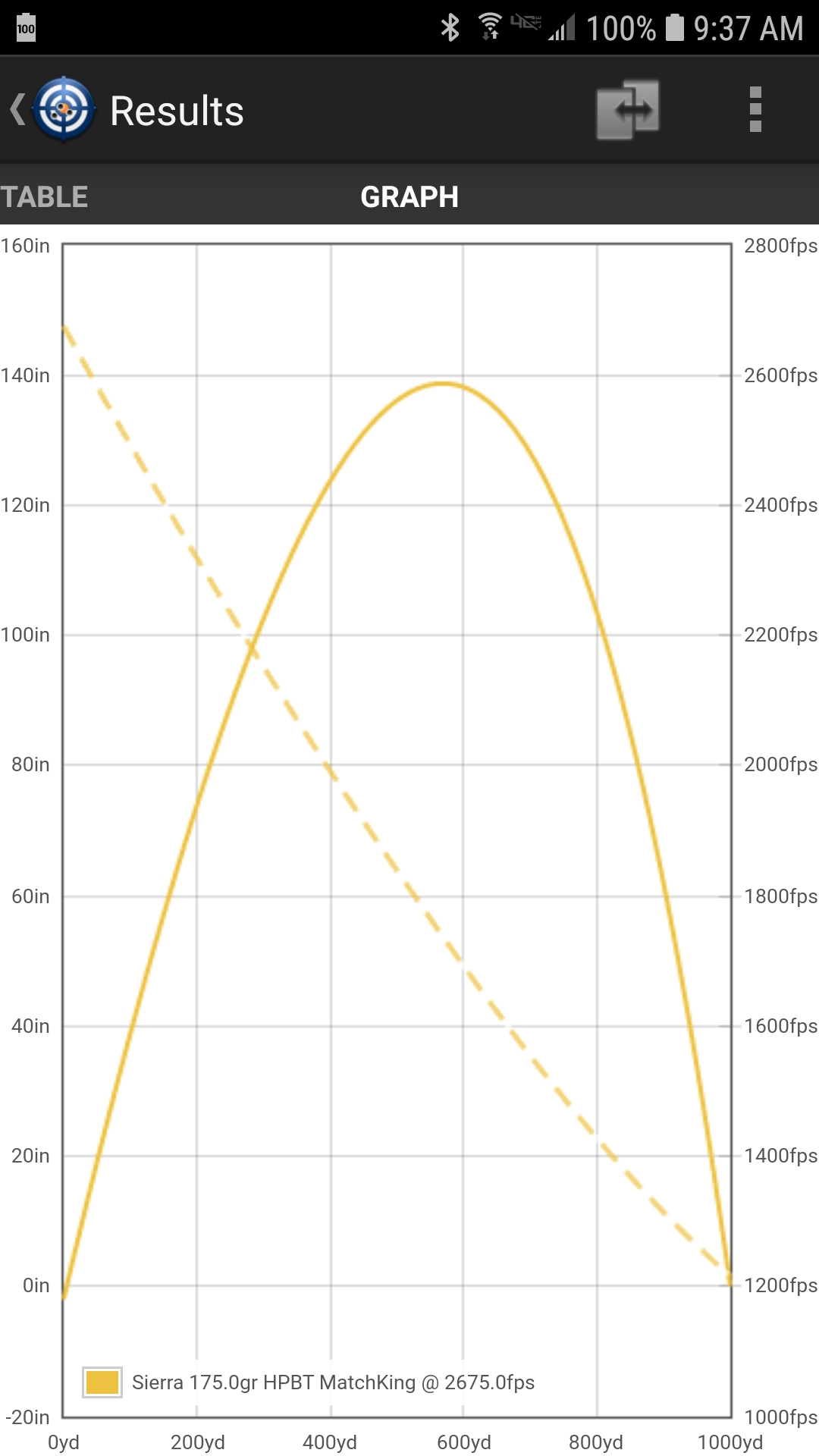

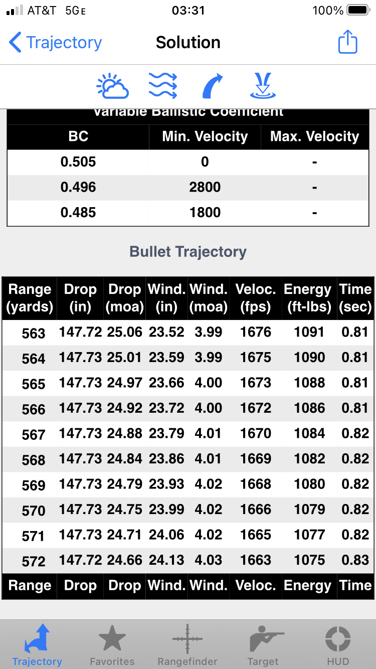

Maximum ordinate is the term you are looking for. Kestrel Elite, AB Mobile, ColdBore, FFS can all show you this.At what distance in the trajectory does the apex of the bullet flight path occur? Is there a formula to calculate this point for various ranges. Thanks
they give heightMaximum ordinate is the term you are looking for. Kestrel Elite, AB Mobile, ColdBore, FFS can all show you this.
A: 55% of the range dialed on your elevation turret.At what distance in the trajectory does the apex of the bullet flight path occur? Is there a formula to calculate this point for various ranges. Thanks
