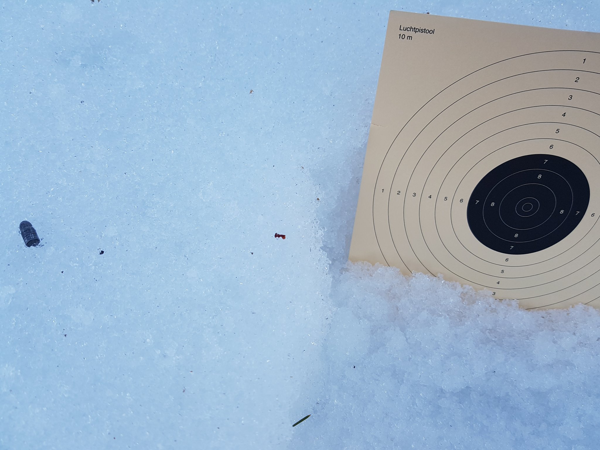

This is what I got at 380yds.
Target was in a snowhide with 3" showing of it to keep it from wind and I tried to go through the snow.
None of ~15 got through. Found several bullets on snow. I could walk on that snow though.
I dug up few bullets but I am not 100% sure all of them were noses straigth but that is how I remember it.
Also the bullets recovered from 250yds, shot into a snowmanish pile of snow were in straight.

Thanks for that close up NM.
Looking at that heel explains why those cartridges with bullet material compressed down past the crimp
produce such nasty strays compared to those with only nose damage.
If the skirt is uneven, uneven pressure release will occur on exit.
That will cause projectile tipping and unpredictable trajectories.
I think...;)

Yep. Damaged heel is 10x worse than damaged nose.
I took quite many of those with me from the snow but I cannot find better pictures of them. I might be able to track them from my led scrap. I did look each of them and ensured they looked the same.
