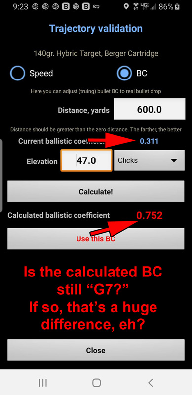

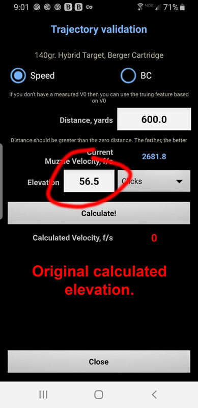

    Alrighty... another thread about Trajectory Validation. It seems that the consensus is that if you have a true MV (determined by a good chrono), that you should true the BC in the Strelok app. There is also a consensus that beyond 500 - 600 yards, you should true the BC.

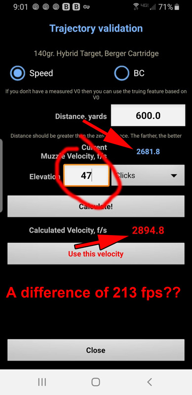

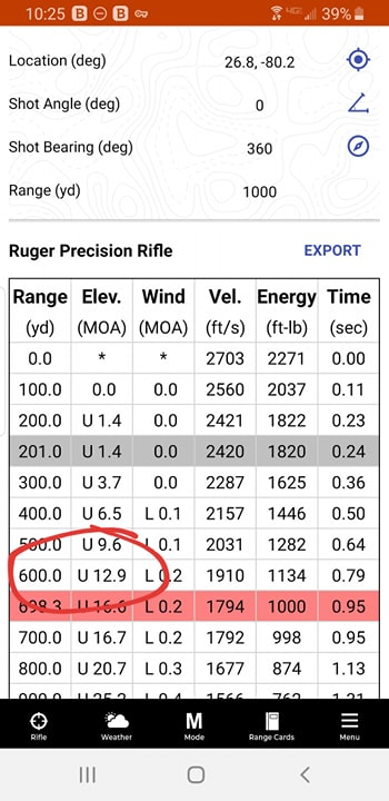

    That said... I recently used some (factory) Berger Match Target Hybrid ammo at 600 yards. Strelok told me to use 56 clicks of elevation.
    I ended up correcting to 47 clicks of elevation. That's a pretty big difference. A ~2-1/3 MOA difference. (Yes... I validated and corrected my turret click value with a tall target test a while back.)
    So, if I true MV, it's a difference of 213 fps! (The original MV I was using was calculated with a MagnetoSpeed.)
    But, if I true the BC, it goes from 0.311 (G7) to 0.752! That's a huge difference. Is the trued BC still G7? Or is it reverting back to G1 drag model?
    So, what gives? Thanks!

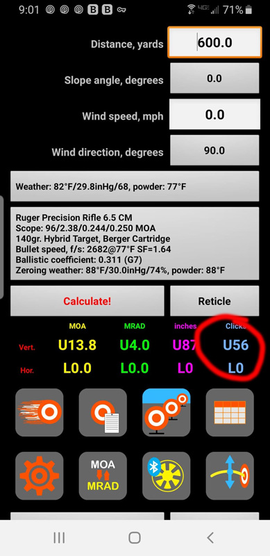

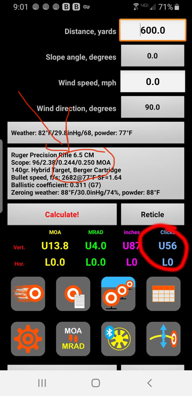

    It does appear based on your picture that your vertical dial on your scope is Set to .244 were your horizontal says .25. Am I reading that correctly?
    Yes... I did a "tall target test" elevation click value validation. Twice. The results were exactly the same to 3 decimal points. Usually, there is no need to do a click value validation on the windage (horizontal) turret.

    I don't count clicks, either. But, I used it in my description, because of the turret click value discrepancy.
    That field in Strelok can be toggled between "clicks" and "1-3/4" format. I normally use the "1-3/4" format, because it's way easier than counting clicks. :) But, I thought "clicks" would translate better on the forum post. Perhaps not. :)

    When I calculate a similar cartridge but slightly higher BC and your environmentals, I get very close to the same solution as your first one. I have almost the same drop in inches as you. Your correction makes me think something in your scope or zero is off (as LawnMM said above). Your first firing solution should be correct or very close.

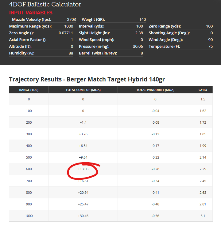

    I was curious what other calculators might come up with. So, I used the Hornady 4DOF online ballistic calculator. It came up with 13-MOA. By way of comparison, Strelok came up with 13-3/4-MOA. My actual come-up was 11-3/4-MOA.
    For the Hornady 4DOF calculator, I input the correct environmentals.
    I ran it through Ballistics ARC on my phone. It came up with 13-MOA, as well.

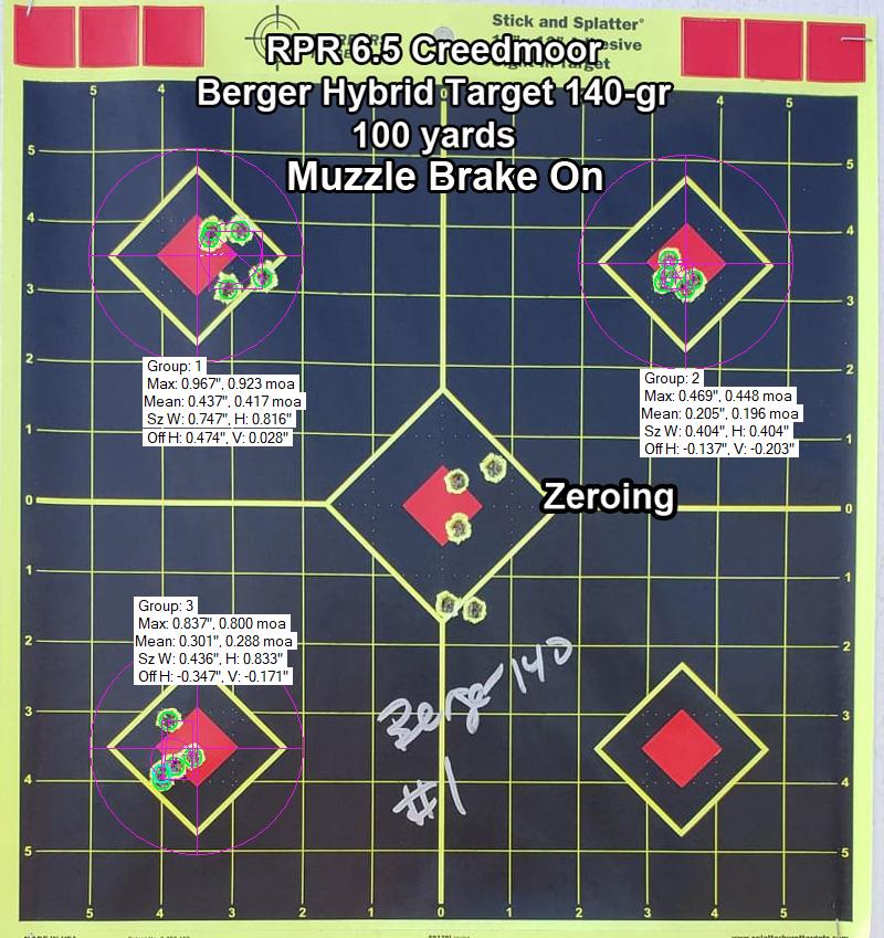

    So, I started by putting the brake ON and re-zeroing the rifle with the new Berger ammo (center bull). And, then shot a few more groups.

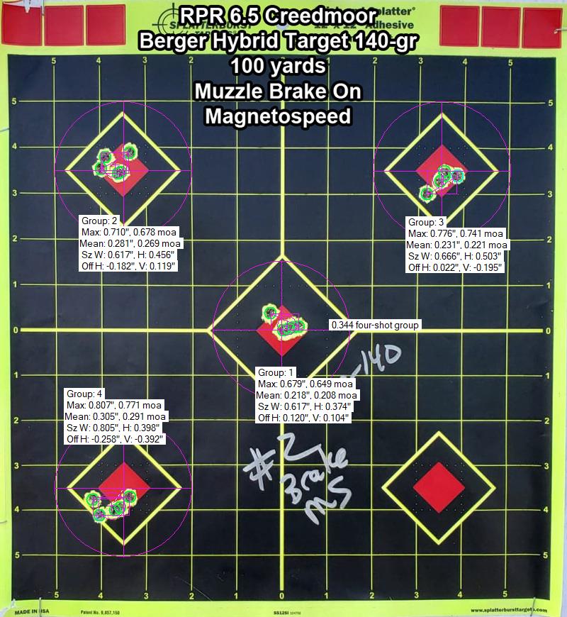

    Then, I got some new velocity data with the Magnetospeed and shot some more groups at the new zero (brake still on).

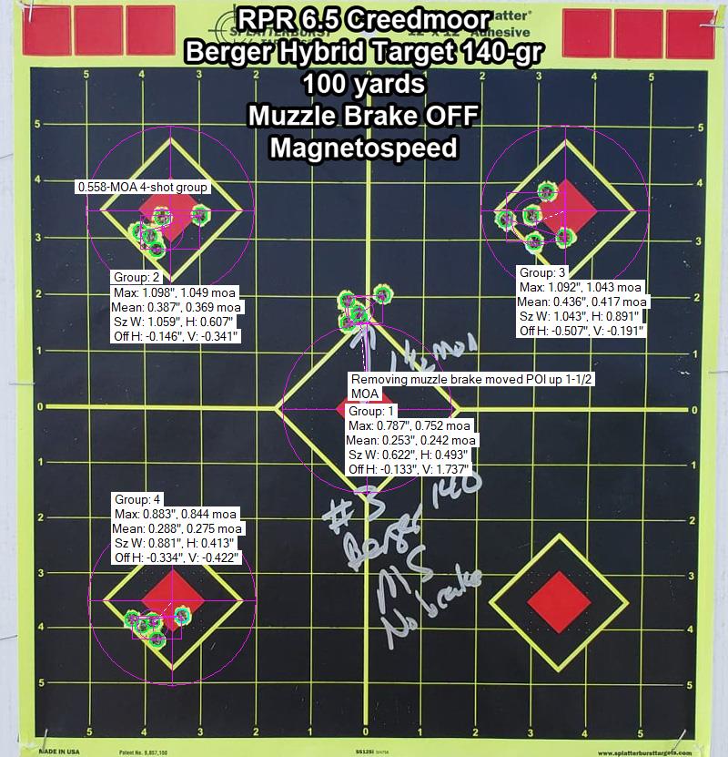

    Then I took the brake off and shot a group on the center bull. Shazam! It shot HIGH, just like it did at the 600 yard match. And, not just a little high. A lot higher! Honestly, I expected a LITTLE shift in the POI would be likely when I removed the brake at the 600 yard match. But, I didn't expect that much.

    Same principle as a barrel tuner or strapping on a magnetospeed.
    Certainly makes sense... which is why I have a pic rail mount for my Magnetospeed. :) But, for SOME reason, the notion of the brake having THAT much of an effect escaped me. ? So, feeling a bit embarrassed.

    Many times, you’ll still see some slight POI change in the opposite direction of the magnetospeed even with the pic rail.
    It’s much smaller change. But with the bayonet right under the bore that close, there is some impact shift.

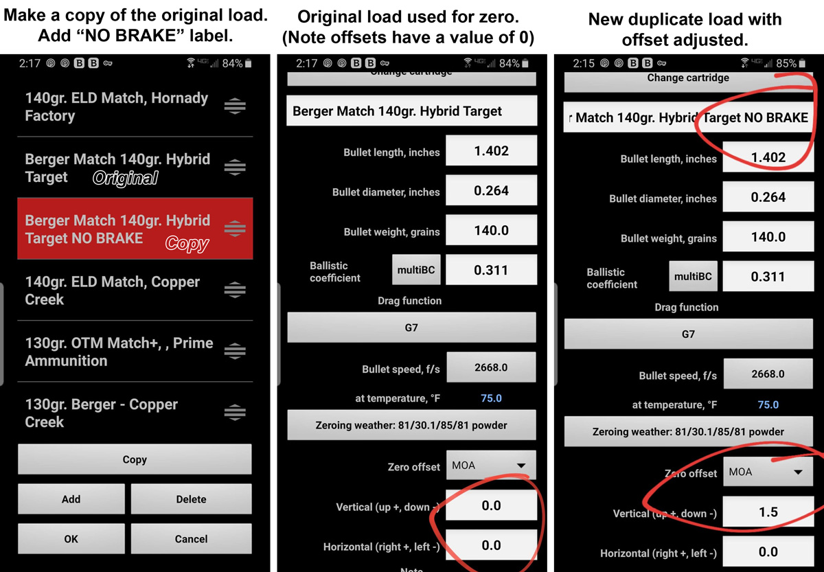

    Copy your load in Strelok and make one with MB on and one with MB off. Then you can zero with one of them and put in an offset on the other. Select appropriate load and it’ll correct it for you in the solution.
    Yep! Exactly what I did. Strelok's offset feature is pretty nifty.

    So... I'd make a duplicate of the load I used for my zero. Then add the label "No MB (muzzle brake)" and change the zero offset. That way I can just load the profile that applies (am I using the muzzle brake or not) and have my calculations work.
