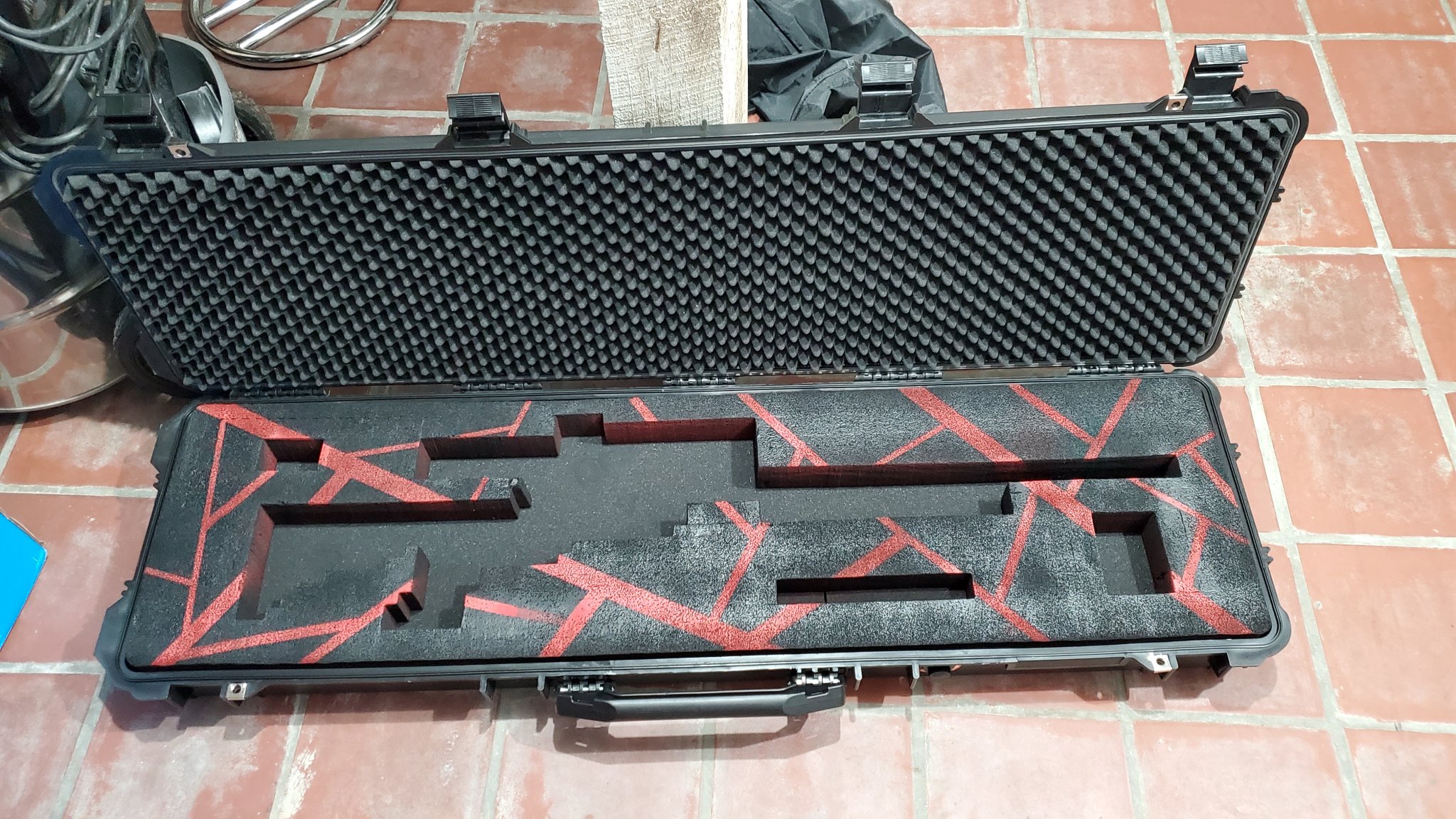

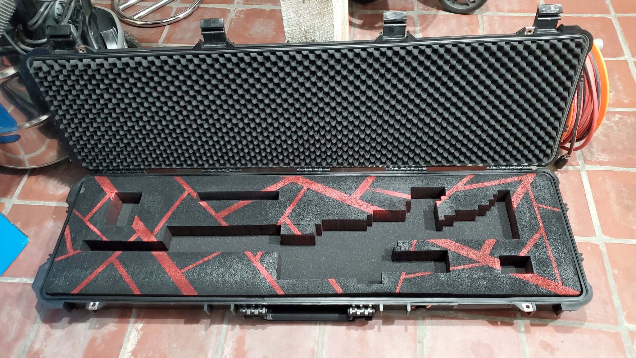

I bought a cheapy Apache case from harbor freight. The pluck n pull foam wasn't holding up, so I read that some people have success with plastidip.
5 cans later. I think it turned out nice. I am going to let it sit out for a few weeks to off gas completely. What do y'all think?
That's a great idea. When I fly I will turn it around. It pops right out. I used two cans on the bottom. A can of black base coat on the top. Then the red coat. Then a top black coat on the top. Most of it soaks into the foam, which honestly is probably good. It's much more dense now.

It is much much more sturdy. Can I pluck off a piece, probably. Is it likely to pop off through normal use. No. I had one piece get stuck to the mat I was painting on. It popped of when I lifted it. However, it was a single isolated piece with only one adjoining piece. (By the bolt) This happened early also, when I painted the bottom.
I think it will hold up okay.
dp is safe on pluck and kaizen, although it will peel off kaizen because it doesn't soak into the closed cell foam.
i have always recommended for pluck because it also keeps the foam from holding moisture.

Just the regular spray plastidip. 4 would have probably been adequate. The 5th can was just for decoration really. I ordered two cans of black and after doing one on each side decided that I needed another two cans (one for each top and bottom.) While ordering the black ones I saw a can of red and thought, cool I could do some sort of pattern. So I snagged a can of red.
Then I sprayed another whole can on the bottom. Sprayed the top red. Taped off my pattern, and then used the second can of black to fill it in. FWIW most of it does soak in. This gave 3 cans on the top, and two on the bottom.

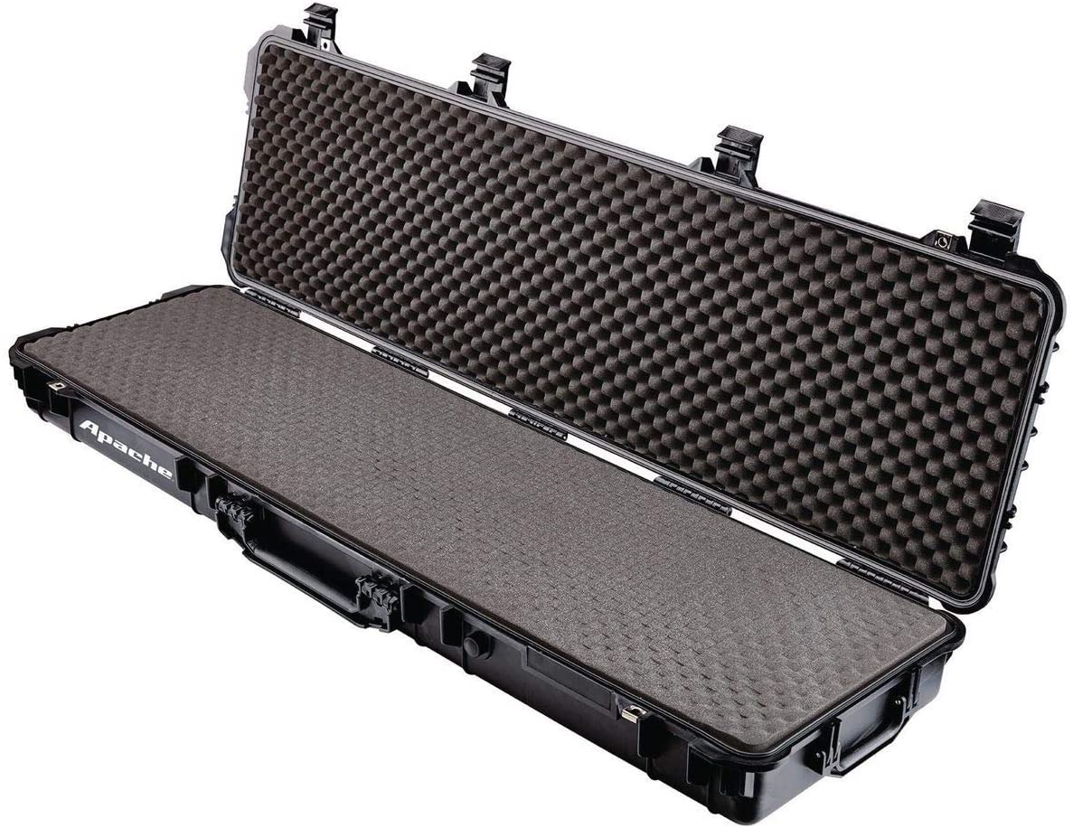

Since you are considering the case, I'll give you a brief review.
They are surprisingly nice. I got mine for under $100 on sale. The down side, the pluck and pull foam is very fragile. And simply doesn't hold up. I would budget for a custom foam insert, or attempt the plastidip method. In researching this I stumbled upon an astronomy forum, and they recommended not storing optics near plastidip bc it can cause the lenses to haze up due to out gasing. I have no idea if this is true,. But I have no intention of permanently storing my optics in this case, like they do. Short term transporting it to the range, on hunting trips, etc I doubt will be a problem.
The case plastic is thick and strong. Close to the quality of my pelicans, close but not quite as nice. For this rifle I have no major regrets or concerns other than the quality of the foam. If this works, awesome. I honestly think it is going to.
I would have zero concerns checking this case on an airline. I honestly think I could run it over with my truck and it would survive. But I am not going to test that.

Thanks for the compliaments! This was my first attempt at this. I did the lines on a whim when I saw the red plastidip while getting my second set of black.
Cutting the plastidip wouldn't be much, if any, harder than regular foam. As long as the plastidip doesn't seperated and pull off. If I change it, I will try. If it works great. Otherwise I will replace it with a professionally cut foam.

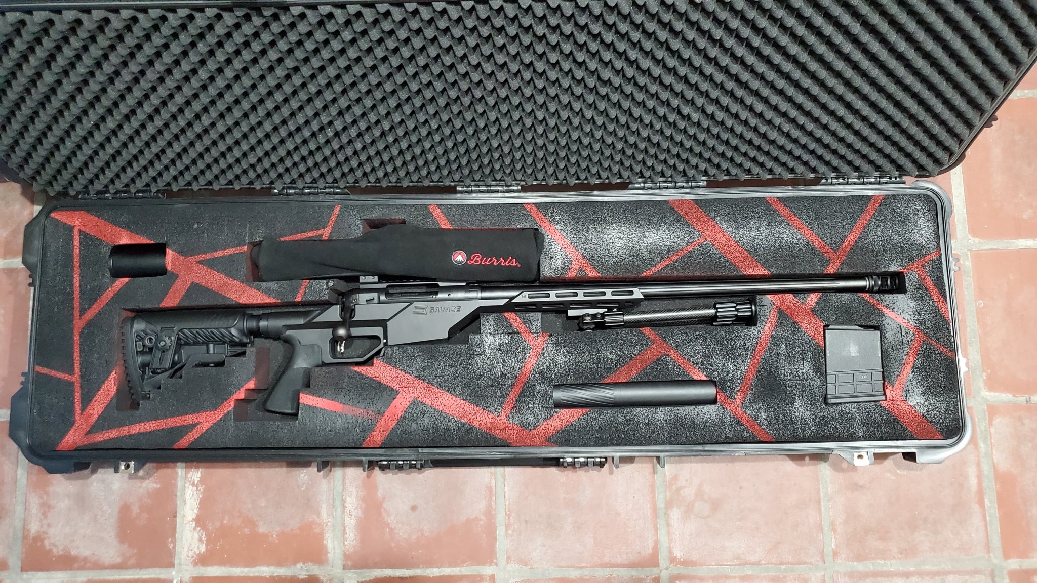

I swear, everyone works so hard to make their hard cases look cool.. THEN you guys almost always put the gun in the wrong way!!!!!
But yea, it doesn’t matter if the scope is up or down in the case.
The handles are almost always how we pick them up and set them down, if it does get handled roughly (hence the hard case) it gets dropped or set down hard opposite the handles. It's the perfect way to test your scope; a 15+ lbs rifle imparting many Gs in that 1" of foam above the turret, will be stopped hard by the ridged case. Fly enough and you might find out it really does matter.

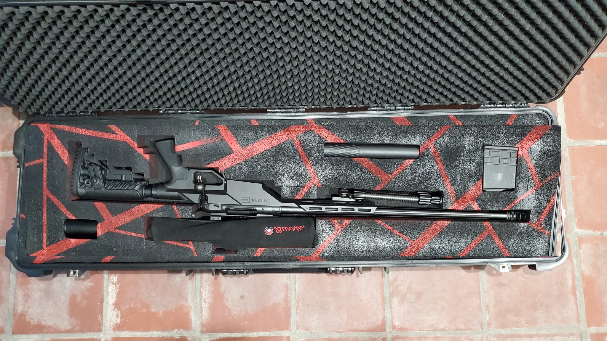

I can rotate the foam 180 degrees. It is quite literally just sitting on top of the under foam. Easy peasy. I prefer it the other way when I am using it. But will flip it when travelling with anyone else handling my stuff
I cut additional space above the scope so if the case is in a position where the rifle is upside down the scope isn't resting on the foam but rather suspended from the rifle. That said a well mounted scope shouldn't give you an issue when flying / traveling.
Can you flip it this way?
This is the way I cut mine.
Scope side will be up when carried by the handle.
Butt side down when pulled by the other handle and dragged by the wheels.
Again, I'm sure its fine the way you have it, it's just my preferred orientation.

I can rotate the foam 180 degrees. It is quite literally just sitting on top of the under foam. Easy peasy. I prefer it the other way when I am using it. But will flip it when travelling with anyone else handling my stuff View attachment 7461981

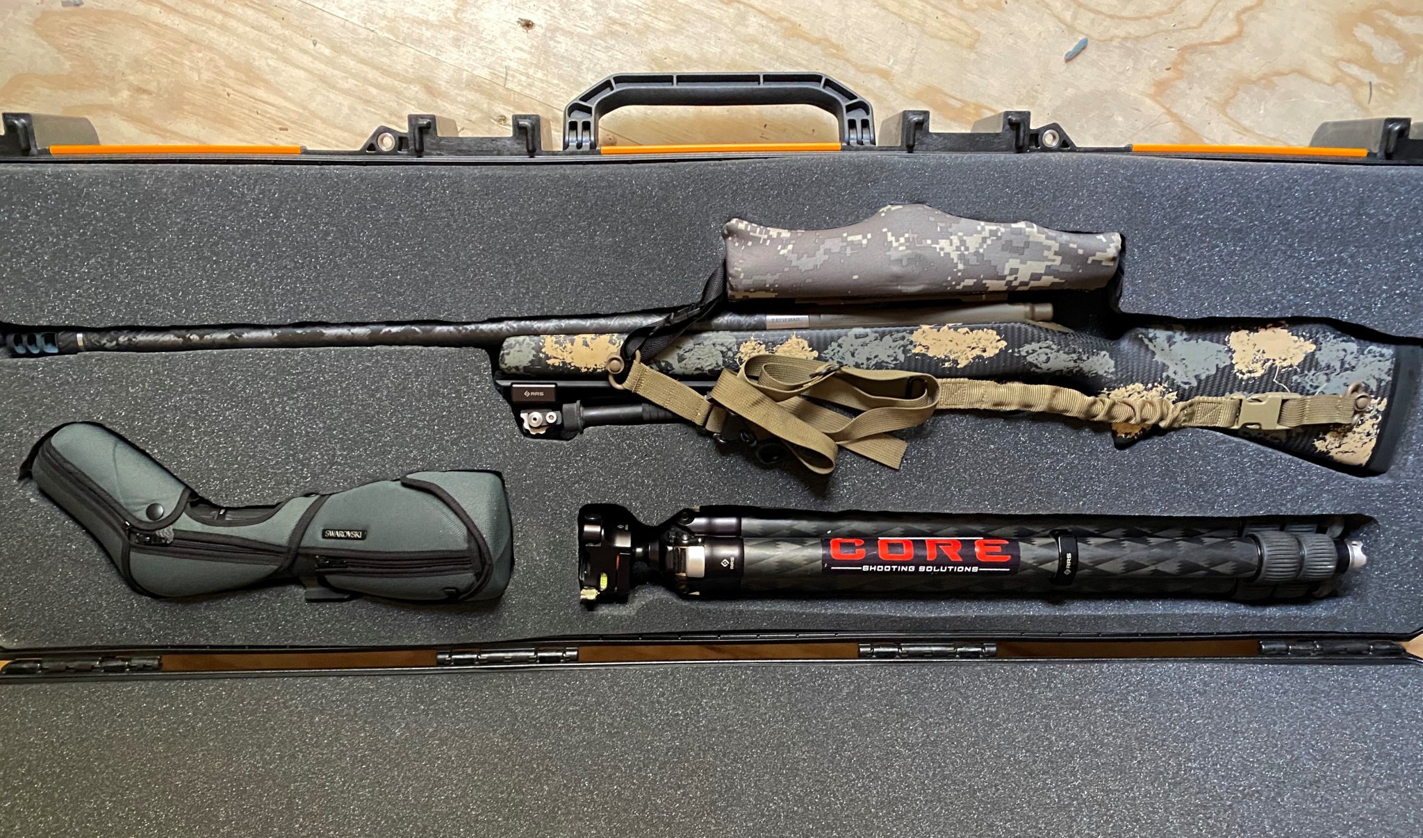

Now the barrel is face down, not as bad but not preferred. Just adding this so people think it through. Ideally, the wheels are on the buttstock side. Below is one of my hunting set-ups. Fully kitted the gun is only 10lbs (with a fully adjustable turreted FFP scope), The 85mm ATX is 4.2 lbs, and the tripod 4.4lbs. While the scope is still closer than it should be, it is a 1/3 to more than 1/2 as light as most PRS rigs. My binos 2nd RRS, and back up rifle go in another case. Leaving for an annual Elk hunt tomorrow. FWIW I don't use hard cases for my match rifles unless traveling.
As someone who designs packaging as part of their day job, I'm just pointing that we need to consider the mass and the deceleration of the case and its impact on what is the most sensitive.
Just something to think about. Heck, we don't store our heavy precision rifles sitting on the scopes right?

I see what you are getting at. Absolutely. It just won't have the red lines. But when flying I don't really care about how the inside of the case looks. I will take y'all's advice on that. The orientation makes sense. Stock toward wheels. Optic up. Granted it doesn't have a lot of wiggle room so it won't move much anyways.
Scope to the handle, stock to the wheels. Always. My brain always thought this was the way it looked correct.
Also, your pick-n-pluck is also well covered by aerosol glue, and speaker box/automotive carpet. Spray, apply, let dry, cut your outline again. Get real cute and lay a sheet on the bottom foam, glue it to the bottom of PnP foam. Now the inset is carpeted also.
