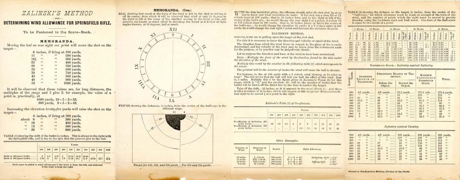

I thought some of you might like to see this set of Army drift/windage instructions from maybe the 1880s? Click the picture and it blows up to full size. Trapdoors really are not my thing, but I presume they are for a M1873 or more likely an M1882 with the improved rear sight. I stole these from a US Military forum post: https://www.usmilitariaforum.com/forums/index.php?/topic/380179-e-l-zalinski/

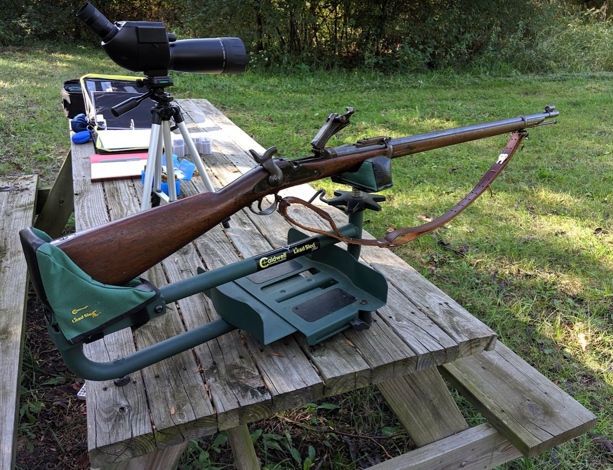

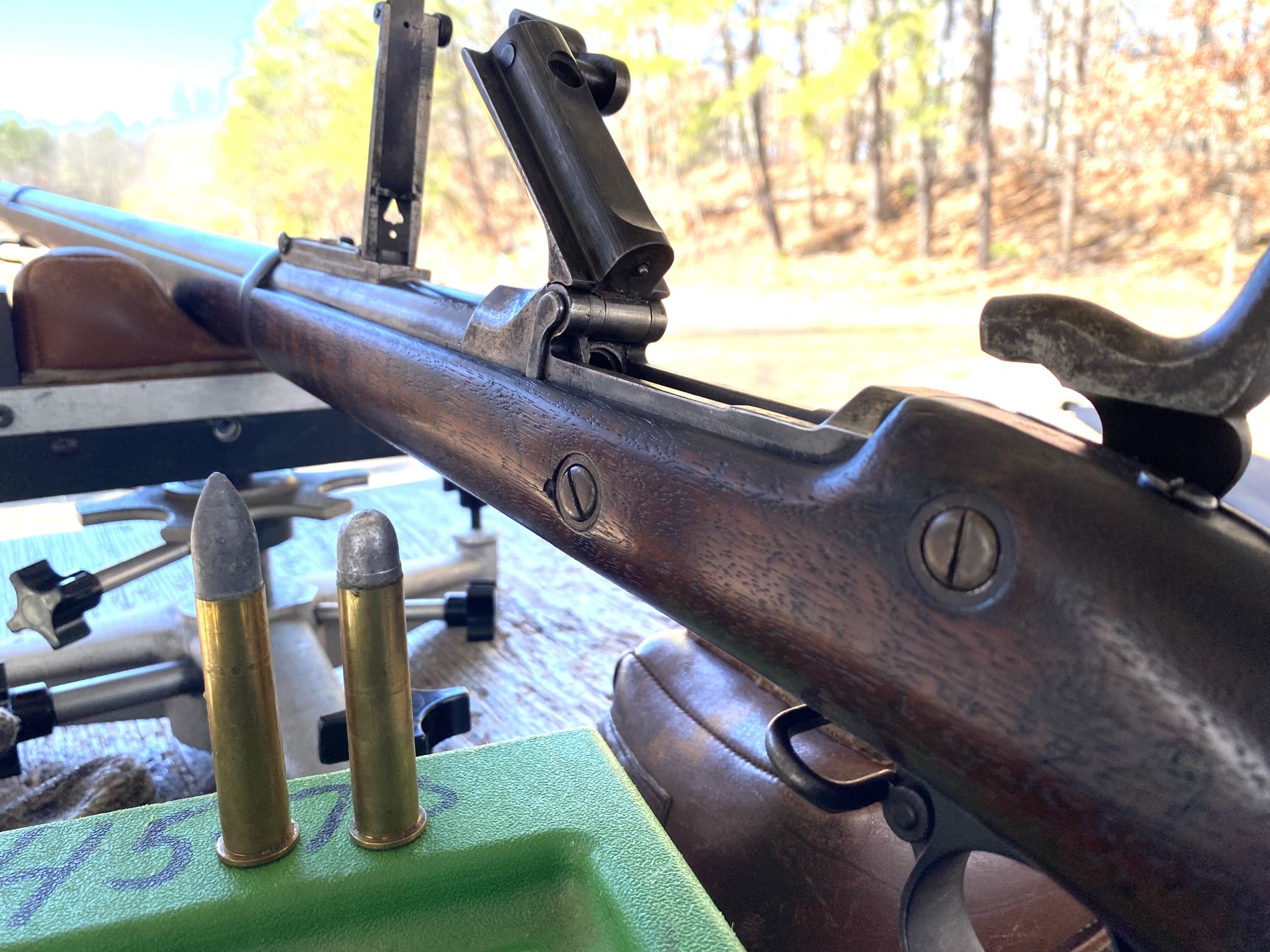

After sitting in the closet for a long while, the old girl made it to the range today. After a couple sighters and un-assing my head, she shot pretty well. 100 yards. Lee 300 gr bullet 12 grains of Unique with a floral foam plug to keep the powder in place. View attachment 8092540View attachment 8092541View attachment 8092542
