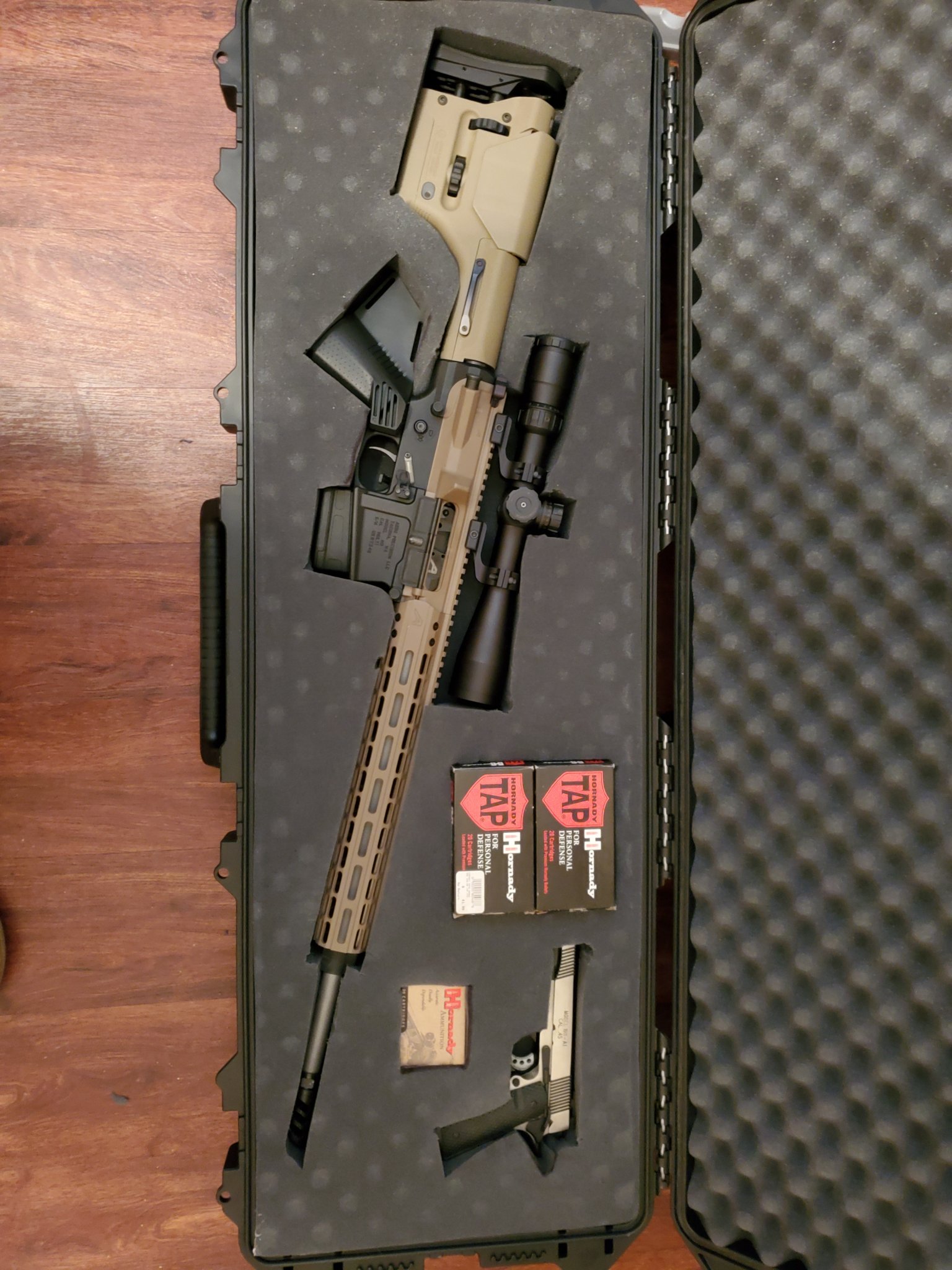

    I fly to places with firearms on the regular.
    Pelican, SKB, standard master locks.
    Keep ammo in the boxes they came in so it doesn't rattle around.
    Keep ammo secured in the same case as the rifle so it doesn't rattle around.
    When you check in, declare you have your guns in the cases. They will probably want to show they are clear/completely unloaded. Do not have a loaded mag in the firearm. They will have you sign a stupid declaration card saying its unloaded and you put that card in the case. Lock the case and give it to them. You keep the key. You may have TSA call you off to the side to open the case for them so they cam inspect your stuff for explosives.
    After they do the stupid swab thing, lock the case, keep the key.
    Go to your flight as normal.
    Collecting it at the destination will be told to you when you initially check in for your flight.
    Based on my experiences:
    If you're flying American Airlines you will likely have to go to the baggage office at the baggage claim to get your shit.
    United puts it on the baggage claim with all other luggage.
    Easy cheesy, lemon squeezy. Don't overcomplicate it.
