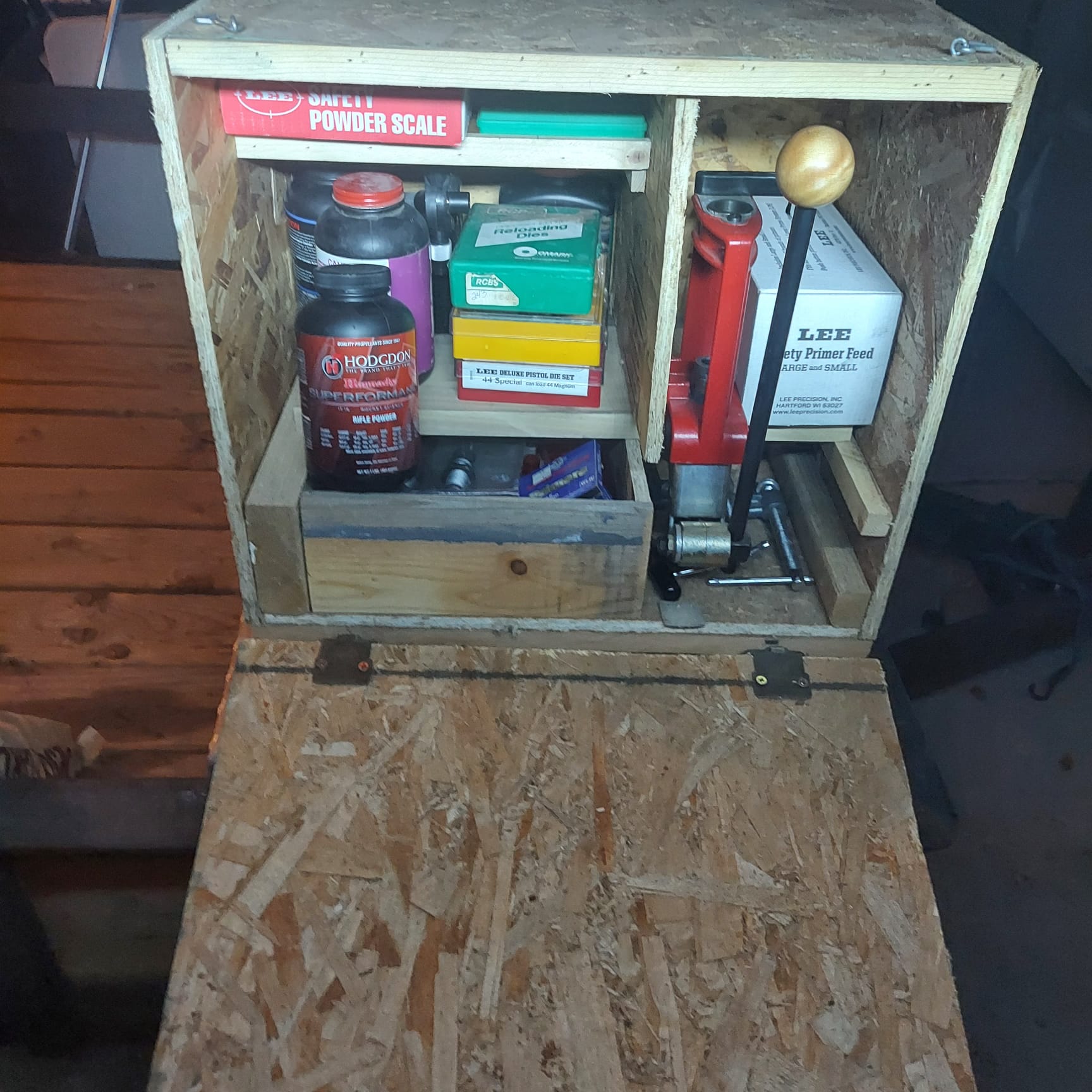

So I’m doing a lot of traveling for work right now. Found a place to shoot where I’m going on weekends… my question, does anybody know a good press for travel and precision reloading? I have a good scale, looking for a good travel press. Not looking to lug my home unit every time I travel. Don’t know if the lee hand reloading tool is worth a crap. Thanks in advance.

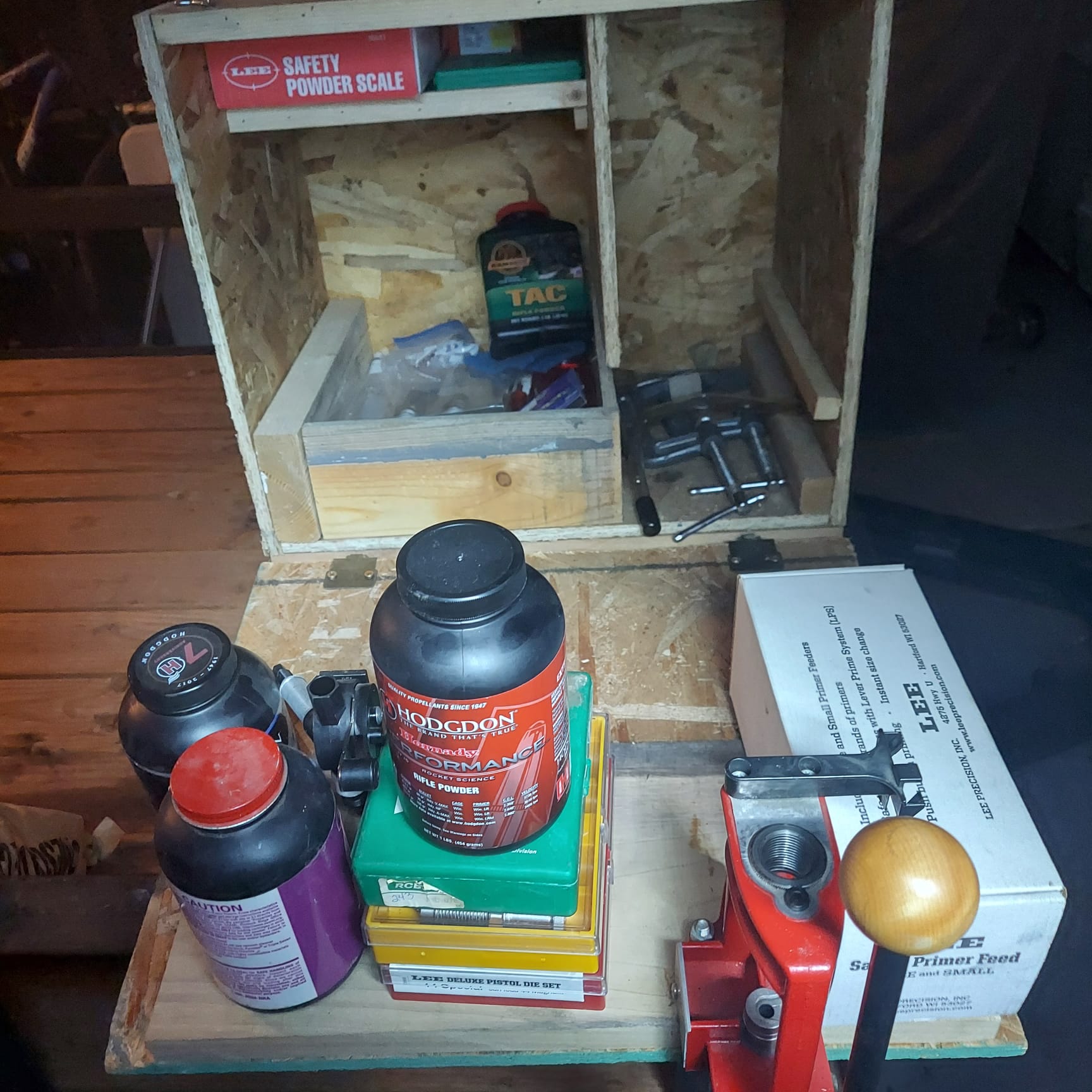

A buddy of mine, his dad travels a lot and this is his set up. It gets the job done and proof of concept.
he is an older, pragmatic gentleman.
Box is 20 wide 14 deep and 18 high.
You will see a lot of boxes like that among the benchrest crowd. I used to know a guy who had a larger one with a Dillon 550.
