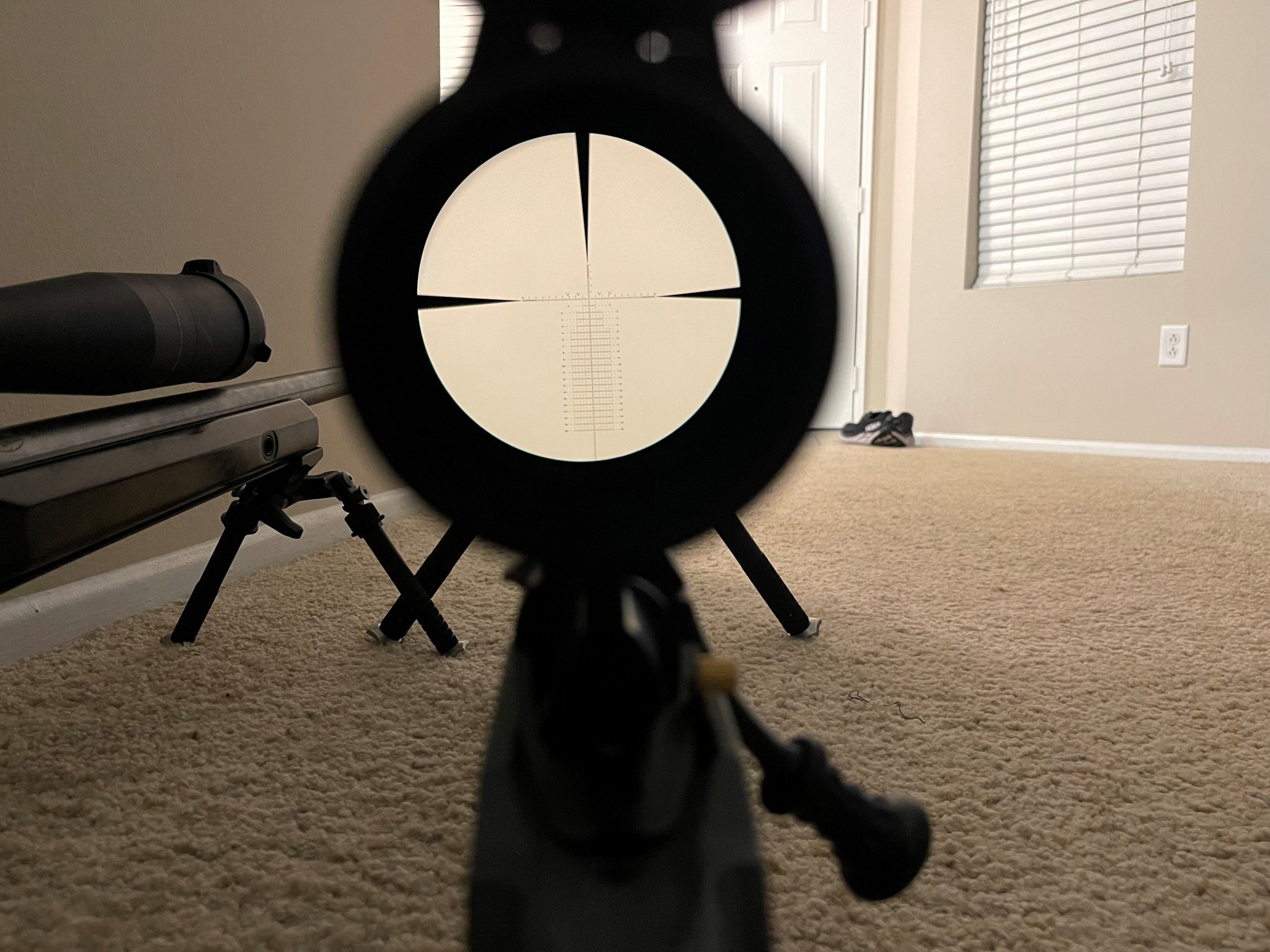

I just got a brand new 7-35 MK5 with CCH reticle in it that is going back to Leupold to warranty. How it got through QC i have no idea!!!!
The reticle is off center
Reactions: BurtG
