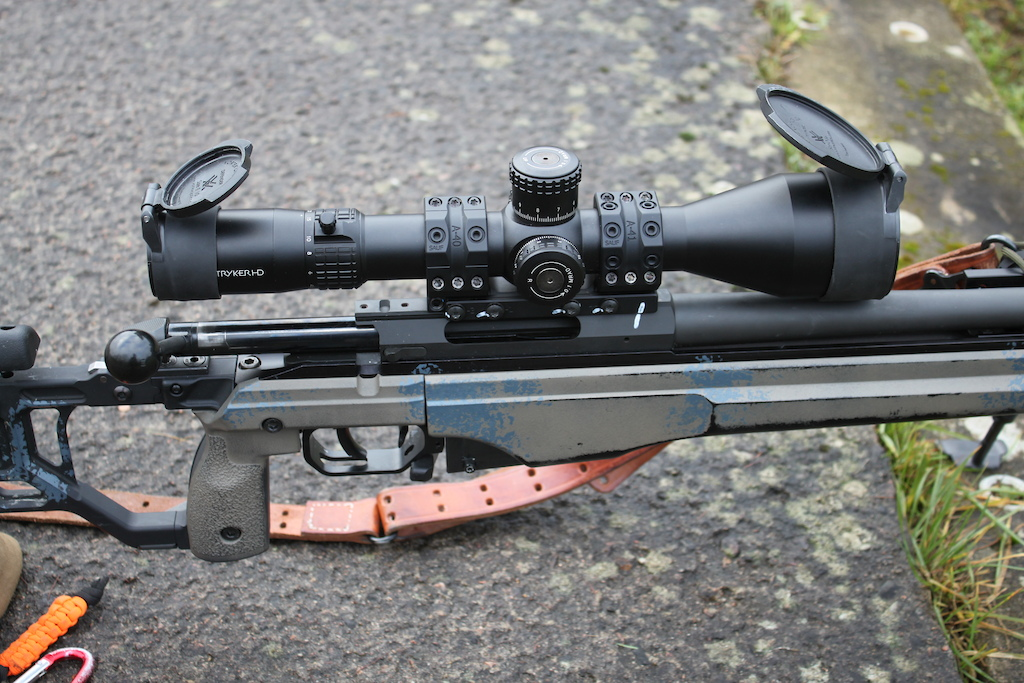

The ST4701 was pretty much made with 56mm objective scopes in mind. I have seen them on Tikka T3 and Sako TRGs with Vortex Razor G2, Kahles K642i, Nightforce ATACR, Delta Strykers, Schmidt & Bender PM2s and Hensoldt ZF 4-16 and probably more.
Here is what my set up looks like.

It will fit, I will say though that I wouldn't do it again, simply because I had to run the mount to its farthest forward position possible, and I still have to run a longer LOP than I'd like to get the right eye relief. If I did it over again I'd have left the 20 MOA rail glued on and just ran rings, they are so much more flexible for scope positioning, that or a cantilever mount to get more forward scope positioning. I feel like now that shooters are learning most are shooting too long of a LOP especially for multi-positional setups I'm seeing this problem more and more, so many rig setups I see now are basically with the scope as far forward as it can possibly be mounted.
