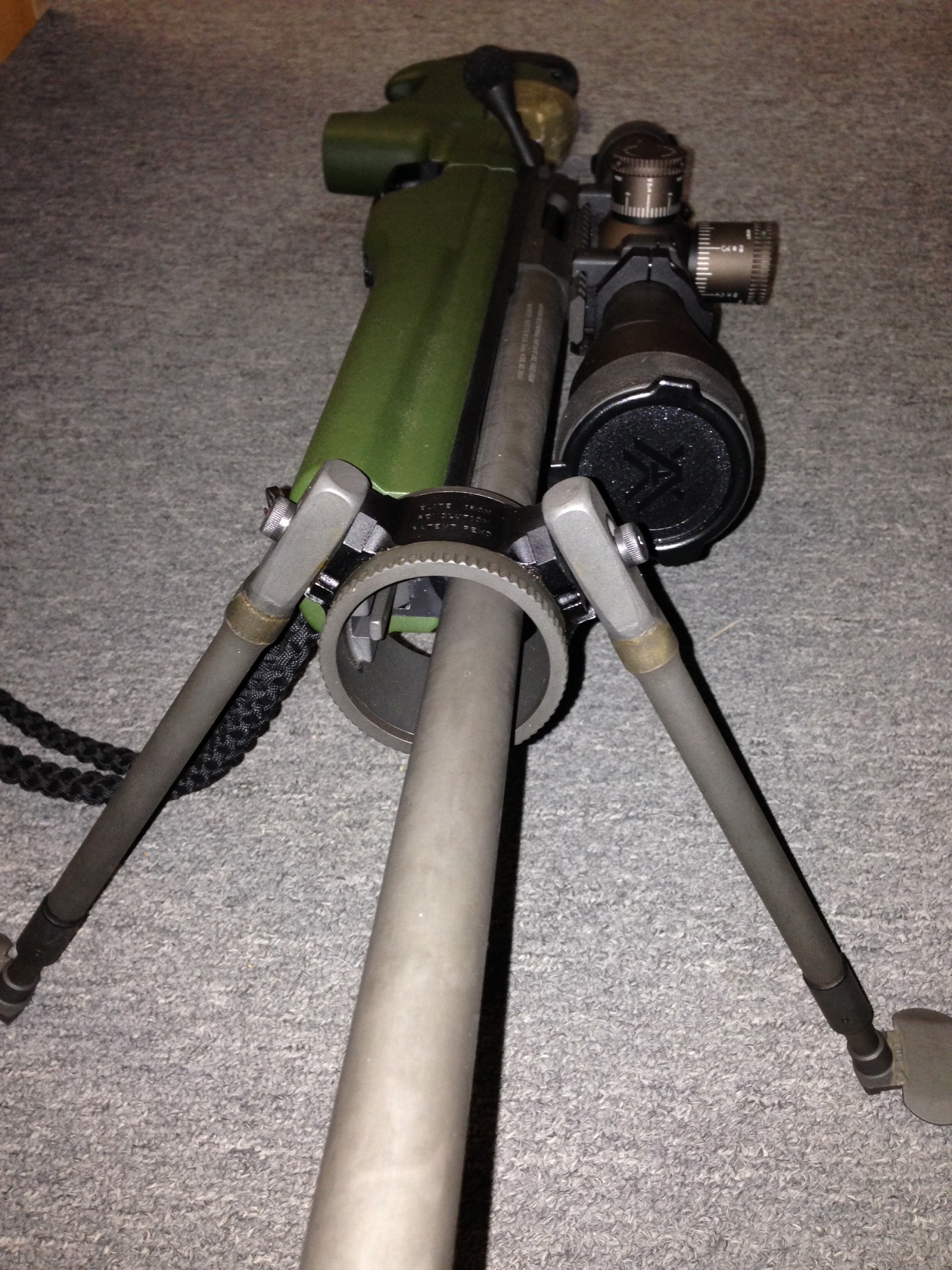

The only bipod I like better than my TRG bipod is my Elite Iron Revolution. It may be the only more costly option as well, but amazingly stable.
finbox, from my chair the Parker Hale and similar designs do the same thing your giving the TRG credit for doing, lets call it "un-tensioned" Pan and Cant, that when loaded "go away". I suspect those that made them have profited handsomely. Now you and others can point out why they are different but the basic "loose joint" design, having a different execution but with same basic result.
However, one should consider the use and application of the bipod, will it be used 95% of the time on a range? Will it be carried into the mountains? Will it be carried into combat? Are snag points an issue? So I respectfully suggest that weight and noise might be considerations while making such decisions and depending on the requirement, consider how much time it'll be carried vs. used.
