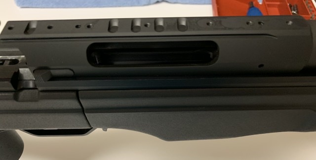

I have a TRG22, near rail, and Athlon Cronus BTR. Now I need to pick up a one piece scope/ring mount? I have looked at the Near Alphamount, the Spur Mount, and the Badger Unimount. The Badger is a little less expensive which I like. It also appears to provide some options for connecting things to the mount, if I decide to go that route in the future (not sure I will ever do that). I would prefer to stay below $300 for this but will spend more if needed and the value is there. Are there any other options I should be looking at? What would you recommend?

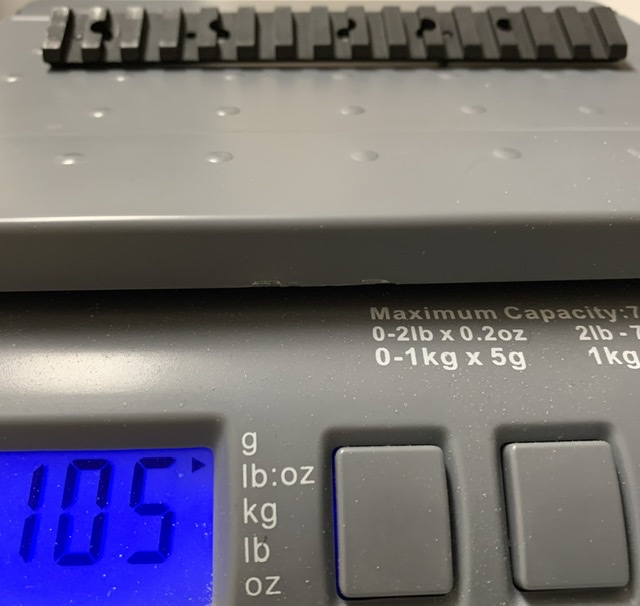

The $300 NF UL 1 piece is lightweight 200grams...
The $300 ARC 1 piece is a bit heavier at 225g
The $400+ Spuhr mount is heaviest one @~255g...but direct mount is probably saving some as well...YMMV
