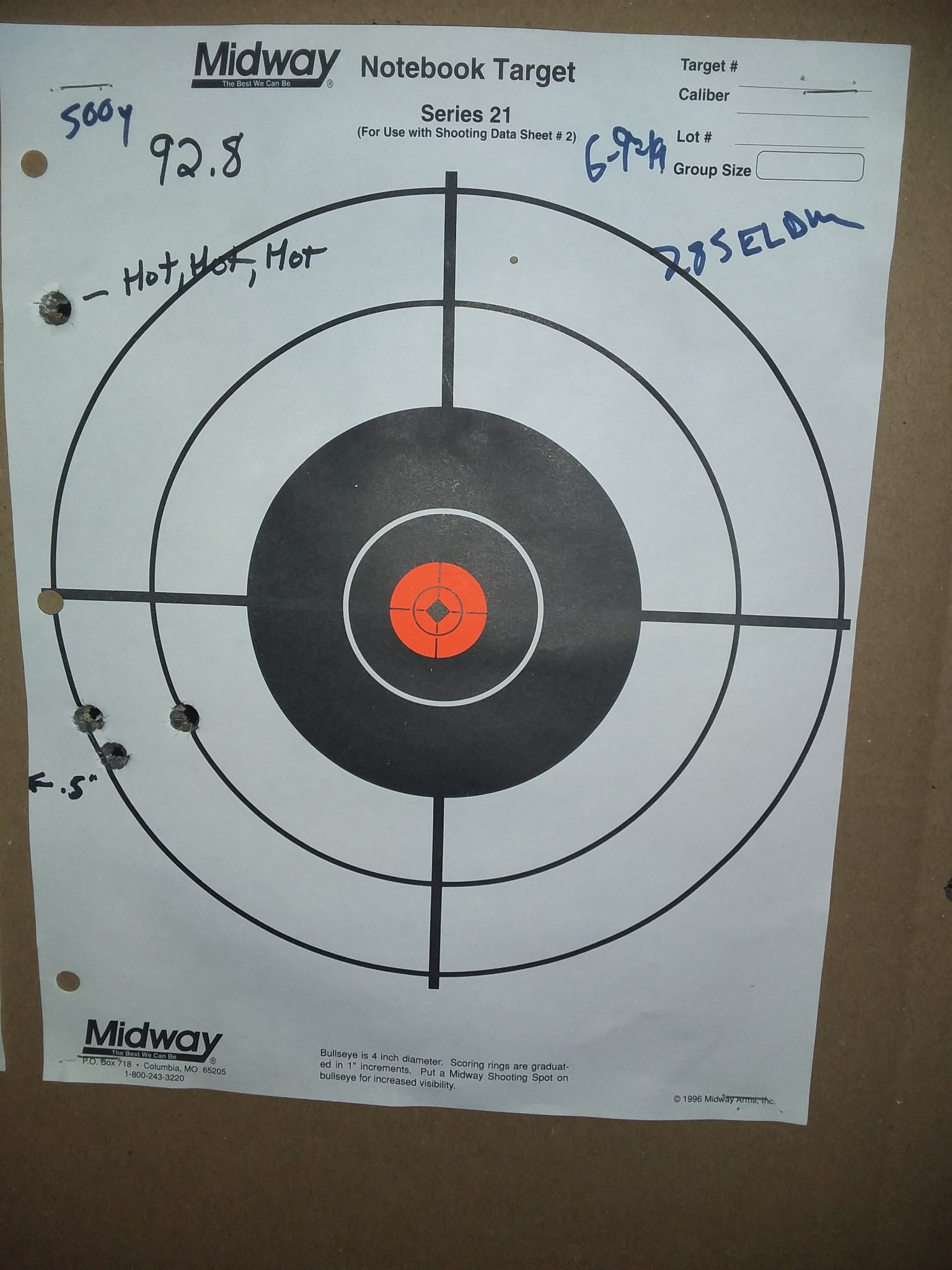

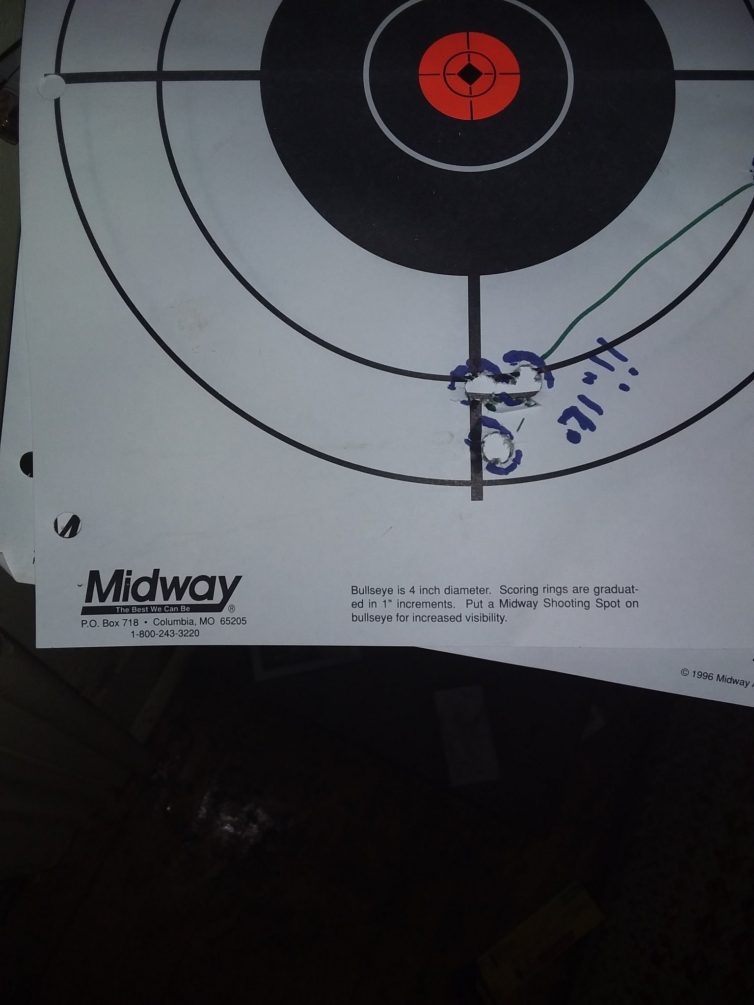

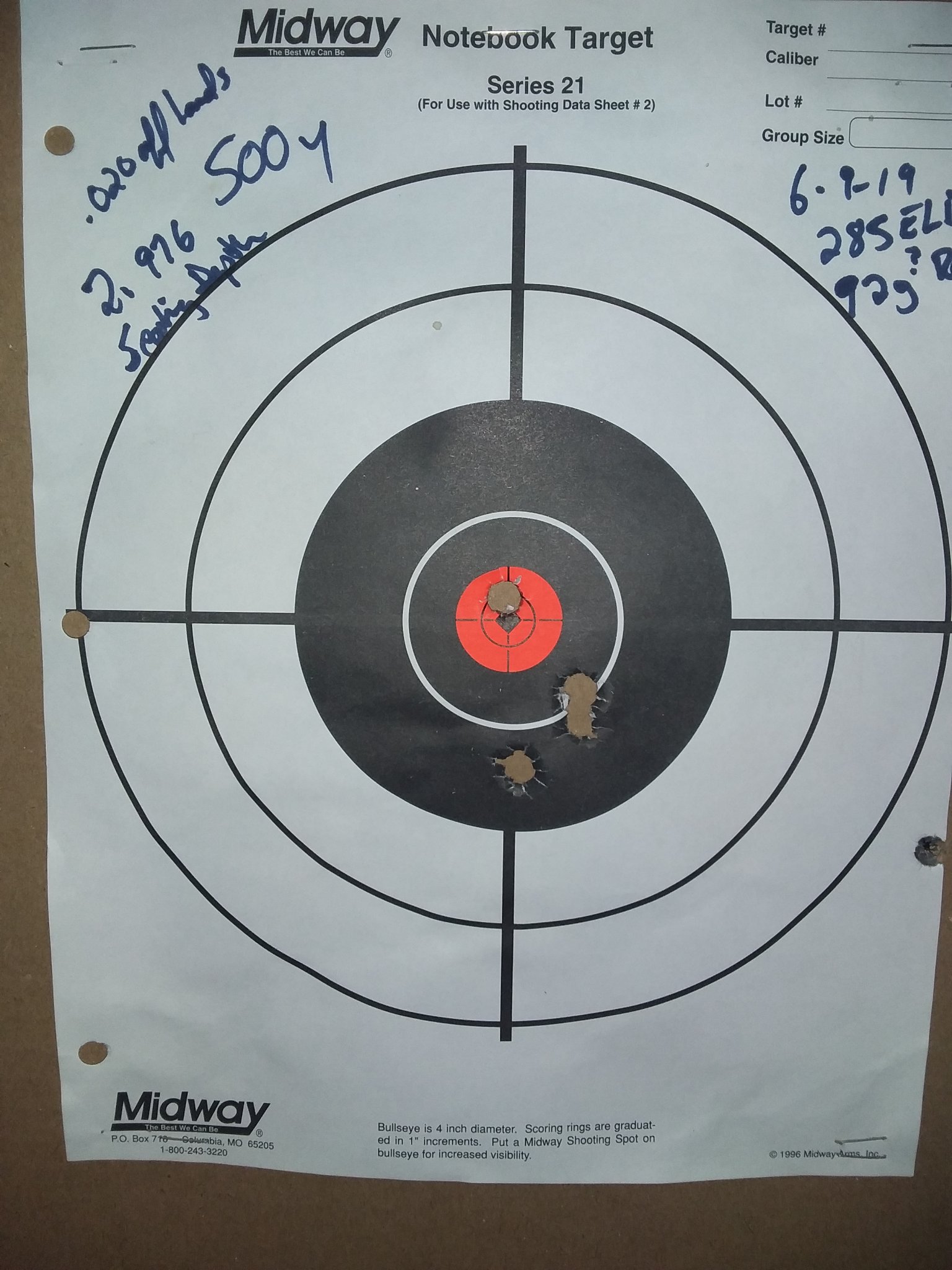

I have a trg 42 338LM that I bought in 2006. I fiddled with the trigger too much and wrecked it. They sent me the newer version which is much nicer except I can't get the weight very low like the original. 1:12 twist might not be ideal, but I have shot 300 grainers with superb accuracy. I settled on the hornady 285g eld-m as it is cheaper to shoot and isn't going to push the stability envelope as much. I just shot out to 2055y last month with 3 good hits so I think it's just fine stability wise. I live at 5000ft however. I attached some 500y groups to show its accuracy potential. Unfortunately I am out of retumbo and hear of none to be had indefinitely. Might try some rl26 that I just scored for my 300 wm, but it usually is even scarcer.
