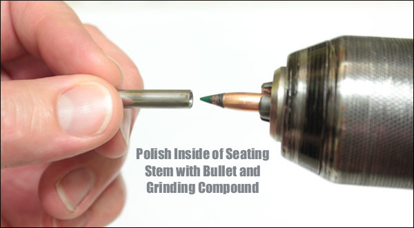

    If it leaves a mark just polish the sharp edge down

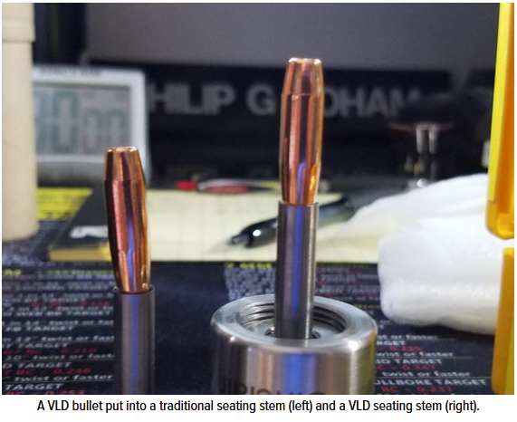

    If the tip bottoms out before the ogive contacts due to the bullet being longer than the stem was designed to accommodate: jb weld fill it in and make it a custom stem with a lubed bullet to make the form in the seating stem.
    Here you can see one that the tip hits and falls off center due to the bullet being too long vs one that contacts all the way around the ogive.
