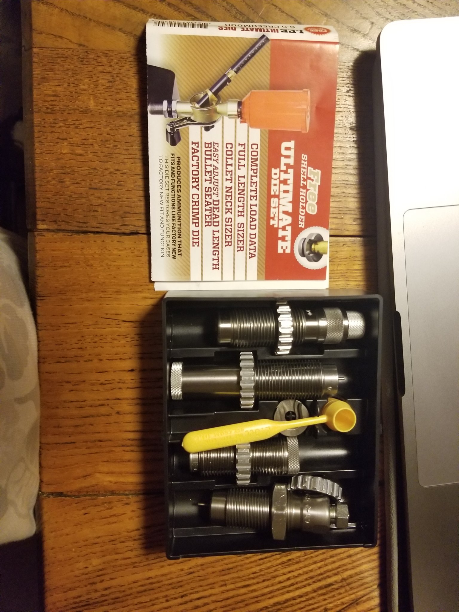

Hey All,
This is my first posting here, so there's that! Cutting to the chase, I just recently purchased a Daniel Defense DD5v5 chambered in 6.5 CM, and added what I thought tot be the appropriate equipment to go ahead and reload for this new to me caliber. Long story short, I just now tried to resize my 1.563" headspace (as measured with a Hornady headspace comparator) fire formed brass, but my dies were unable to adjust the headspace back. I was hoping to bump it back at least .003". I have successfully loaded many 5.56 for my AR-15, so I can't imagine making a huge fudging error to cause such a problem, but here I am.
Here's the following equipment that I was trying to resize my 6.5 CM brass with:
-Dillon 550C press
-Dillon 6.5CM caliber change set
-Lee Full-Length Sizing Die from their "Ultimate 4-Die 6.5 CM Kit" https://www.midwayusa.com/product/1011184659?pid=677881
-A batch of once fired mixed headstamped 6.5 CM brass.

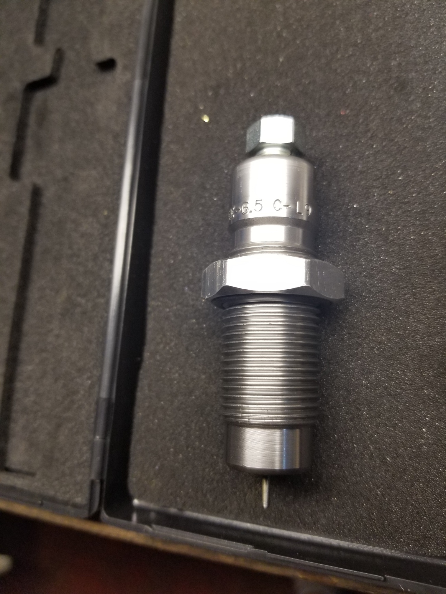

Here's a picture of the specific die I was using:

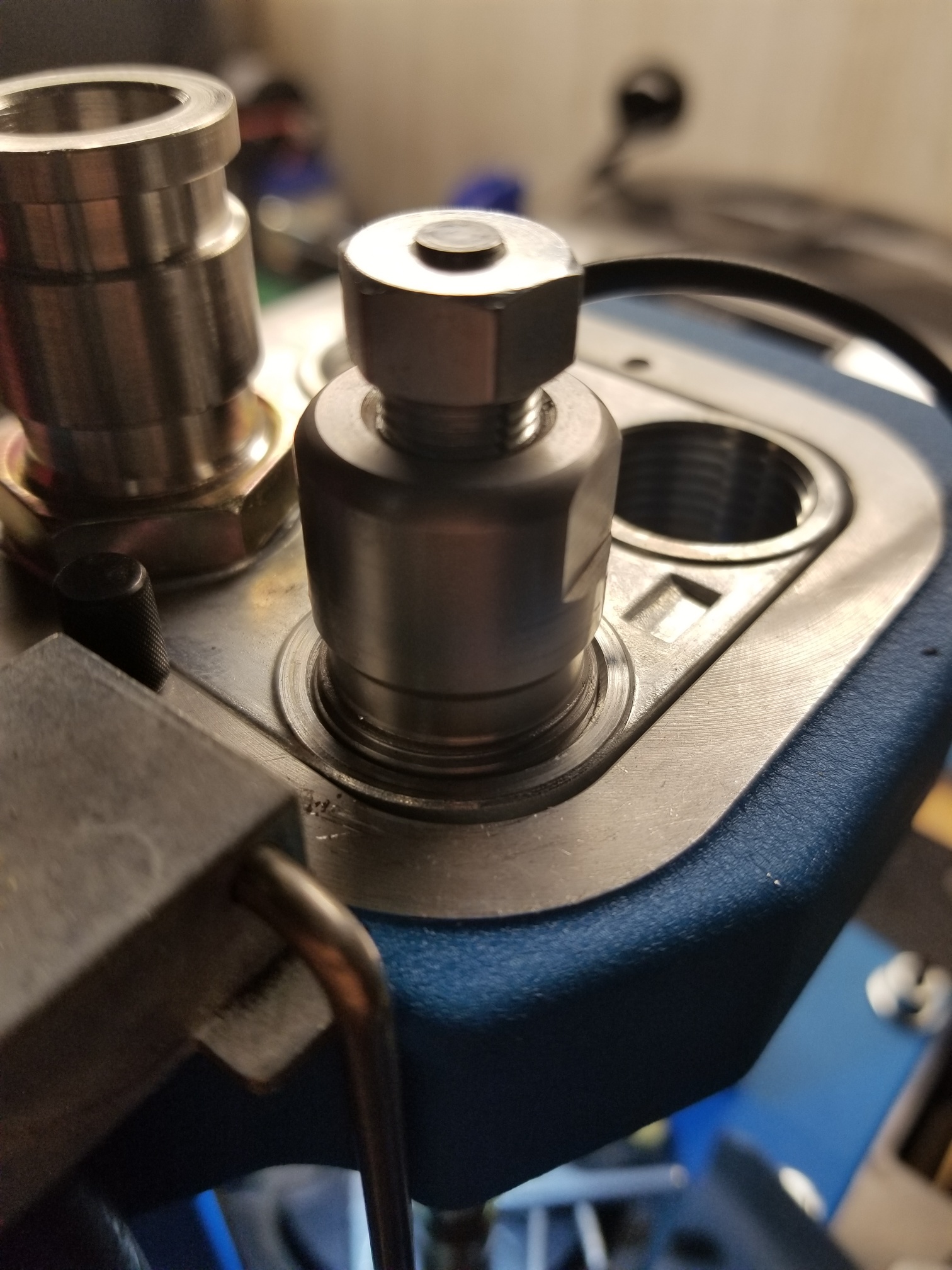

Here's a picture where I stopped after bottoming out the die in my press with no luck. I even removed the lock rings:
Personally I feel like I must have made a mistake on the dies or something. This was my first time using a Lee brand dies. I only have experience with with .223 Dillon dies. Any suggestions or advice would be greatly appreciated. Thanks in advance!

I'm pretty sure I over-cammed to the point where the die not only touched the shell plate, but I continued until I nearly ran out of threads above the Dillon toolhead.
Looks like the die is screwed in so far it Barely leaves enough threads for a locking ring? Or am I just tired and seeing things. I’ve filed a die a little shorter before so it would go down far enough to bump the shoulder how I wanted but yours looks like it might not leave much for the locking ring.
Well if that is the case then they are indeed too short. I use Redding dies both Type S and Standard to size 308 and 6.5 creedmoor on my Dillon 650.

A friend of mine went down this road when he bought a new 550 press and wanted to continue using his Lee dies. They are too short to use in the 550 or 650. I suppose one could put the lock ring on the underside of the shell plate but I'd just get a different set of dies. I've had some of my sizing dies shortened .002-.003 to avoid excessive cam over on my XL650. Although, Dillon says excessive cam won't hurt the press, it is not very smooth in my opinion. I know those that run their Dillons with a ton of cam over to achieve proper bump but I never liked it and the fix was easy.
That's really interesting that you pointed that out. I think Boxerglocker had suggested that same idea of putting the locking ring under the toolhead. Since the Lee die purchase was brand-new, I went ahead and processed the return. I think I'm going to figuratively bite the bullet and go with the Redding National Match (NM-C) Die Set. https://www.natchezss.com/redding-national-match-nm-c-die-set-6-5mm-creedmoor.html. I realized that Dillon sells Redding Dies for the calibers that they don't currently manufacture themselves. I would assume that Redding would therefore be the best bet for Dillon press compatibility. Thank you everyone for your input! I'm liking this forum community already!
Well, there you have it.
I use a Dillon 550 to load 6.5 Creedmoor AR10 also 6 and 6.5 Creedmoor bolt guns. Dies thread deeper in a Dillion 550 head than in my RCBS Rockchucker, which leaves less thread above for the lock nut. I was originally using a standard RCBS two die set and switched to Redding bushing dies. Both have worked without issues in the 550.
I have several Lee die sets for pistol caliber and find the same problem - the dies are made short and I guess they fit most things fine but not a Dillon 650 or Super 1050 with thick die plates. You have to put the lock nuts on the bottom of the sizing die for sure. I also hate their lock nuts with the o-ring as there is too much play and they COME LOOSE ! So I always buy the split type lock nuts that screw together and clamp down onto the threads. This way you can remove the die for whatever reason and not have to reset it. Make sure you have a wrench that will fit the nut flats and access cuz sometimes space is limited.
In the future if you have a problem using a product - Call The Manufacturer. They know their products and are all happy to help you.
Reactions: MNtadpole
Thanks everyone for the awesome input. You all are a valuable resource for sure! I'm still waiting on my Redding National Match 6.5CM dies to ship from Natchez....ugh. Apparently, they are four days behind on shipping all ordered products.
