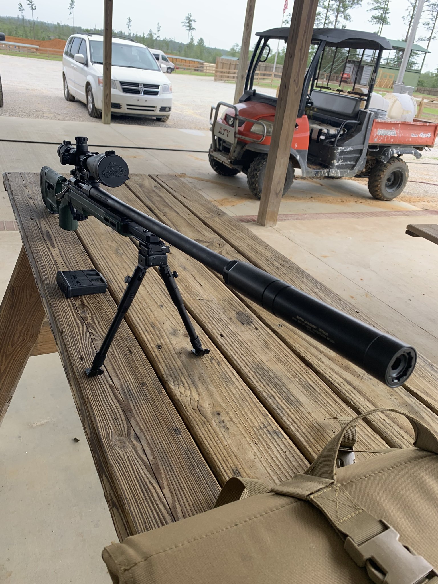

    My v22 repeater is the ridgeback model with a 22” Kukri barrel and a trigger tech diamond trigger shooting center-x. I have a 40 Moa base with a vortex 5x25x56 strike eagle on it. I am able to shoot 25 yd indoor targets and have shot silhouette targets at 200, 300, 380 and 500 meters with this setup. The strike eagle has 110 minutes of elevation and 36 more minutes if stadia in the reticle. To get to 500 meters I needed 117 minutes of elevation which took a combination of elevation dialing and holdover but it was pretty easy to hit those big rams with it. A 60 minute base would have let me dial the 500 meters no problem.

    Lots of good info .How is the trigger? How about action.
    i love the diamond trigger. it is the same as my 6mm, both are single stage and set to 4 oz. it could go to 2oz but i chose not to. the v22 action is control feed so there is not chance of dinging the bullet on the way in the chamber and very smooth.

    I have an Apparition KRG chassis with the 20 inch Kukri barrel, and Trigger Tech Diamond single stage trigger. I like the gun, but I'm not a fan of the KRG. The mag well is too sloppy and I had to fiddle with the magazines to get them to seat well. If you are running suppressed, you may want to keep your barrel relatively short 18-22. Powder is pretty much completely burned at 20 inches. I agree about the Timney-go with the Trigger Tech 2 stage or Bix. Barrel contour? How much weight do you want? A heavier barrel is more stable and may be better for really long range shooting. Rail? I'd go 30 MOA and maybe consider adjustable mounts like Burris Signature Tactical where you can add up to 40 more MOA. You can always change the rail.
