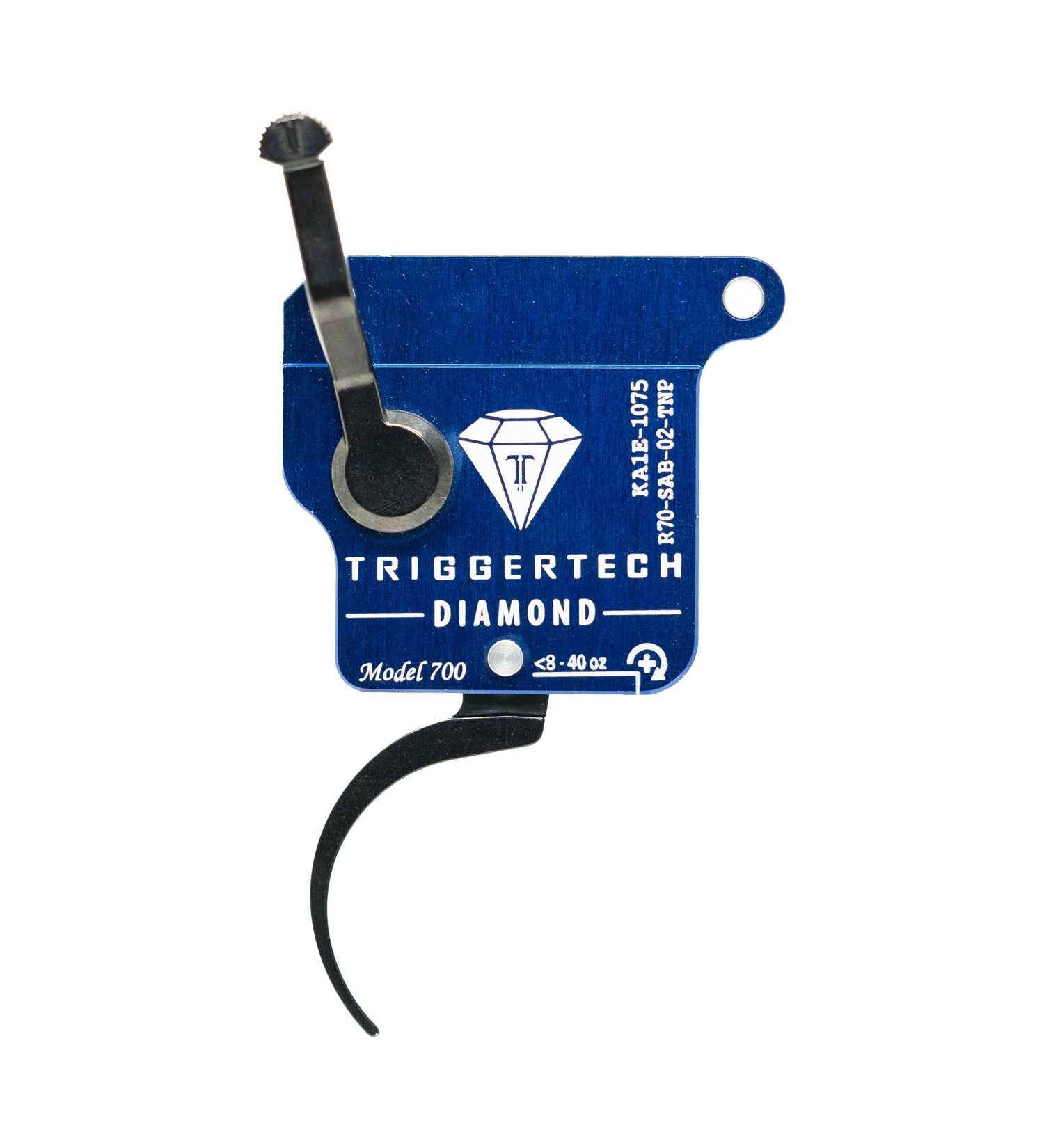

    TriggerTech Rough Diamond. The difference in price is huge, between the RD and the Diamond, but the only difference is that the RD only goes down to 8 oz, whereas the regular Diamond drops down to 4 oz. Not many people will need that extra 4 oz. of lighter pull, so the $100 savings getting the RD is worth it, IMO.
    I noticed that one says pro? Do you know the difference in that pro version
    I have dumped all of my TT diamonds for Bix’n Andi Tacsport ProX 2 stage triggers. They just felt wrong to me. I like a little over travel as well as a short/light first stage with a solid 7oz wall. The TT has no real over travel and their 2 stage does not really feel like a 2 Stage. Of course EVERYONE has different preferences. I also love the adjustable sear on the Bix’n Andi.

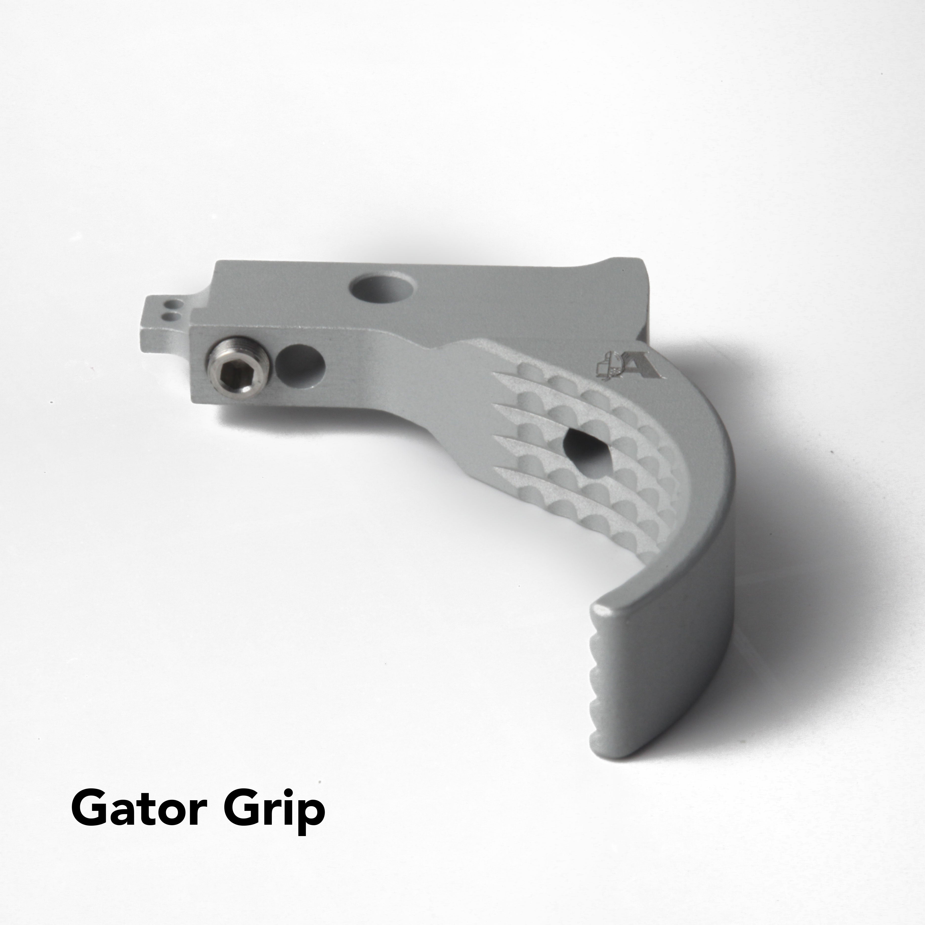

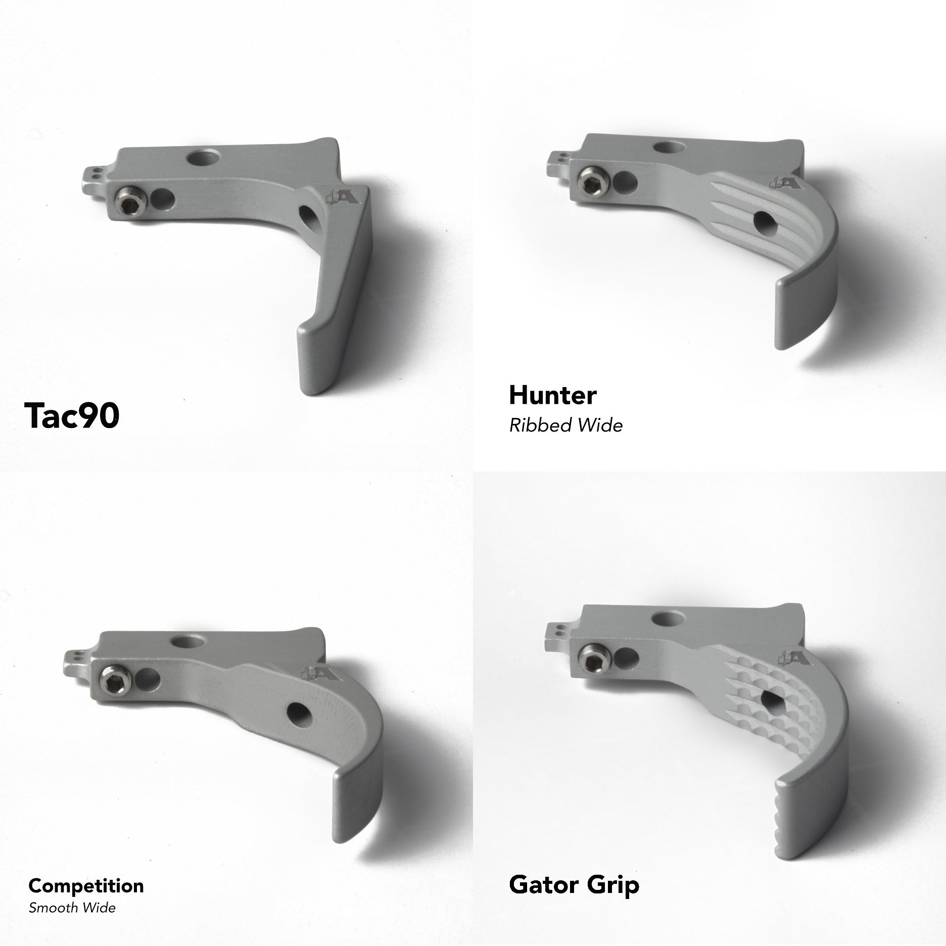

    From my experience, you won't like the B&A... Their trigger shoes are VERY thin, and feel like you're pulling on a toothpick. Peronsally not a fan.
    Broseph, the gator shoe is fat fat fat. Has an awesome texture.
    Maybe, but all the ones I've feft were super skinny and felt like a ribbed toothpick... They also weren't that smooth, and had noticeably more creep than my TT's...And my Timneys.

    Also, idk what you mean by the shoes being ribbed toothpick, but my 90 degree bix shoe is wider than my TT Diamond shoe by a noticeable amount
