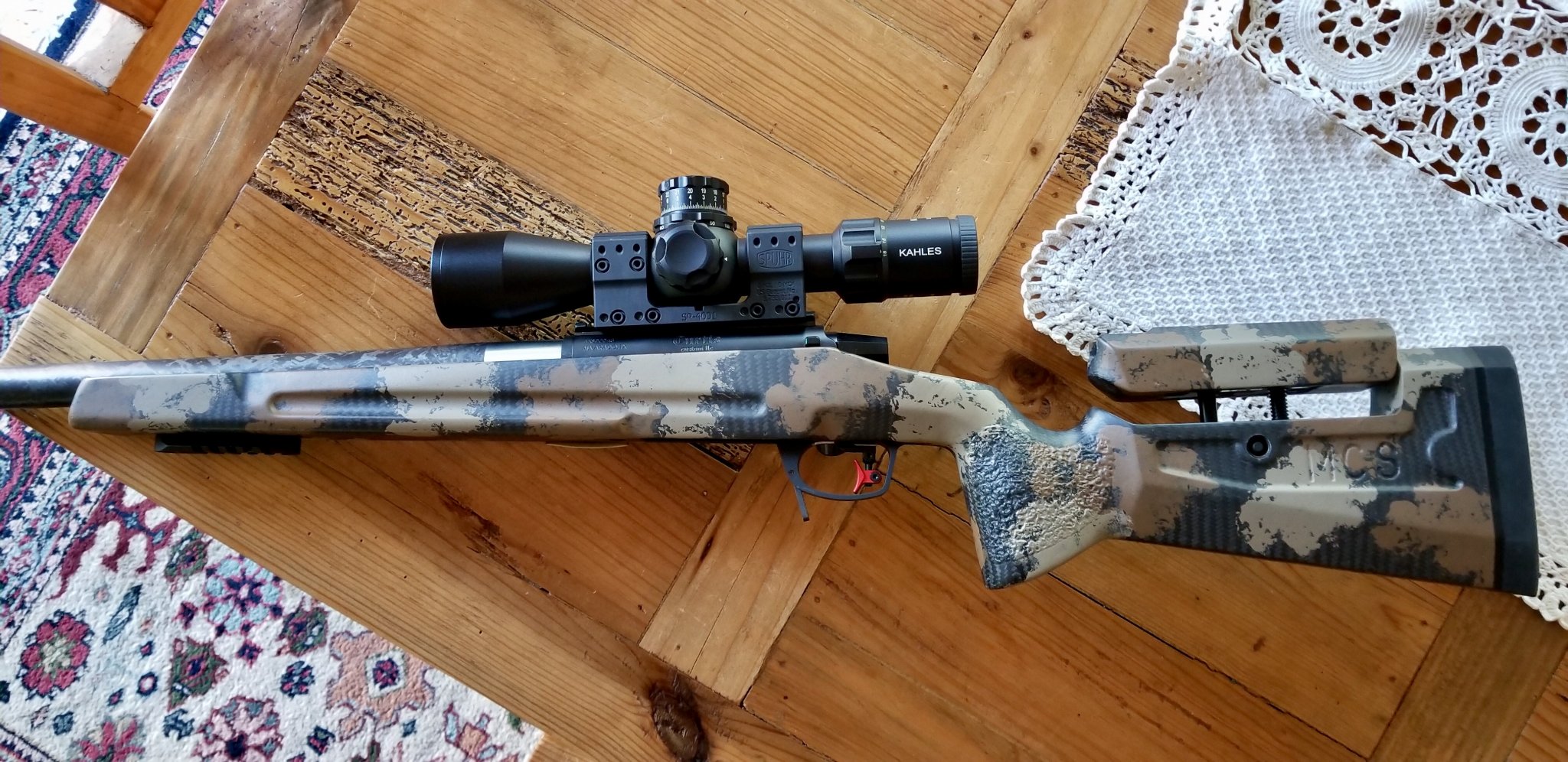

Trigger pull weight?
bikeracer
Formerly Robb57
Aug 10, 2011
201
170
67
I just bought a rifle off the Hide - Curtis Axiom action, Manners PRS 2 stock, Proof barrel - and it has a Timney Calvin Elite single stage trigger set at 1/2 lb. I'm used to the two stage trigger on my AI so a single stage trigger with this light of a pull weight is a big change. I know I can adjust the pull weight and I don't think the single stage will be an issue once I get used to it but I am wondering what most of you have your pull weight set to for matches and range practice. I went to the range yesterday - shoots great - very happy.
