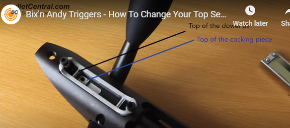

With no trigger installed what is the distance between the top of your trigger pin to the firing pin sear?
Thank you, I was looking for something like this exactly.
Mine measured consistently between 4.02mm and 4.04mm. Looks like I need a low sear. Does that make sense? The surface on my sear (Remington walker or 40x) is pretty easy to get to. Would it be worth trying to stone down that sear surface?

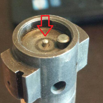

First, put a pin through the trigger and see how tall the difference is in it vs the measurement you just took.
For over travel- measuring the back of the firing pin in its relationship to the bolt shroud.
When you close it with the trigger installed- how much does the firing pin protrude from the shroud vs its normal cocked position? And how far different is that from with the bolt uncocked with firing pin released?

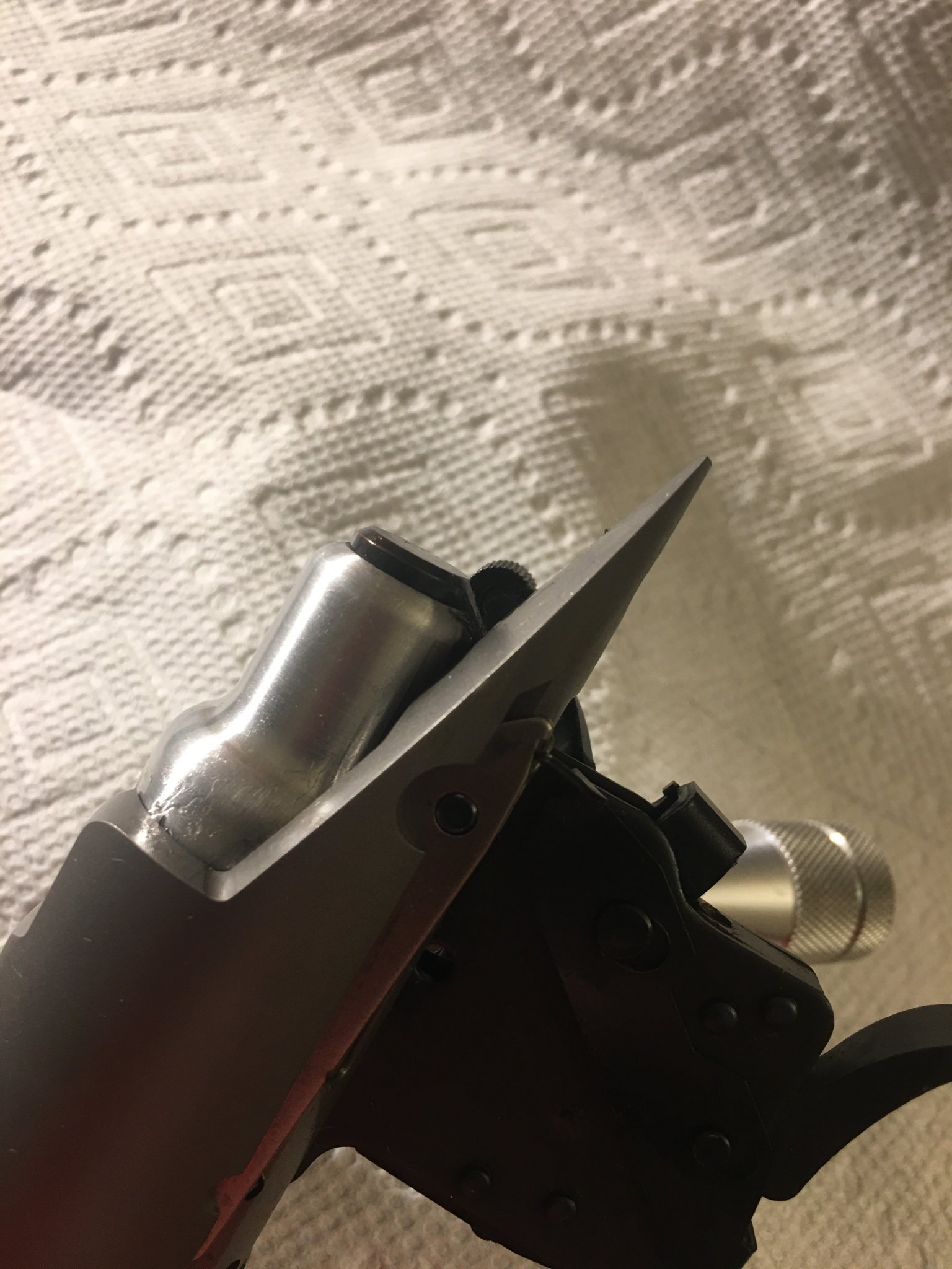

You take a look at your bolt plug and cocking piece within the bolt plug. In the pic below, the cocking piece is the silver portion. The plug is the bell shaped portion that houses the cocking piece. When it's over cocking, as you close the bolt, the cocking piece is pressed against the corresponding trigger sear surface too early and as you close the bolt handle, it over compresses the firing pin spring.
In order to tell if you're over cocking, measure the firing pin fall. With empty gun and trigger installed, dry fire the action, measure the depth of cocking piece within the bolt plug . Cycle the action and then measure the position of the cocking piece. The difference between a fired state and cocked state should ideally be between 0.230" and 0.250" for an R700. If it's higher than about 0.250", you're over cocking.

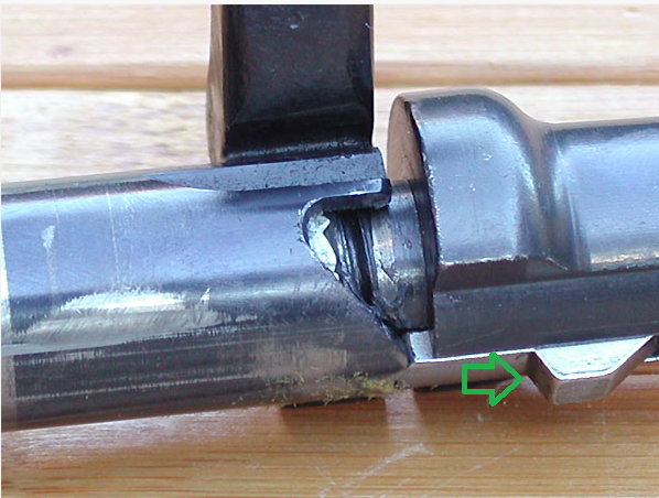

If it's an over cocking issue, you can stone the slanted surface of the cocking piece in the pic below. Taking off very little at a time.

.310" is too much fall. Stone the slanted portion of the cocking piece pointed by the arrow. You don't want to change the angle of it.
Remove in .010" to .020" increments. Checking for the bolt close feel every time. If it feels better and better as you reach the ideal range, then more than likely what you were feeling was the effects of over cocking.

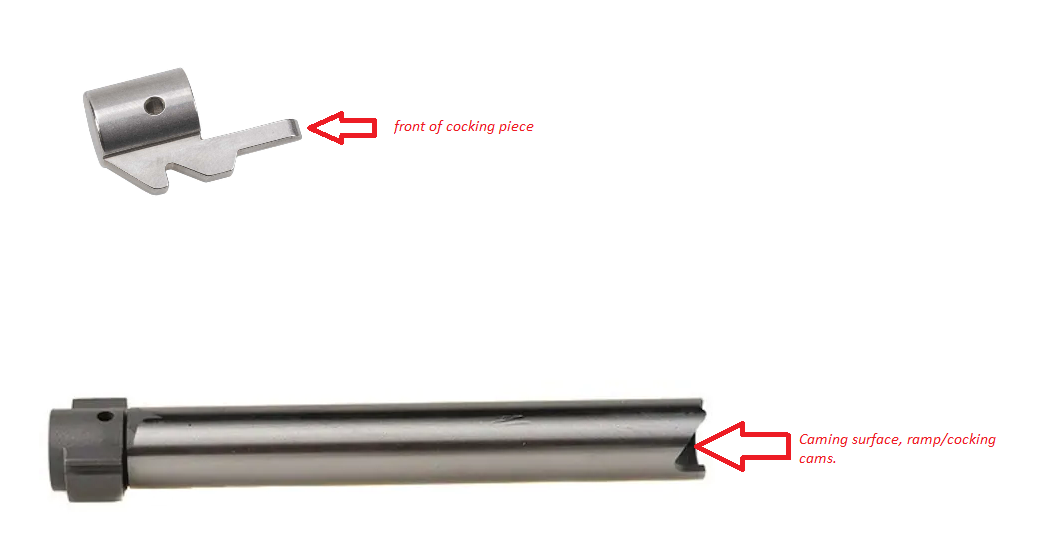

2. Three potential issues off the top of my head with just backing off the firing pin assembly. First being just a safety aspect. second being you would potentially reduce the firing pin protrusion (should be around 0.055 to 0.060"). Third being the front of the cocking piece may be backed off from the cocking cam on your bolt body resulting in weird bolt, usual bolt lift feel. As a whole just seems sketchy from a safety perspective but someone else would know more about that than I do.
