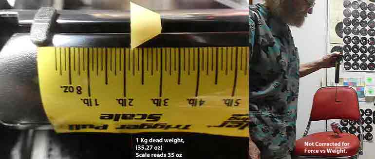

Calibrate with a bag of bullets :)
OR,
A real calibration weight. Note that pounds of FORCE will be slightly different than pounds of WEIGHT.

I made the comment in my trigger pull calibration, just because :)
Local gravity does impact precision scale calibrations, in the order of 0.1%.
7 pound trigger pull, 0.1% is close to an ounce. Of course, if you are CALIBRATING force gauges you want to be more accurate than the device you are calibrating.
