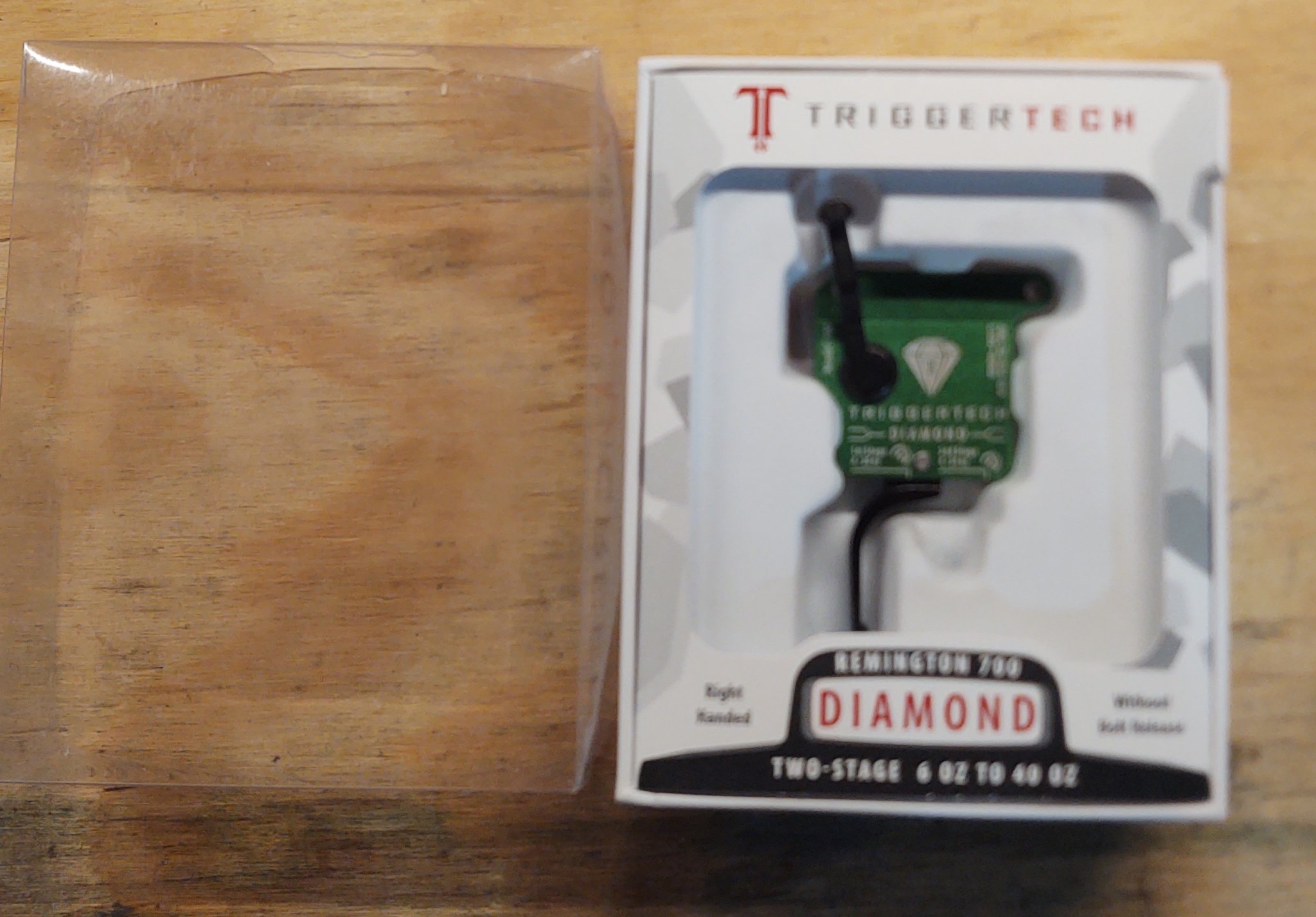

    I purchased this trigger new for a Rim X build but it isn't compatible with my action. It has a tight spot at the very initial movement of the first stage. Basically my action is putting too much pressure on the sear. I have another diamond 2 stage that does the same thing, but they both work flawless in my Vudoo. I bought this trigger a little over a month ago and it has less than 100 live rounds through it and some dry fire while testing it. It is like new comes in the box and includes everything it left Trigger Tech with.
    I had to replace it with a Bix'n Andy TacSport Pro and I like the Trigger Tech Diamond better, but...
    off the market for the time being
    Sorry for the poor pic quality, my camera doesn't focus very well anymore (it's had a hard life).
