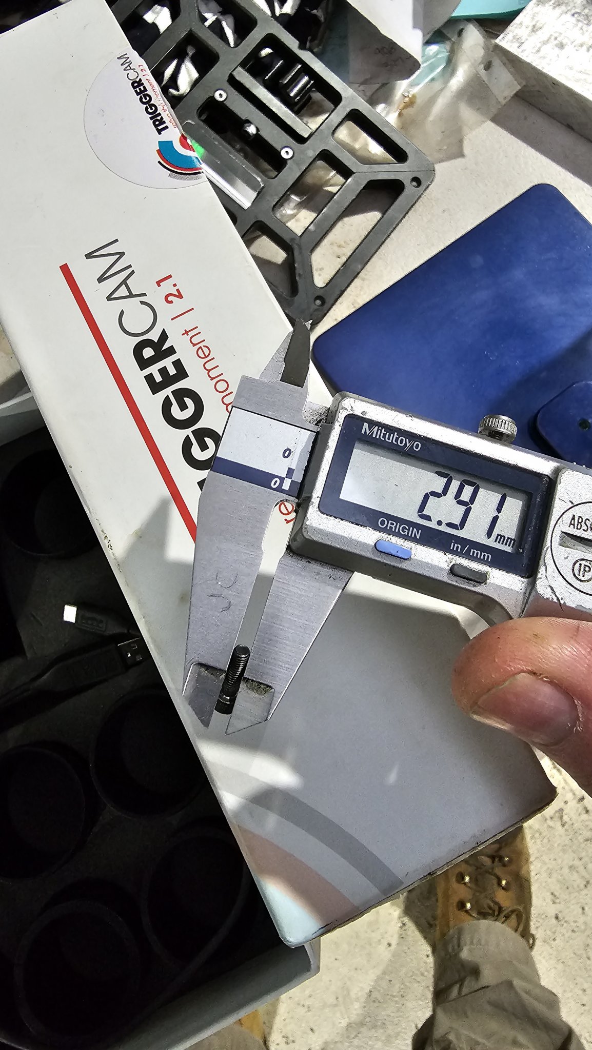

Anybody happen to know what the clamping screw size is on the TriggerCam 2.1? Need thread diameter/pitch and screw length, if anyone can help a guy out
Caveat: the smallest screw size I can measure by a thread checker is m4 and the Triggercam screw is small enough to be fully inserted without threading.
I measured the thread pitch at .5 metric on a screw gauge, which corresponds to m3 (m3x.5). The thread length is 10mm. I feel very confident about this size but wanted to tell you how I measured it. And caliper says it is a cunt hair under 3mm, so that checks out.
