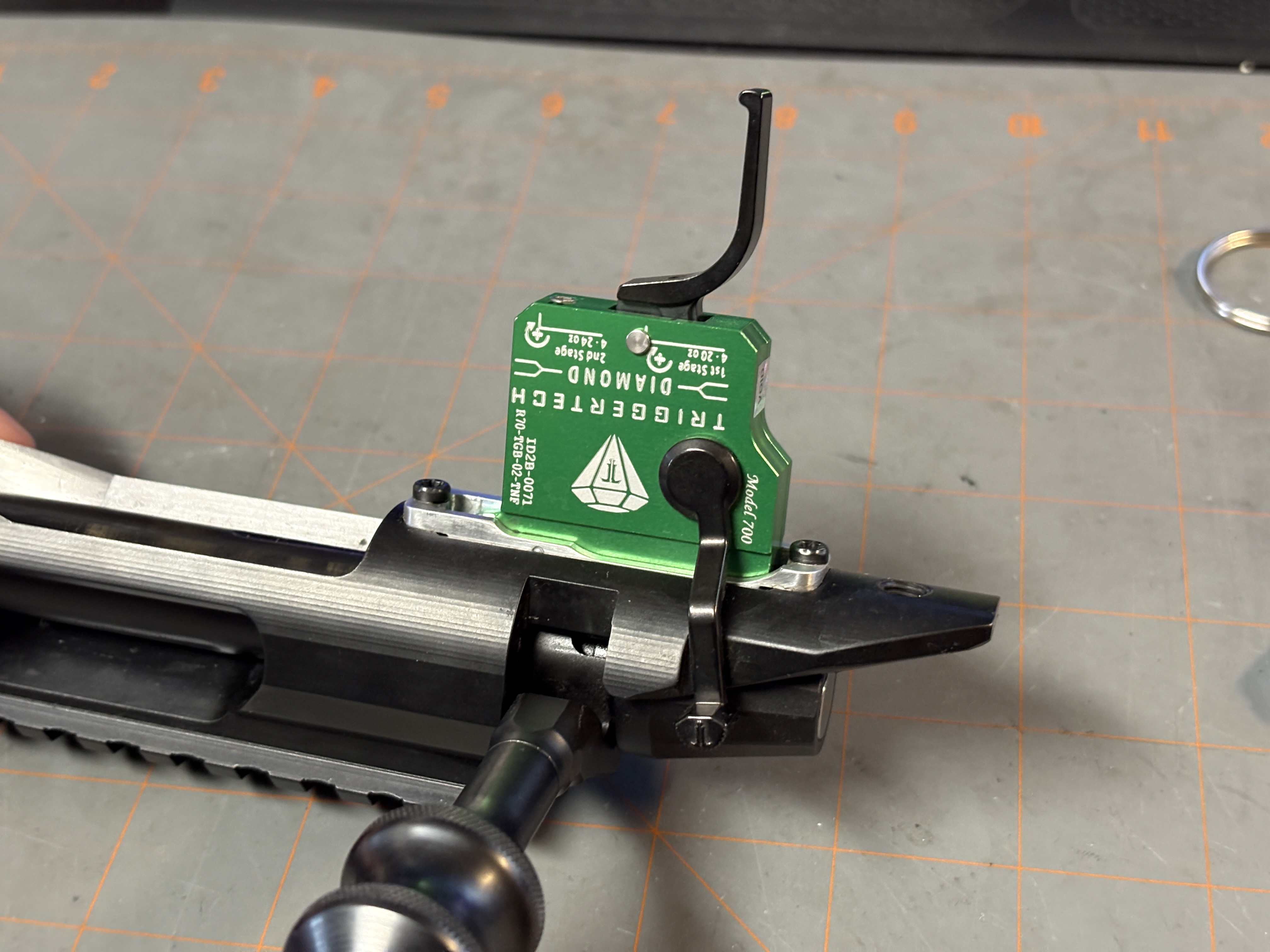

I’ve never had this issue before. I just bolted together a new impact 737, 25x47 barrel, and Triggertech diamond 2 stage.
Every 7-8 cycles of the bolt, I get this odd trigger feeling where all of a sudden it’s not a 2 stage. It feels like a single stage, and then just breaks randomly. Like you go to pull for that first stage, and wham, it fires. I’ll attach a video somewhat describing it.
I’ve tried adjusting the weights much heavier with no luck. Tried a different bolt aswell.
I’ve got like 6 of these adjusted waaaay lighter than this, never a single issue.
Bad trigger?
I was promised by a few friends this was a pull weight issue. However, I triple checked. I have adjusted 1st and 2nd stage multiple times, seperately, and the issue is still there. Sometimes it takes 20 cycles of the bolt, but it comes back no matter what. It seemed to go away when I tightened it up to like 3-4 lbs, it took about 60 cycles of the bolt, but I did have one instance with it tightened up that high aswell. So it seems it’s incorporated with something in the trigger that is tied to the weight of the adjustment.
Sent an email and the video to TT. I’ll stop at my local shop today and grab a new one, toss it in and see what happens. I assume it’s just a dud.

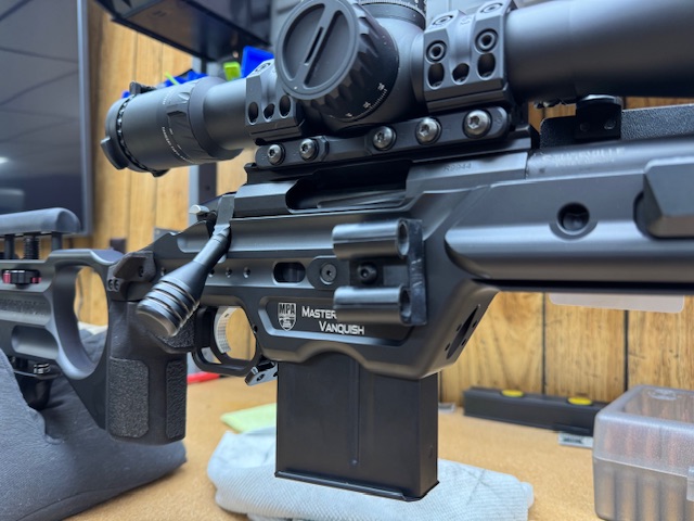

I will attach a video of the issue in my new MPA vanquish and also my Samson. Same action same trigger same 75 degree bolt.

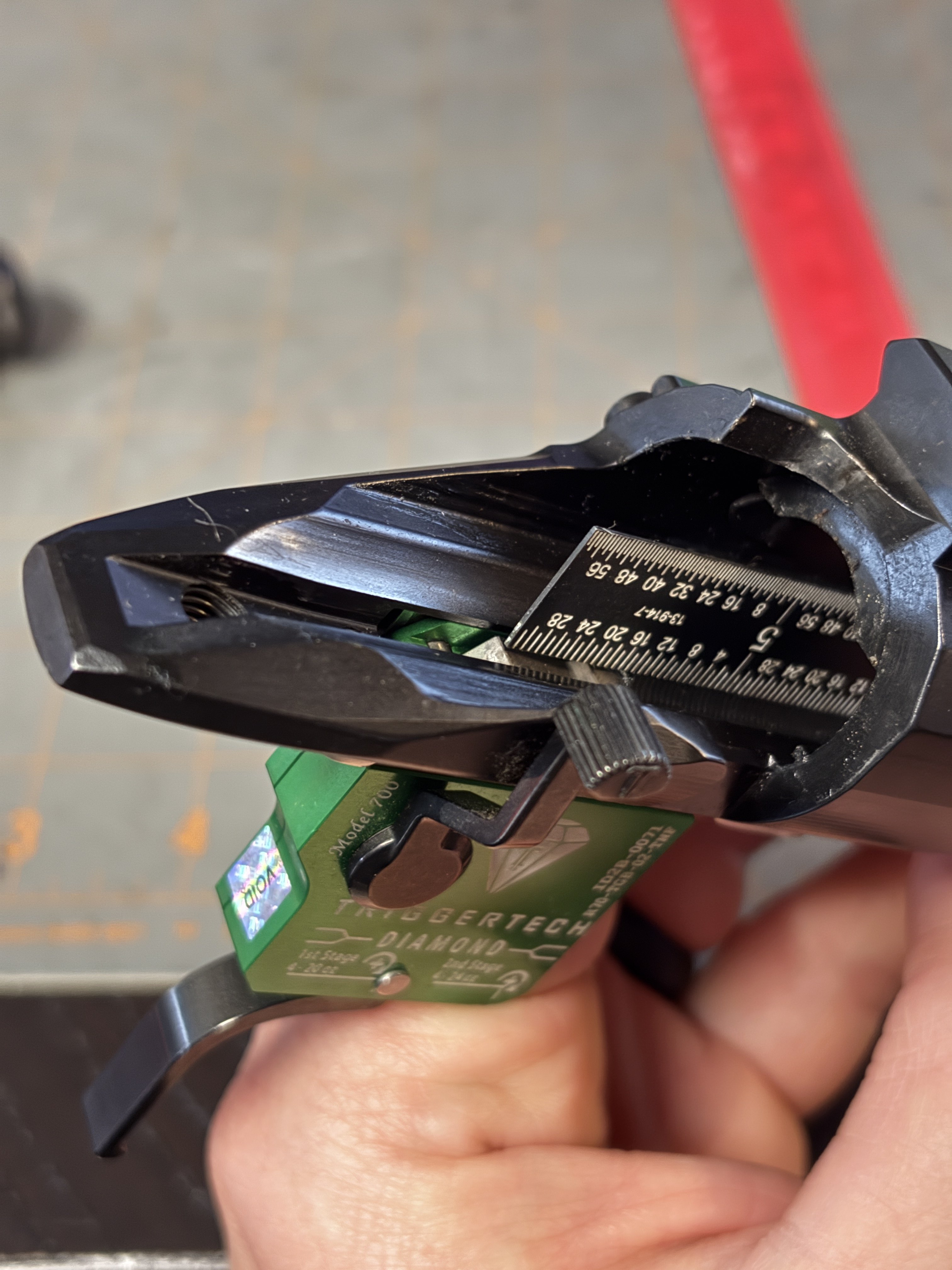

Had this issue a few years ago with a TT 2 stage, not identical, but very similar.
My issue was to do with the size of the cocking piece as it slides over the top of the trigger sear bar. The bottom of my (PT&G) locking piece was claimed to be oversize and too wide, and it was very lightly rubbing on the green alloy, creating a burr.

I can't replicate your symptom on either of mine. Just to confirm - you have the same issue with two different triggers? Is the hanger installed properly? Clean mating surfaces? Ghetto caliper measurement shows ~0.136” from the bottom of the flat rails to the top of the sear, maybe ~0.015-0.020” below the bottom of the action for your reference. If yours is substantially lower, I’d suspect a hanger or install issue.

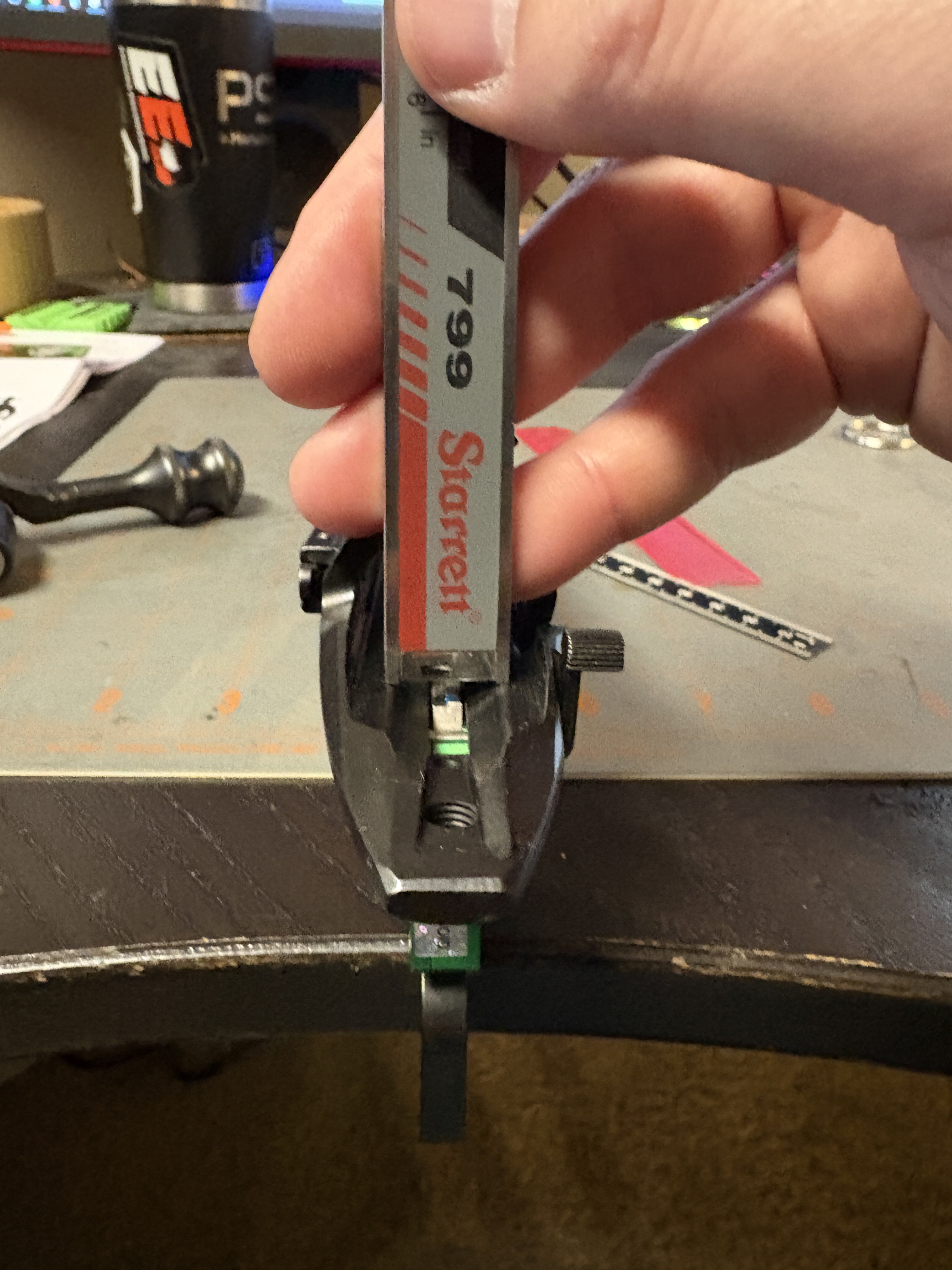

Trigger hanger is installed correct yes. I was actually able to replicate the issue on all 3 of mine. One of them I only use for hunting, so it has a extremely low round count and this had never happened to it, until now, when i learned running the bolt like that can cause it. The other 2 are target rifles. One of which seems to have this issue much more then the rest. On the new one that i tossed a 25x47 barrel on it was happening probably 4/10 times, so alarmingly enough to where my buddy was like where TF did that round even go because it surprised me so much. However, my other 2 are not nearly enough, and almost seem like you have to get pretty rough with it to replicate the issue, but it is still there. I was thinking a sear engagement issue which is kind of why i was thinking to try a BnA trigger.
I will measure mine once i get home. Thank you for measuring yours to compare.
TT said they would warranty it no problem, but i absolutely cant believe i have 3 bad triggers. Still waiting to hear back from Impact whether they have ever seen this issue.
Really Dumb Question; Have you verified you have the correct hanger? It is actually sounding like this action is on the cusp of not working well with the trigger as attached with the same hanger (sometimes and sometimes not). I would call them and ask for a hanger that will provide closer bolt to trigger.
