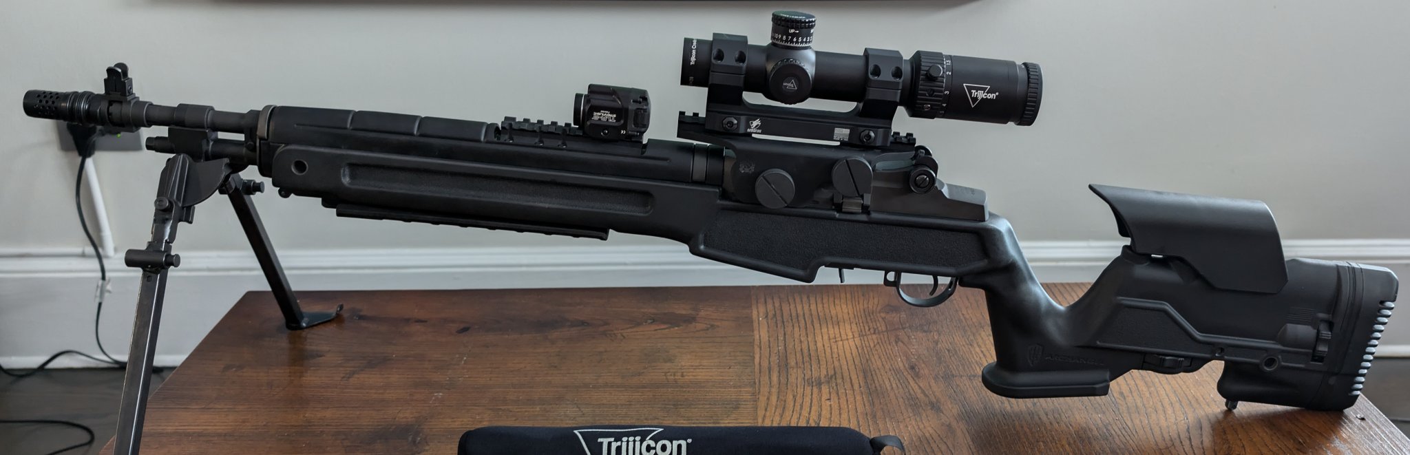

Springfield Armory M1A scout squad (308), Archangel Precision Stock, SA aluminum scope rail, Trijicon Credo HX 1-10x28 mounted with American Defense Delta QD, TLR8 laser/light, DeadAir Xeno muzzle break (Nomad30 not shown).

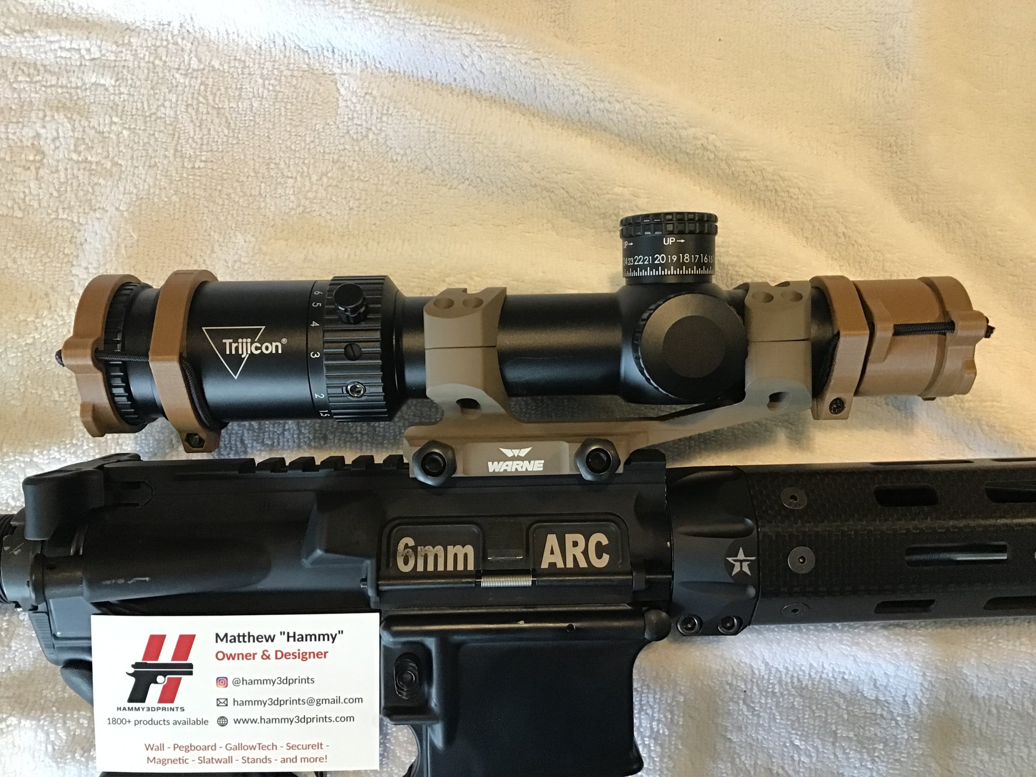

I went with covers from Hammy3dprints. He didn’t have the 1-10 listed, so I sent him the specs. I’m pleased with the covers.
I’d never heard of Hammy3dprints before, just found him on a internet search.
This is his “Earth Brown” color. The Warne mount is their “Dark Earth” color.
