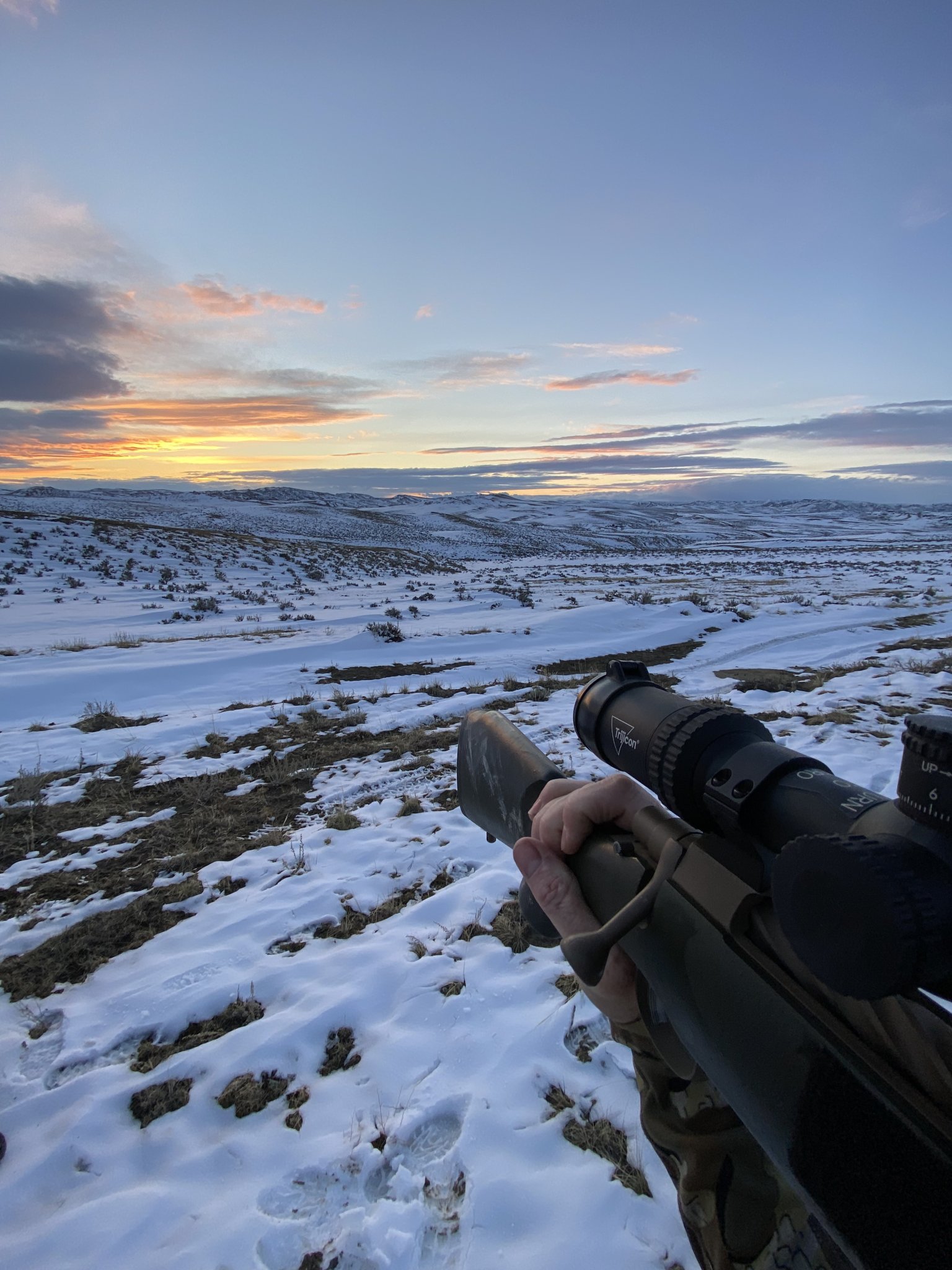

I have several Credo second focal plane scopes, they all have nice glass and useful turrets. Glass is on the warm side of coloration. Still good in flat, low light. My winter/grey season is long and we rarely see sun. I shoot a lot in the evenings around sunset, even on snowy or socked-in days I find the sight picture clear.

I had one for a long time, I had a running review of it on Rokslide. Killed a bunch of animals with it.
It’s a very nice scope, but the Maven RS1.2 is better in every way IMO. Same weight and form factor give or take small differences but a much better reticle and FFP. In fact, for hunting, the Maven FFP reticle is better than the Credo’s SFP, the Credo reticle is ridiculously thin for a SFP.

They are different animals as far as I can tell. Yes made by LOW. Turrets feel much better on the Maven and are 10 MIL vs the Credos 8 MIL, by all accounts the Maven glass is top notch but I haven't had much field time with it yet. I can tell you the Credo was unusable in low light without the illumination on, I made a habit of turning it on about 15 minutes before the end of legal light when hunting.
