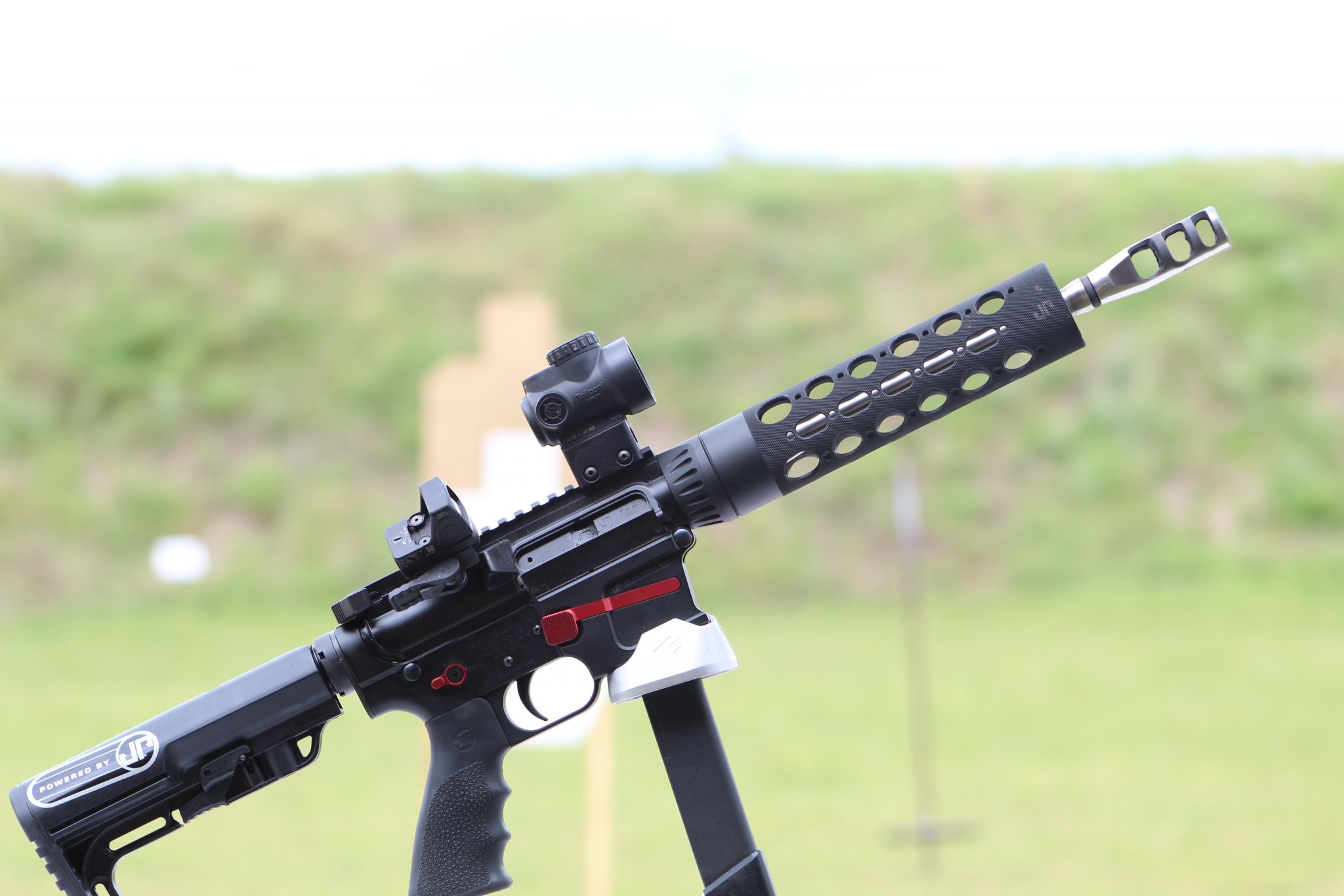

    I have an RMR mounted on an SBR’d S&W 15-22. I used the RMR to keep it as light as possible. I find the FOV to be similar to an aimpoint, but prefer an EO Tech if weight isn’t a concern.
    I used one for PCC in USPSA. Every other RDS that I own for rifle use is full size. RMRs aren't as sturdy as the full size and really aren't meant for hard carbine use unless it's a range gun that doesn't see hard use. (I've broken two type 2 RMRs and a L DPP on various carbine/vehicle courses)
    However on a handgun where it's designed to be, it really shines. I personally switched to DPP for all my handguns.
