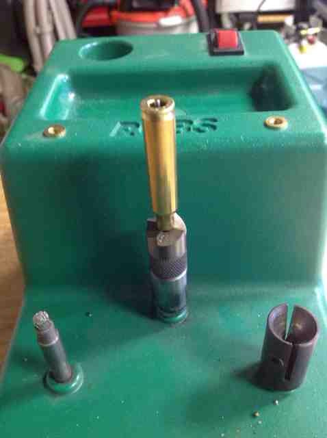

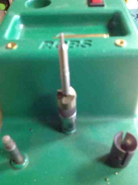

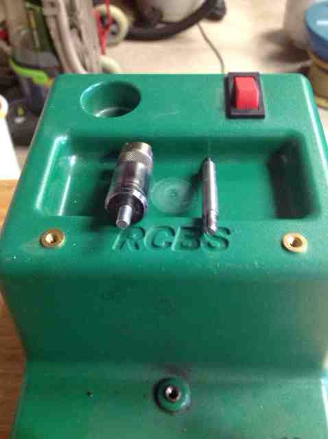

Here is a mod I did with my lee trimmer.
Makes for a fast trim, without the drill and the spinning vise grips of death.
Just make sure you drill and tap in the center with a 8/32 tap.
