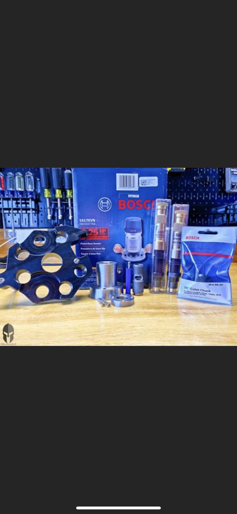

Dillon didn't have one back then but they do now and I use this...
Im not in my reloading room anymore but its the Dillon RT1500 (not the RT1200 that had less power)
While I don't have a video of me converting LC 5.56 to 300blk but I do have a video sizing/trimming 6.5cm... this is exactly how my LC 5.56 to 300blk works. Just pull the handle. Stupid fast
