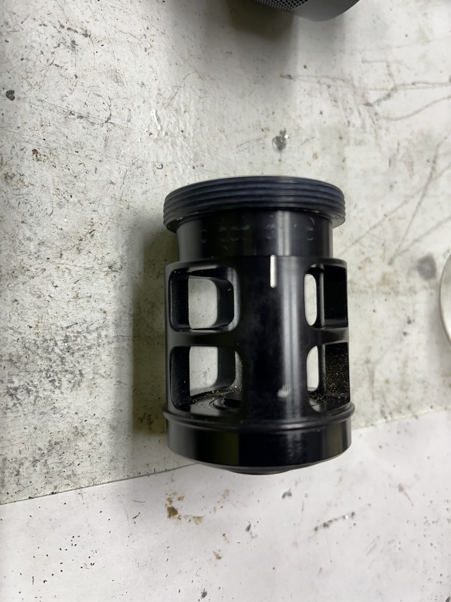

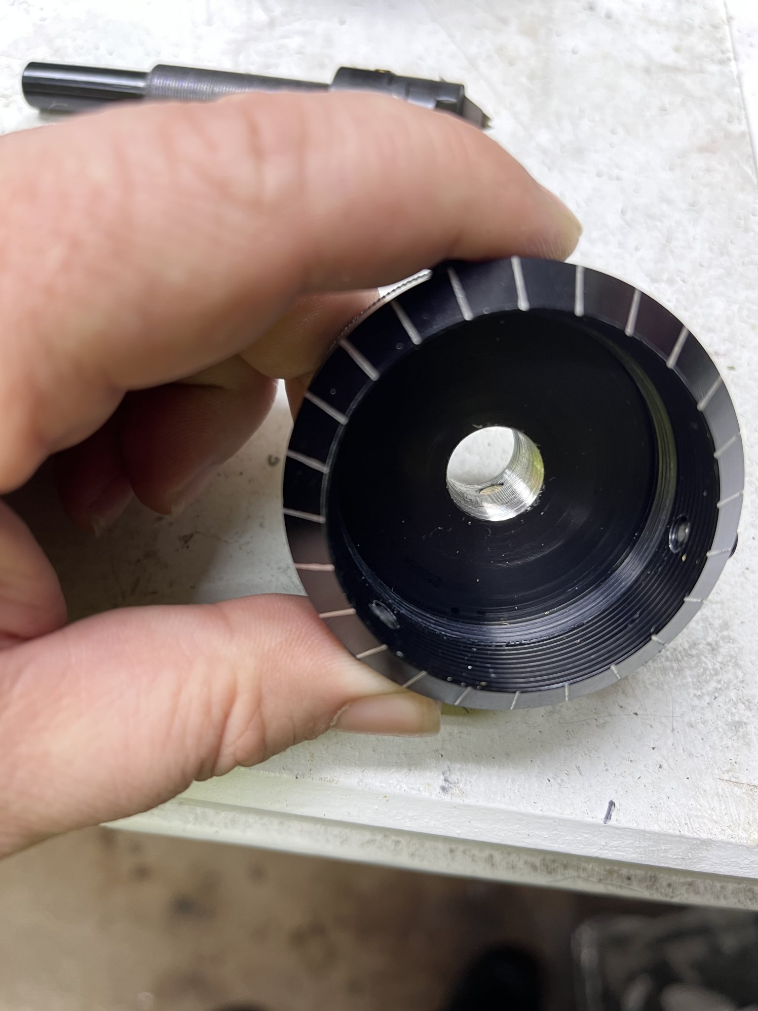

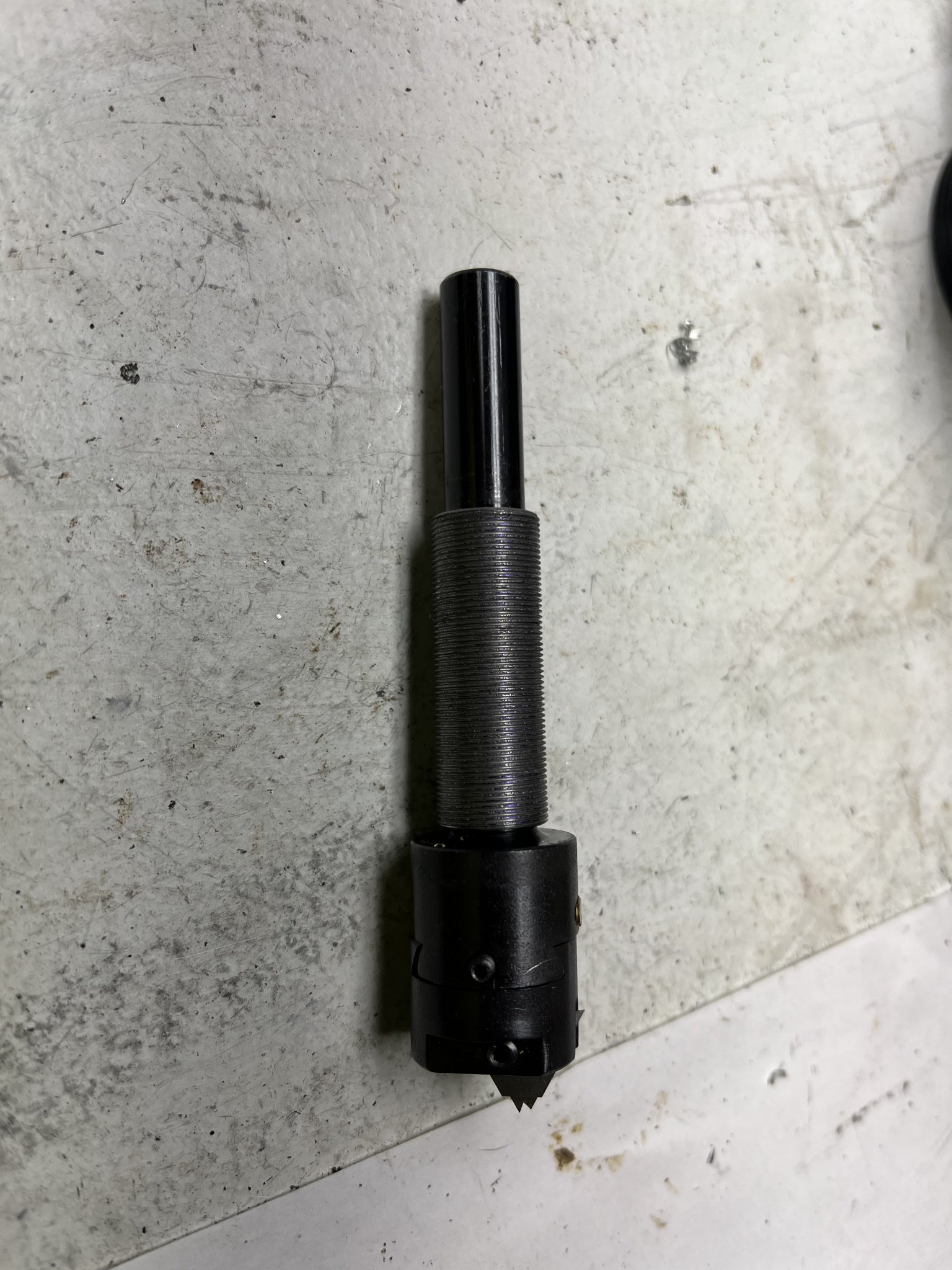

I have a Trim-it 2 and while the concept is great, the execution is poor. The adjustment screw to align the cutter has way too much slop. I have a lathe, so I made a new screw to eliminate the slop. That was when I discovered the collar adjustment setup was crap, even if the tolerances were OK, mine were not, it still was crap and the body would cock, ruining the alignment of the cutter with the case mouth. So I made a sleeve from some half inch round stock and threaded it with 40 tpi threads. I used the original set screw with a brass chip in the hole to protect the threads. then I drilled and tapped the base plate to match. The sleeve I attached with loctite. Now it is easy to adjust because it’s not wobbling around it four directions. I went through all this because I have a lathe and I didn’t want to spend hundreds of dollars on a new solution.
I would recommend the Giraud if you only have one caliber to do, the one you put in a drill. If you have a bunch of calibers and money is no object then the Henderson is the way to go. If anyone is interested I can post photos of what I did to my Trim-it 2.

I agree it is very adjustable, but there are QC/tolerance issues as well as a design flaw. The loose tolerance on the screw to adjust the cutter to the case mouth was an easy fix, but that just highlighted that the real problem was with both the design of the barrel base interface as well as too loose tolerances On the threads and the barrel to base. So I locked that down and made the adjustmen in the shaft with the threaded sleeve. see the attached photos.
I looked to see if there is an inexpensive way to dupl what I did without a lathe. It will take $120 for tap and die in 1/2”-40, but if you drop to 20 tpi, you could buy a 2” bolt in 1/2”-20 and cut and drill it to make the sleeve. You will still need the tap, but that size can be had for less than $20. The screw for cutter side to side is another story as I had to custom fit it to mine. But like I said, the barrel adjustment is the biggest issue.
