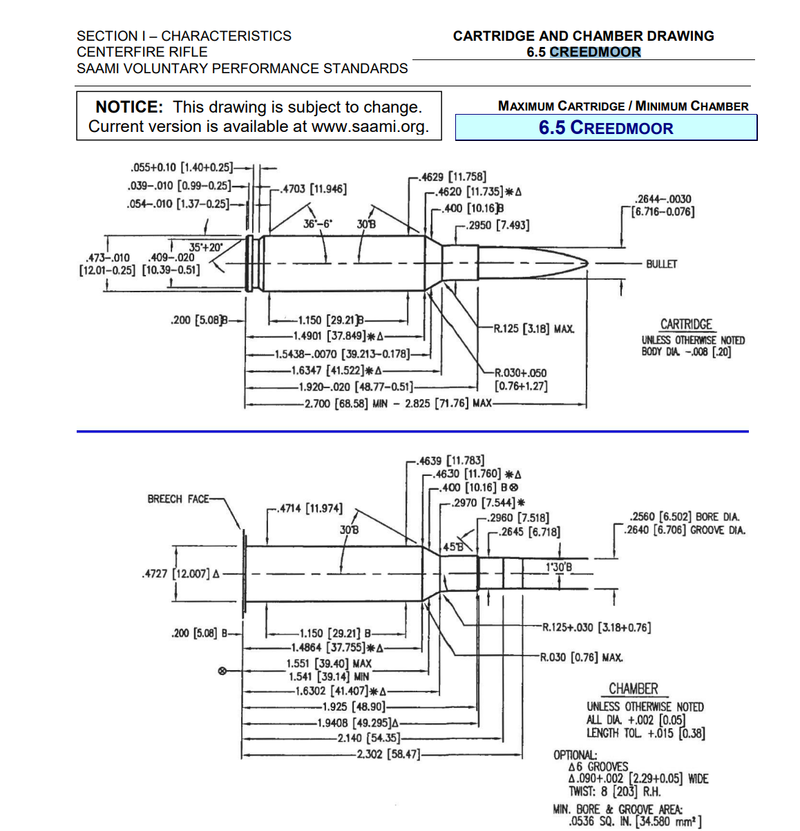

Maximum case length 1.920"
Minimum case length is 1.900",
you are 0.007" above minimum.

1.905" will be fine but it's not likely that the performance will match the ones you've trimmed to 1.910". It's possible but not probable. There's too many variables involved.
The manual only lists 1.910" as the case trim to length because it's using the general rule of 0.010" below max spec. For 6.5 Creedmoor, as a standardized SAAMI has a max length of 1.920" and min of 1.900" (refer to picture posted). As long as you don't go below min or above max, it should function and be safe. Basically stay between 1.900" and 1.920"

.....your trim length of 1.907" is within the min-max range per SAAMI, 1.900 (min) and 1.920 (max), it will be fine/safe. If your desire is for consistency, trim your brass to the same measurement, just settle on a length between those min-max numbers shown in the SAAMI drawing above.
