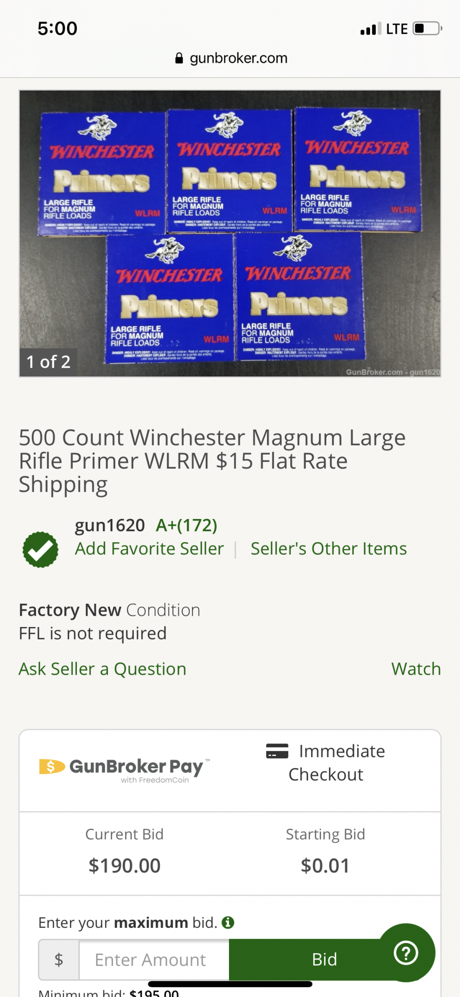

Thought about tracking down a replacement cutting head for the Lyman, but didn't due to availability of anything for reloading. The Hornady requires their own shell holder, so I checked my local stores to no avail. Went online,nothing except for one on ebay, wait for it... $69! I drilled the hole in an extra rcbs holder a little larger and it works great. If someone would have told me a Hornady number 1 shell holder would go for $69... Holy shit!
Yep crazy times!!!! I almost had a heart attack searching gunbroker. Lol.
