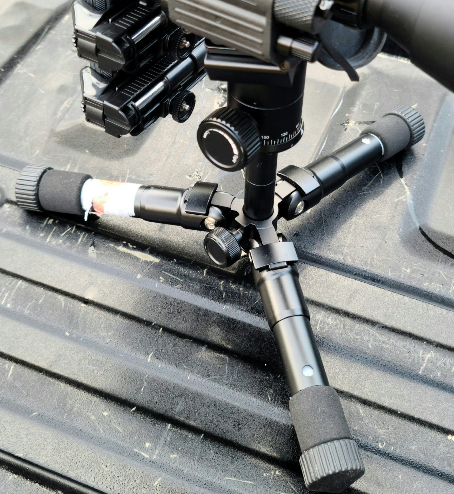

i strongly considered both a fluid head (suggested by doug) and a geared head (suggested by many), but balked at the price of the heads.
being a poor, i found a compromise by using the anvil 30 as the primary tool, and i added a cheap Orion "precision slow motion adapter" for more precise aiming. It isn't particularly fine, so not as precise as a real gear head, but might actually be more useful because it isn't so dang slow.
i put my rangefinder on it for scanning targets as i felt it would be more useful for that, but i can put the spotter on it, or use it to aim the RF at the same point as the spotting scope.

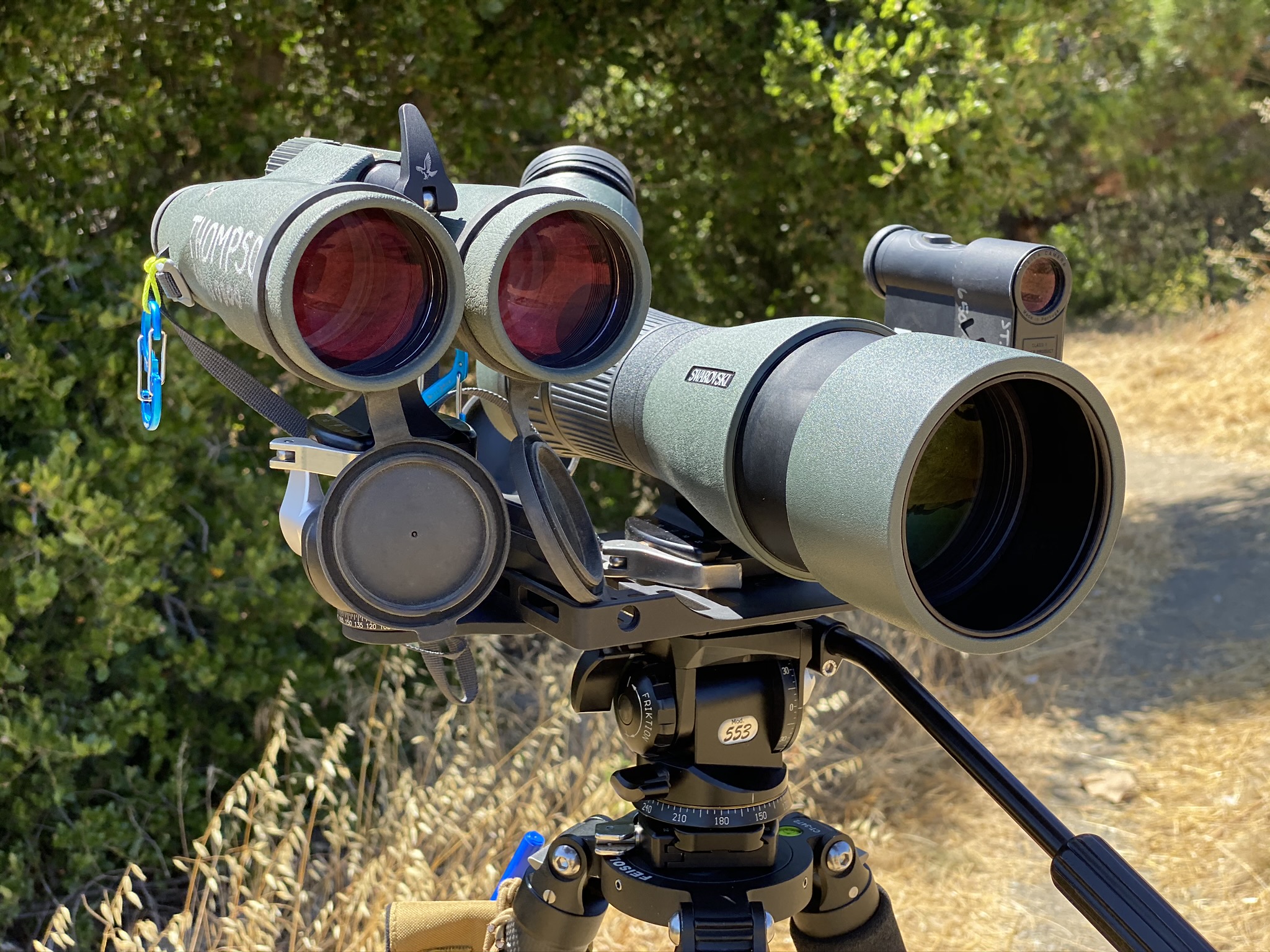

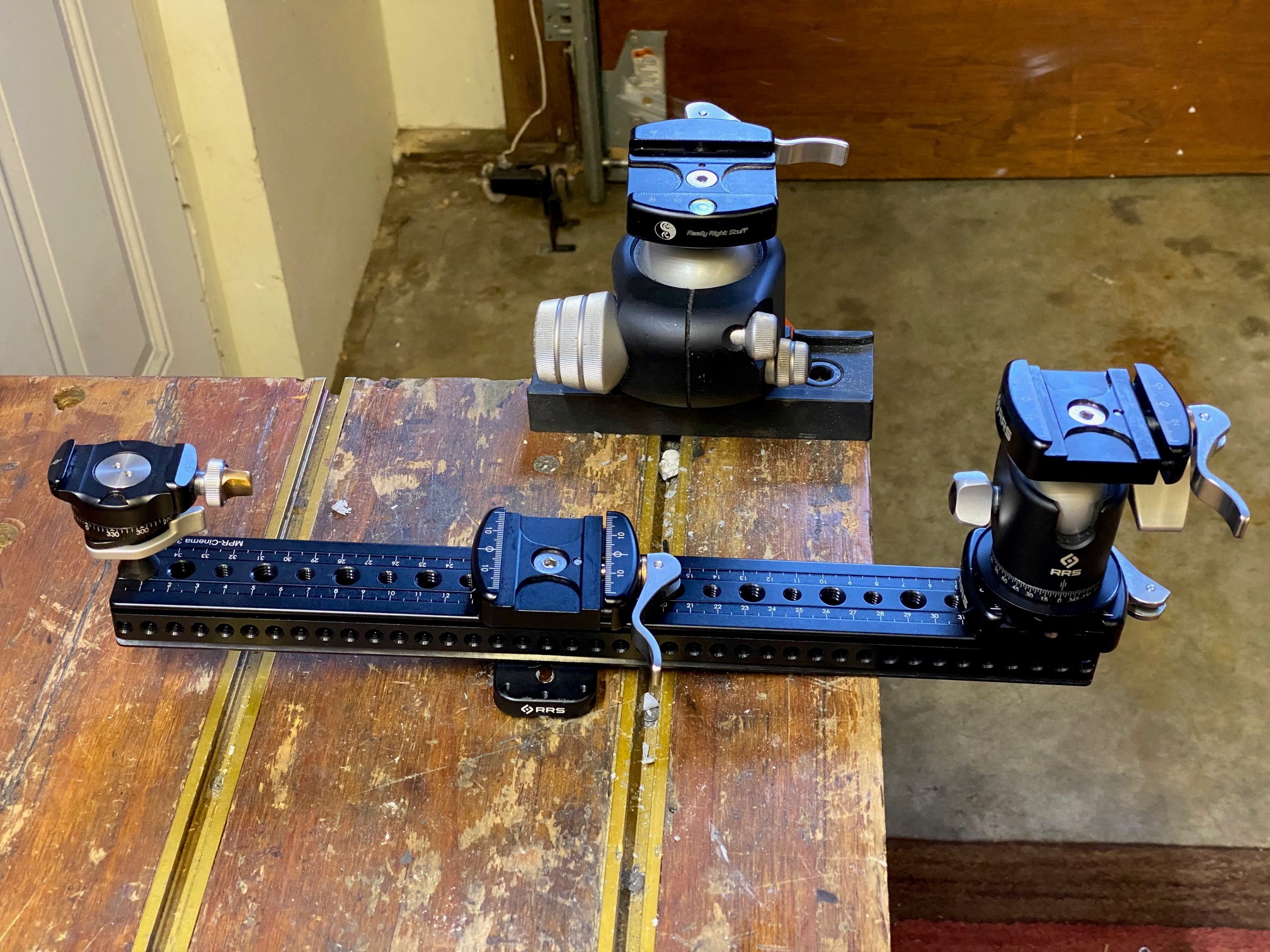

This simple set up similar to theLBC lets you co-witness, spotter binos and PLRF. Honestly, though, I will use the Bino's and spotter together for truck spotting along BLM or Forest roads, but never really all three as the distances are too far anyway. Usually, I scan with the binos and if someone sees something, use the binos to find the area fast then drill down with the spotter. You'd be surprised how many animals end up being parts of stumps, deadfall or a bolder once on the Swaro ATX spotter. LOL
The binos go on the right to bring them up to the same level as the spotter. The little RRS micro head on the left has constrained pan and super light for the PLRF. Once I I lock the spotter in the center, it is fast and easy to spin the others onto the same target. From that point on I can just move the main Pan Tilt 553 while on the Binos and the spotter follows.
I'll use this setup on the BT-ATLAS stage to score the shots on playing cards but the binos to spot the other distances in our up-coming UKD match.

What is that multi-mount rail thing called? A shorter version, to coaxially mount my laser and spotter would be nice to have.
That is an RRS Cinema Rail. They come from 7" to 17"

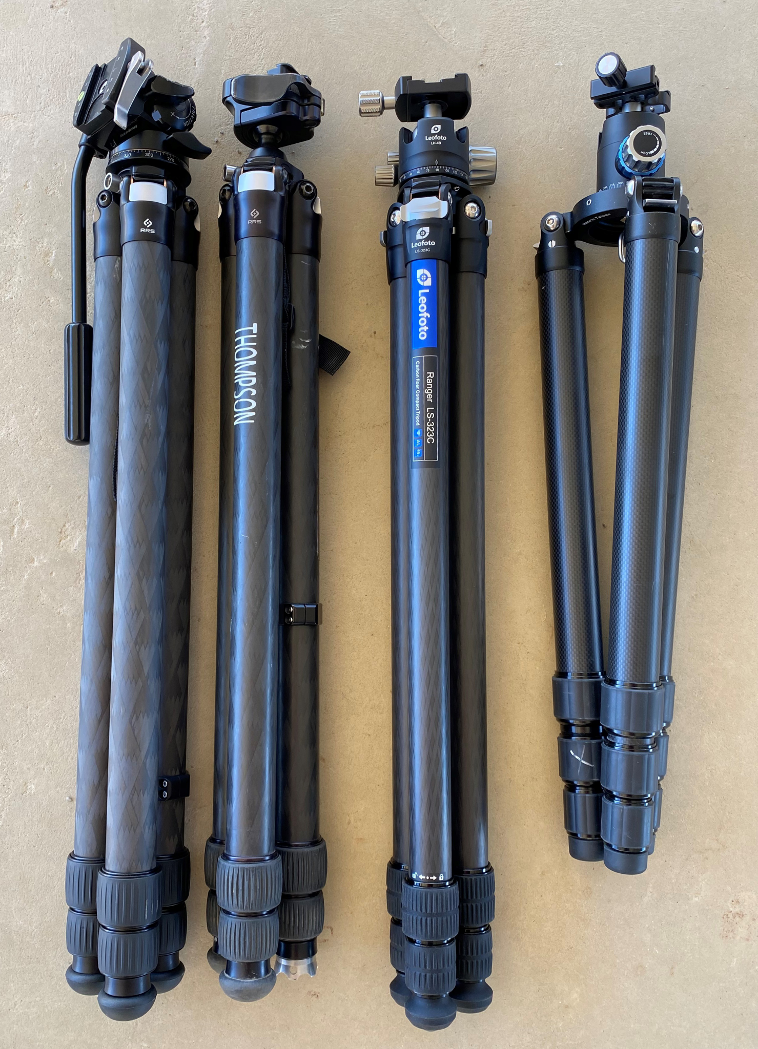

I went out the other day and tested a few cheap heads to mine on the left. I have some other tripods not shown, one 3372 with RRS leveling base as well as the RRS BH-55.
1. Left is the 553 pan/tilt head, ideal for grid glassing. It supports way more weight locked solid than listed but the dampening and sping assist are set to work best within it's load range. Personally, I don't use that feature even when I have two really heavy optics to top like the SWARO ATX and Swaro 15x-56 . It easily lock solidly my carbon barreled hunting gun. It is still much lighter than my RRS BH-55 ballhead
2. is the classic Anvil setup.. hard to beat the stability in a light small robust package
3. Super cheap knock off. It sized closer to the 2 series of RRS and a bit steeper leg angles so it's a little less sure-footed and a bunch more shakey.
4. Fesiol 3472 ( I also have the 3372 3 leg version) , personally just like some guys are buying the PRS 2 leg RRS for speed, any 4 leg is just the opposite. I prefer the balance the 3 leg tripods provide, especially when out in the hills. This setup is still a bit more stable than the Leofoto

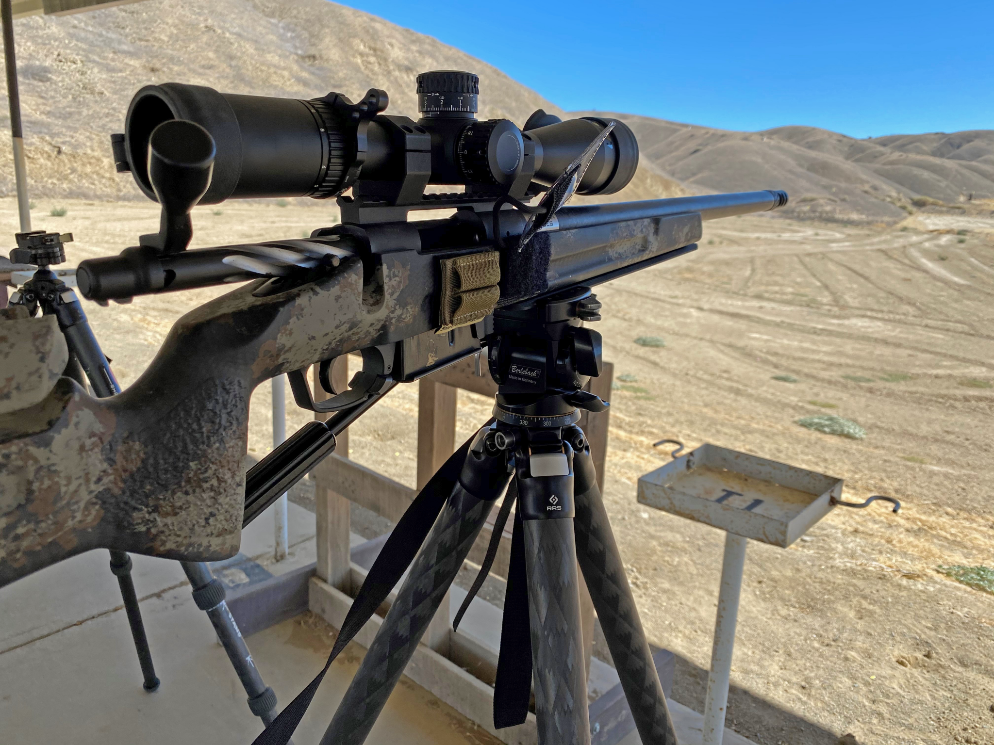

Have a 553 pan tilt in the photo I posted with the ATX and Swaro 15x56 in post number 7 - but here it is shooting from as well.
