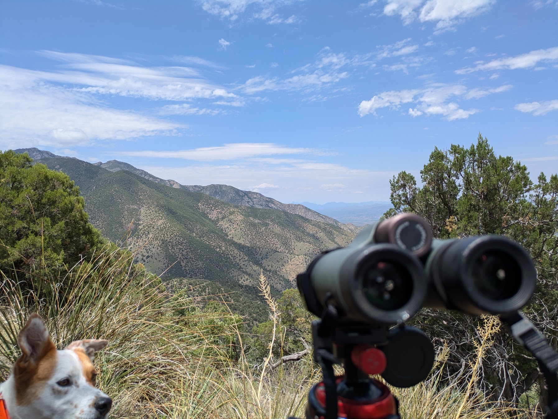

Lately my tripod has been used a lot in steep and uneven terrain, to allow me to glass/shoot from a sitting position.
Terrain like this (sorry didn't get a picture of the actual tripod position):
