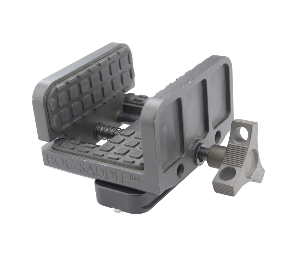

Set on a hog saddle. Will be using a variety of guns on this including coyote hunting guns, deer hunting slug guns, and precision rifles.
I am going hog saddle because not all guns will have Arca/picatinny options on them.
My question is what tripod and ball head should go under the hog saddle or should I just direct mount the hog saddle to the tripod? I want lightweight and as stable as possible.

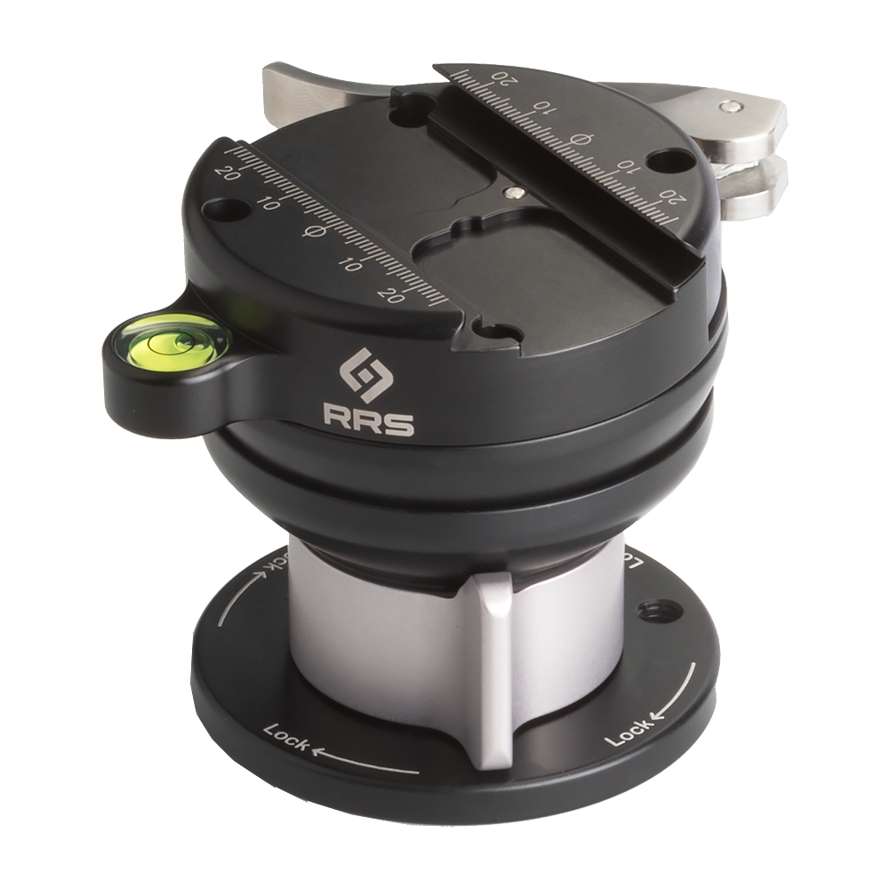

A leveling base is going to have a bigger ball than a typical ball head but it might step you up in to a heavier tripod than you want.
If weight is an issue, direct mount is lightest.
I would say leveling base if 15 degrees up and down (total 30) is enough, I think it is for most. If so then go leveling base as it is slightly more stable, lower profile and makes you’re tirpod more compact.
Really right stuff (RRS) is the best IMO. If you just cannot/will not afford RRS then IMO LeoFoto or Fiesol are great options.
I would say narrow your budget and specific products can be recommended.
If you are trying to stay budget friendly we have our TA-U-LC which can go on most all tripods, and a VR-76 rail that we built for the bottom of our VYCE, but will work for the hog saddle.

Thanks everybody for the advice. I think I’m gonna go with the new patriot valley tripod and the RRS series 3 leveling base under the hog saddle.
You guys think that will be a good effective lightweight setup?
I think youll like the leveling base. You will need a plate underneath the Hog saddle so the lock knob does not hit our quick release. You can find other plates out there , but like I mentioned before, the VR-76 is the one we made specifically for that reason.

Michael, wouldn’t the TA-3 leleving base be a better option for height and stability for him? The PVA tripod is 75mm
http://soar.reallyrightstuff.com/VR-76
Well fuck, didn't know about that lol. I milled a piece of steel to shim my hog saddle up to clear the leveling head. I was going to make an aluminum one since the steel was just what I had laying around but I might just have to buy this.

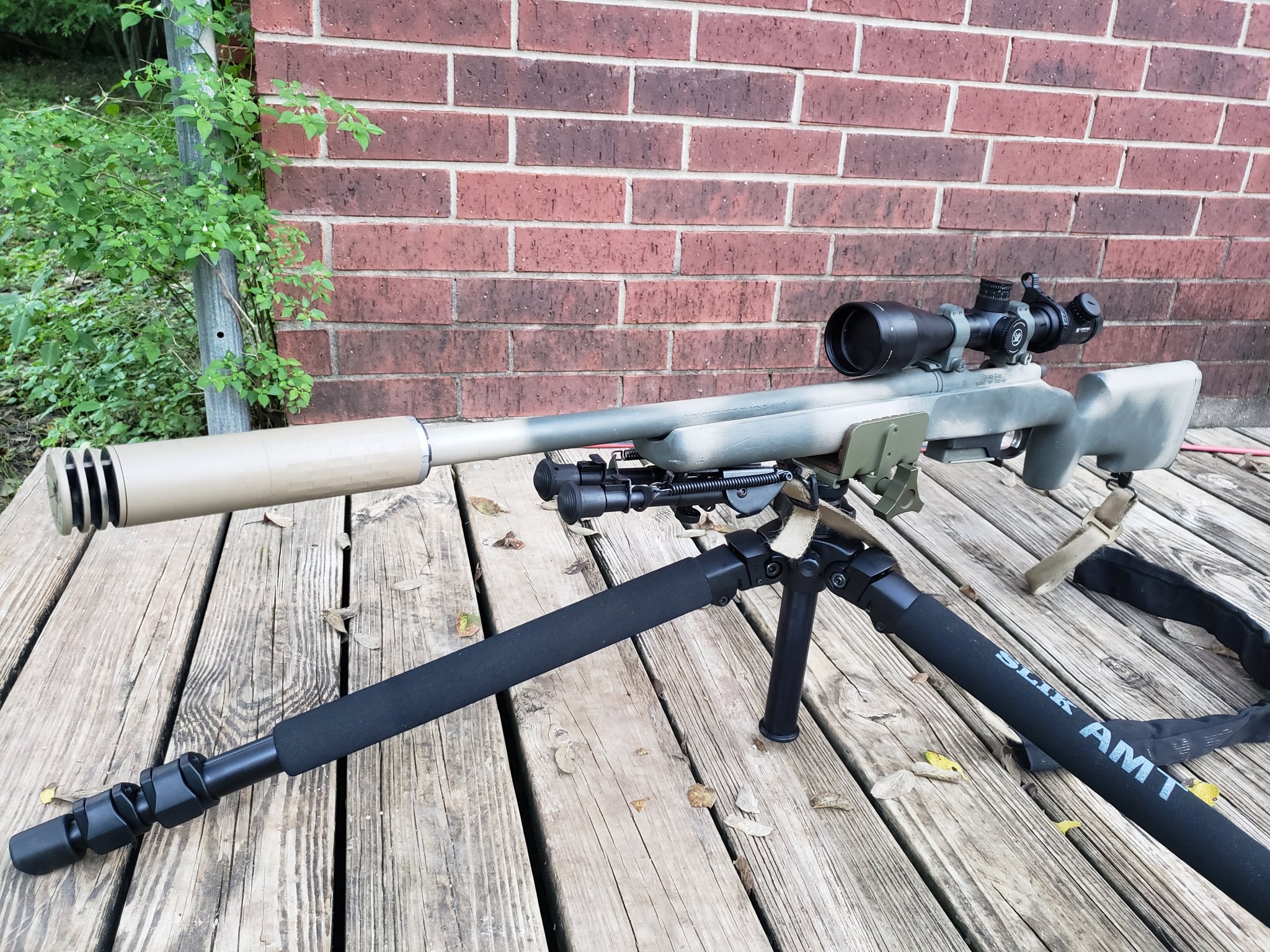

Can't go wrong with RRS if you have the wallet for it. I went with a Feisol CT-3372. Not the lightest option, at a shade under 4 lbs, but it's sturdy with a load capacity of 66 lbs. Load capacity is one factor of overall stability. I haven't tried the 3442, but it's lighter, less expensive, and stil has a 55 lb. load capacity.

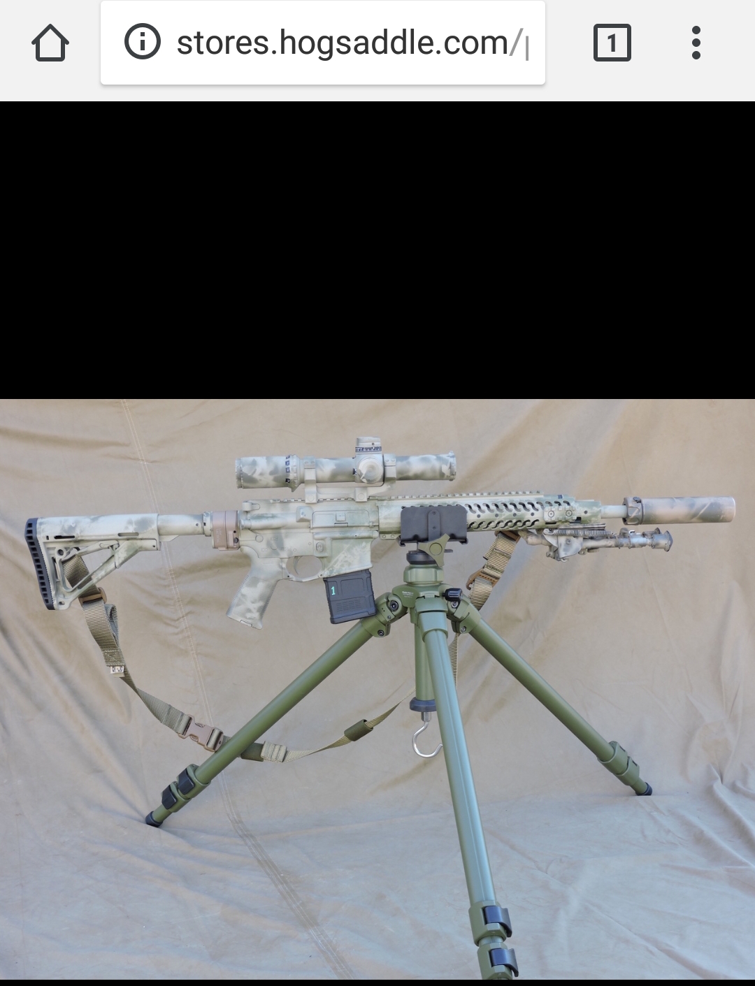

So, to be clear, I am running this head: http://stores.hogsaddle.com/gnn-fb-52-ball-head/
And, this http://stores.hogsaddle.com/marc-qd-plate
With this tripod: http://stores.hogsaddle.com/pig0311-g-field-tripod-od-green/
And, a Pig Saddle.
Same rig as Feds.
More info in this thread: https://www.snipershide.com/shooting/threads/tripod-setup-for-actual-leo-sniper-use.6900149/
See @AMTeam4 comments in the tread reference above for better clarification.
Hope this helps. Very steady and great rig, in my view. JAE or MPA chassis sitting in mine.
I have not played with the Pig tripod but in my experience there is no way that you can compare the stability of a center column with a ball head and a pig saddle all stacked on top of each other to a tripod with a leveling, or RRS Anvil, mounted directly to the tripod directly mounted via Arca rail to the gun. Not even close. Just my opinion.
Just for the record, I’ve got a pig tripod and wasn’t too thrilled about the stability of the center column either... also not crazy about the added complexity (column kept on spinning when I tried to adjust the leveling base.) I just removed it. You can sandwich a fender washer in and fashion yourself a 3/8-16 mounting stud. If you’re a little bit creative you can remove that center column.

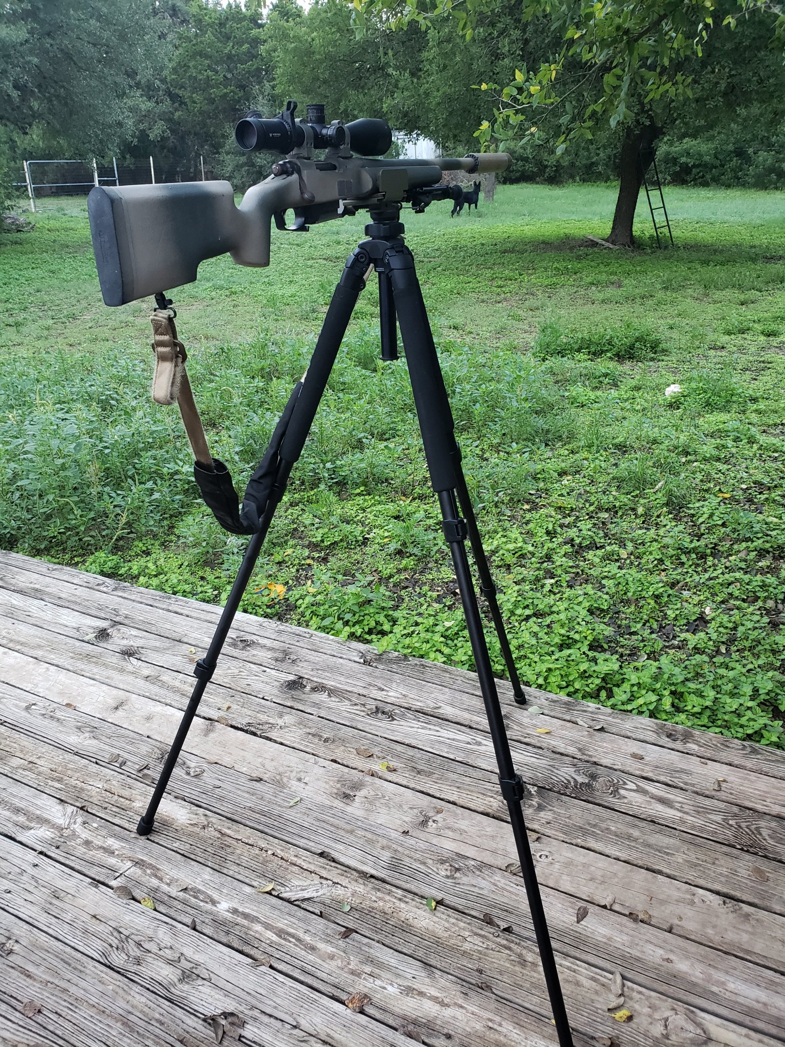

I went semi cheap to get the same(ish) result OP is going for.
Pig saddle I got from a fellow member, and a slik pro 700 DX (legs only) from amazon. Direct mounted. I cheaped out on the extra $40 for the pig 0311. I plan on building another setup in the spring so my hunting partner or other guest can use one.
Its solid, smooth, and very adjustable from the messing around with it I have done. I'll field it this week on some yotes or hogs.

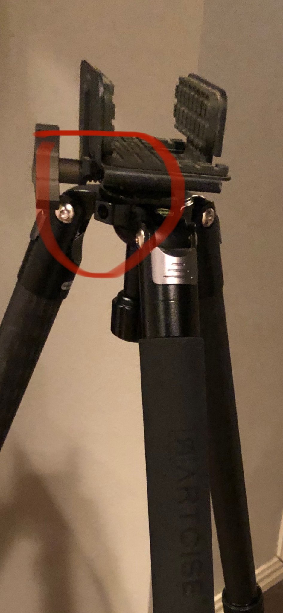

Interesting thread, Ive just bought a hog saddle (finally). Isn’t planned to mount it to a 90mm leveling base but that didn’t work out because the saddle jaws won’t open.
My first thought was to put a shim under its main body to raise it slightly (like some tin). It’s currently mounted on a 66mm base which still allows it to open and close.
Any thoughts?
I have a HOG saddle and a leveling head. Not pleased with it. Very hard to manipulate the lever on the head with the saddle on there. Looking at some other alternatives.
